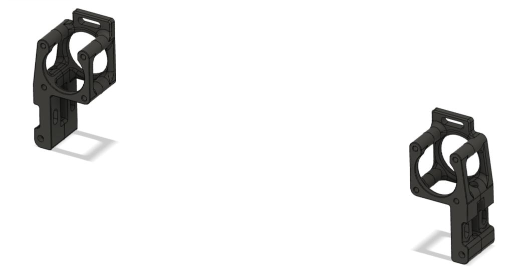

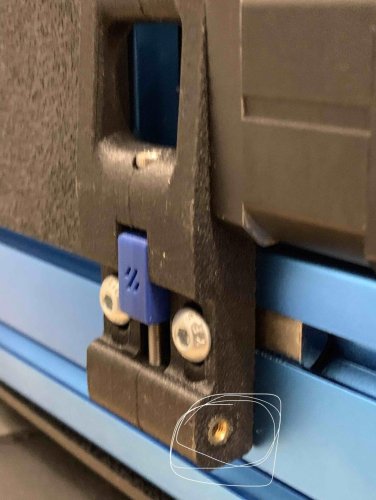

This mod was created because the original stock parts didn't work well for me. The major part are the moded stepper cages. The stepper cages got tilted usually during tensioning and leading to the axle of the stepper not being parallel with the horizontal plane, which lead to yawning of the belt and increased wear and tear of the belt. Additionaly, the cages parts a and b had the tendency to open up in the bottom, especially when the tensioning screw is one or two mm too long.
The modded version has a through-screw in the bottom and additional screw slot on the top to attach it to the vertical extrusion, to help with proper leveling of the stepper axle. You'd probably be able to address these issues without if you were careful and knew about them. Using this design is just much faster. Stepper cages

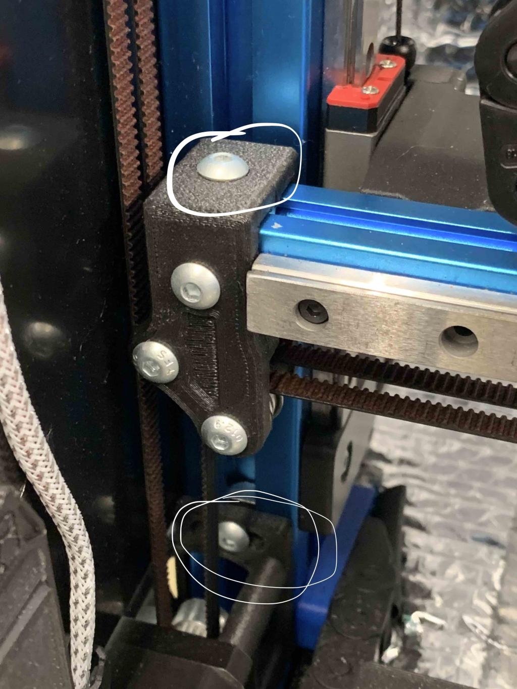

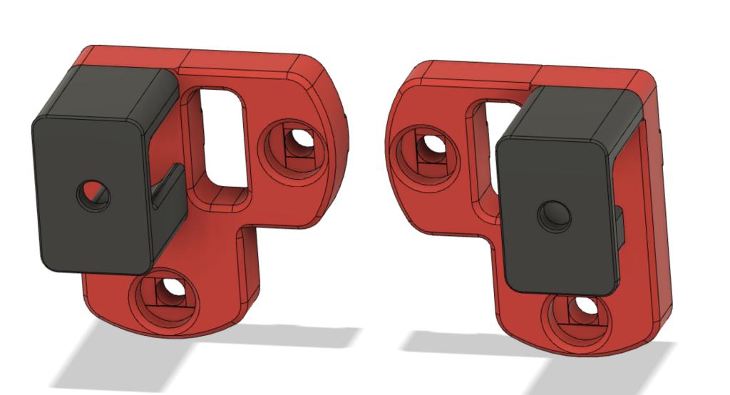

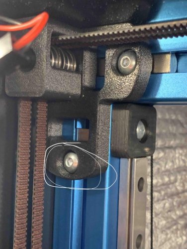

The xz blocks have a slot for M5 button head screw that can be used to fix tilting of the blocks w.r.t. the plane defined by the X gantry extrusion. The original blocks have already some measures to prevent this, but apparently those were not sufficient in my case (I was worried about tightening the screws too much, as the plastic already started to give and yet there was still a bit of tilting play). XZ Blocks
The upper xz blocks/supports were modded just to help more carefuly define in what position and orientation the blocks should stay. These have the least effect, IMO. Upper XZ blocks
