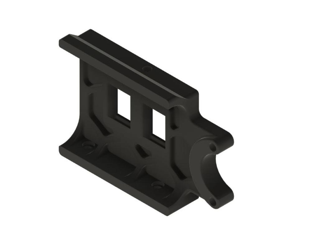

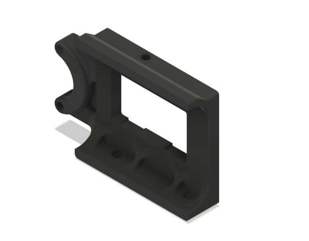

V2.4 Rear Skirt Mod for Z-Drive Motor Tensioner Mod
Credit for the Mod goes to Edward Yeeks for the orginal design and Skohls for updating the mod for the R2 changes. https://github.com/VoronDesign/VoronUsers/tree/master/orphaned_mods/printer_mods/edwardyeeks/V2.4_z_drive_motor_tensioner_mod
This mod enables the you to utilize the rear skirts, power and keystone, in your V2.4R2 while still being able to use the Motor Tensioner Mod. NOTE: heat set insert holes are in a new location so you will have to reposition your bottom panel clips and hinges.
Printing
- Default voron settings
- No supports needed
BOM
Same hardware for mounting skirts for Voron V2.4r2.
