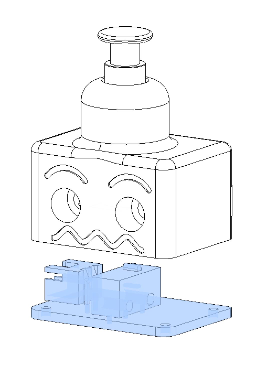

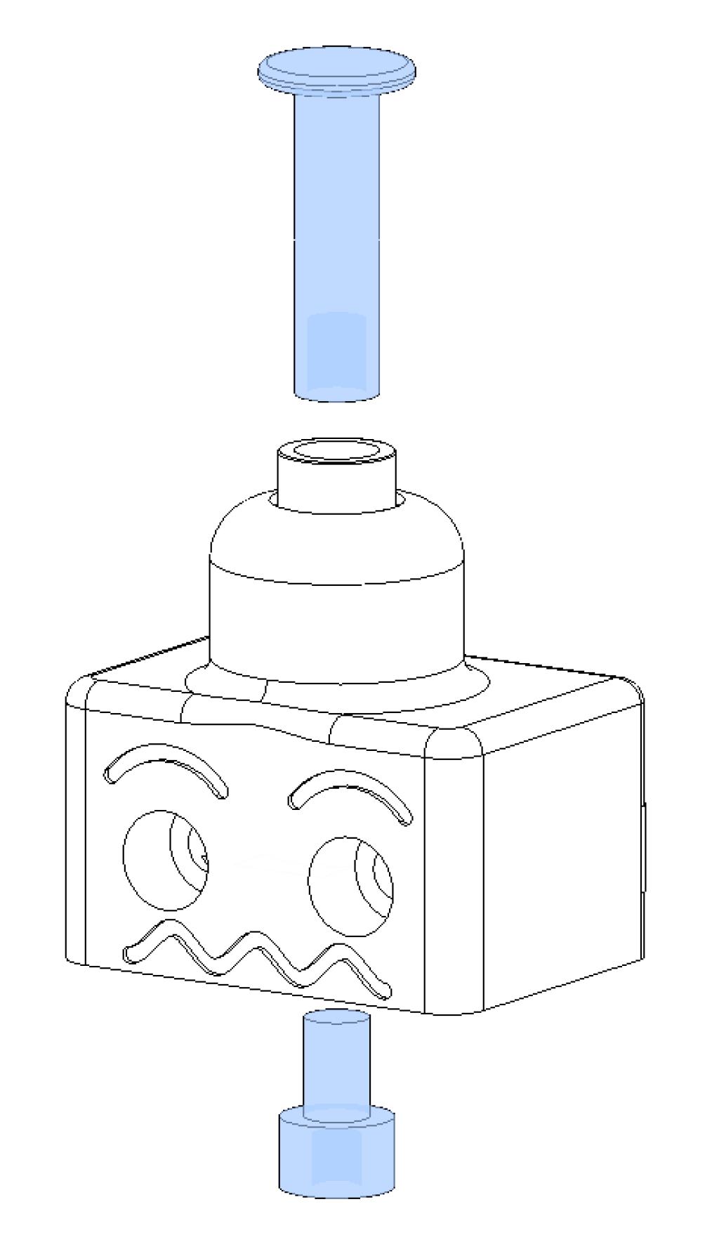

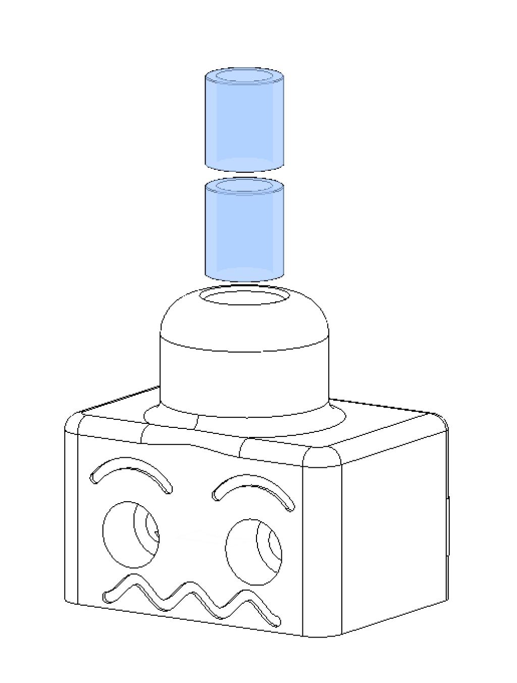

First just insert two of the sleeve bearings into the top, they should bottom out with about 2mm or so poking out the top

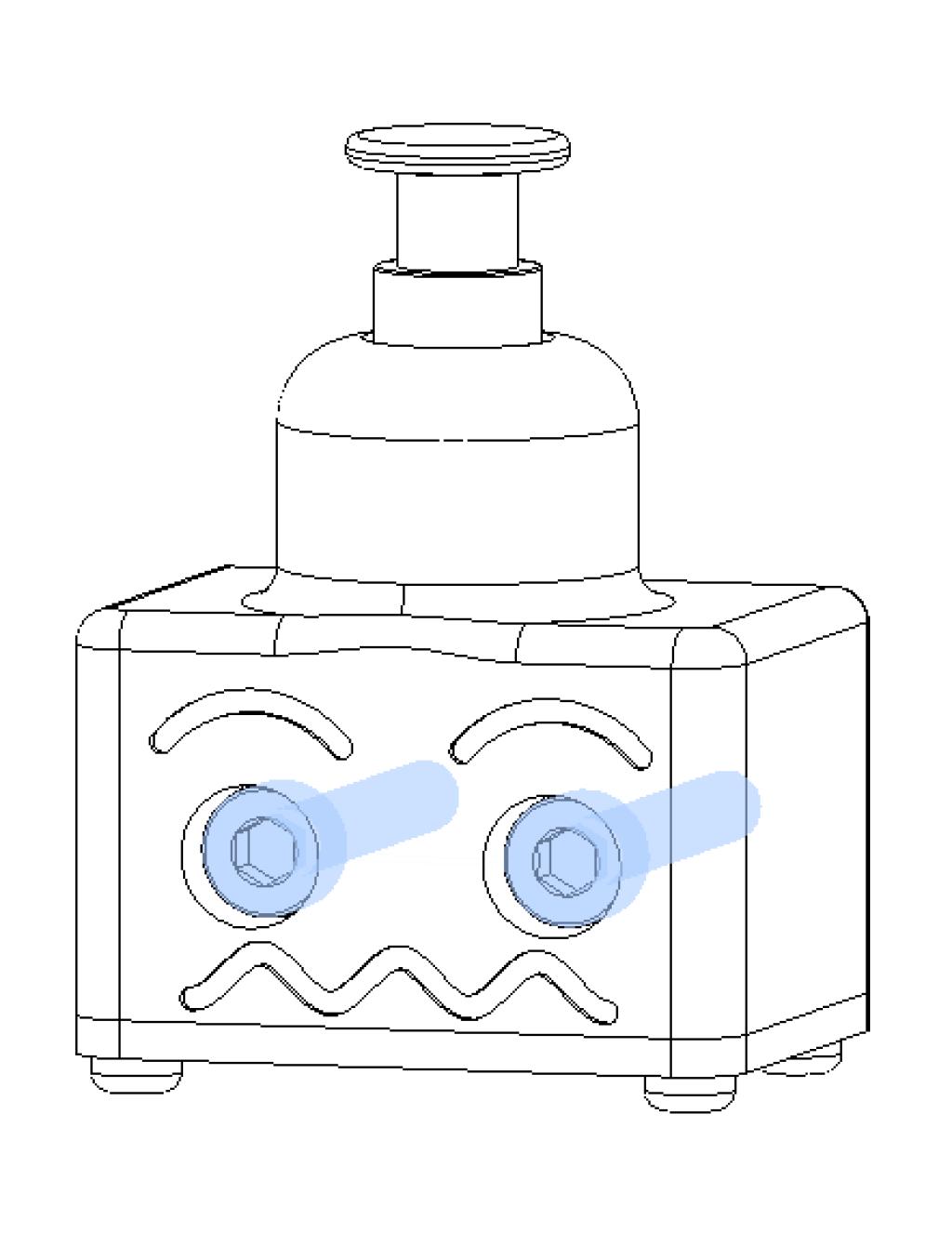

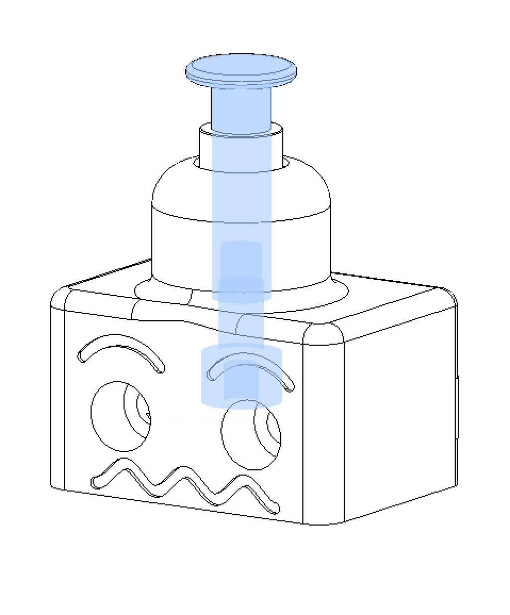

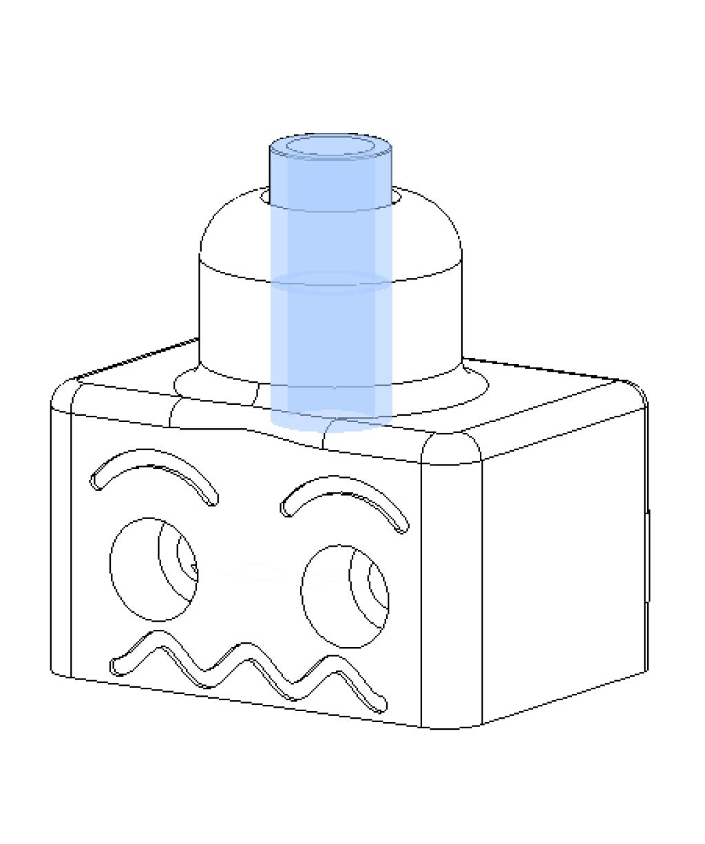

Next insert the female side of a 5mmx20mm chicago screw (sex bolt, binding barrel) and screw in the M4x6 or M4x8 SHCS with some loctite to make sure it doesn't move over time

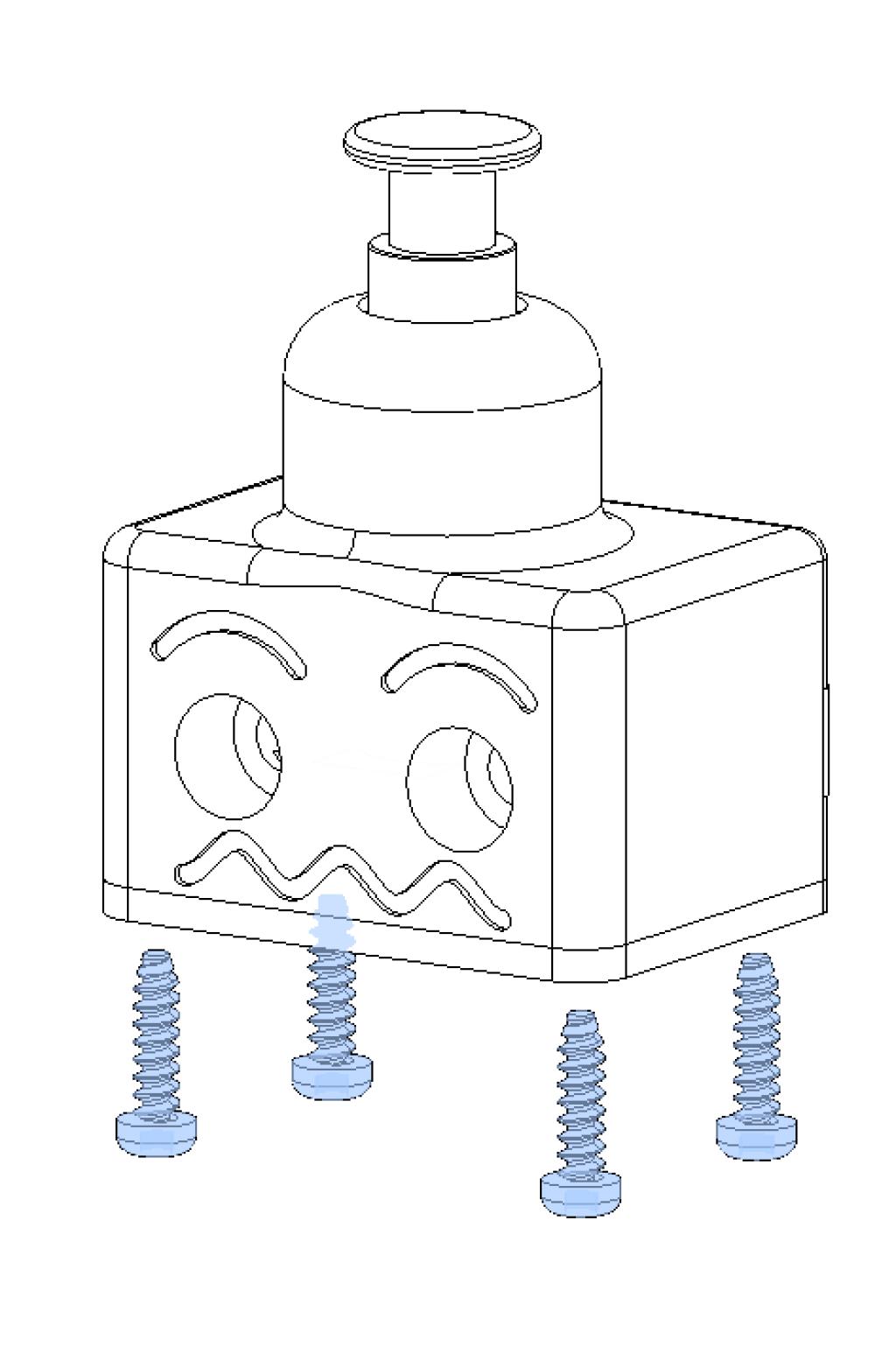

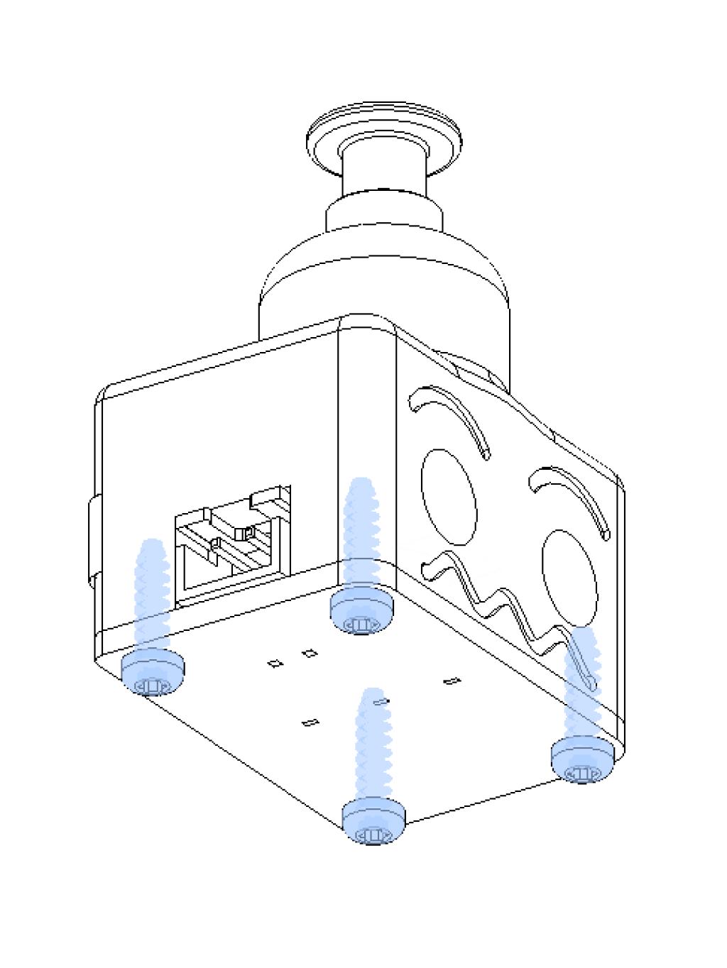

Next insert the Z endstop PCB and secure it with 4 m2x10 self tapping screws
