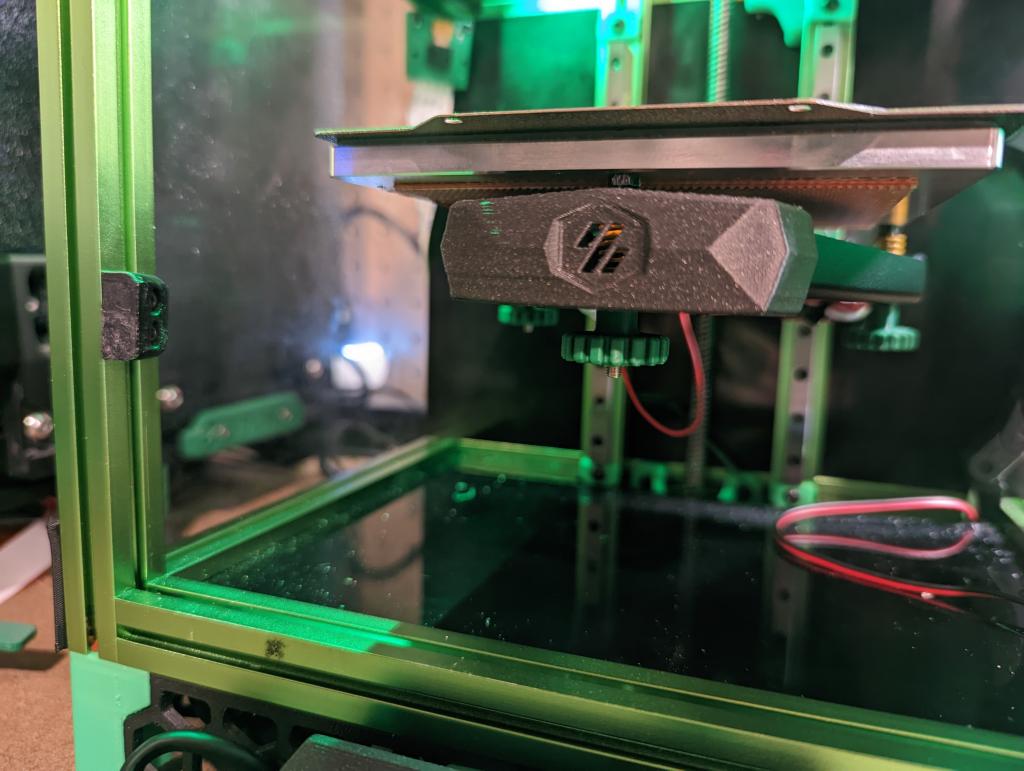

After installing a Kirigami mount for my V0 bed, I found that the stock thumb nuts were too short, which made them very hard to adjust. I have also never been particularly fond of the shape of them and found them uncomfortable to adjust.

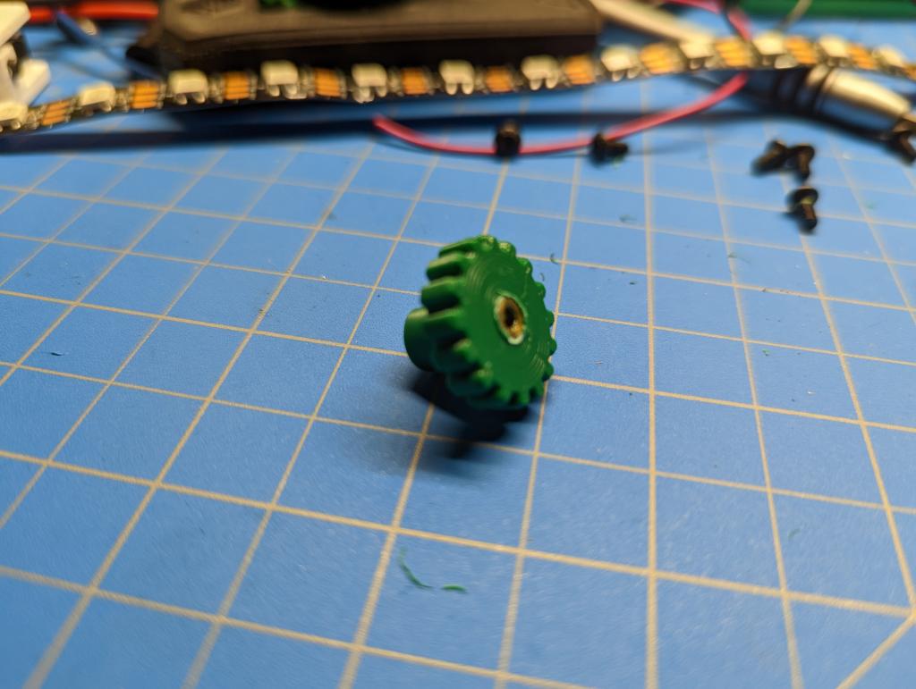

- Print it, the standard Voron settings worked fine for me.
- Install 3mm heat set inserts to the bottom of the thumb nut (so that the tension will pull the heat set insert into the part, not out of it)
- Replace your stock thumb nuts
- Redo your bed leveling
