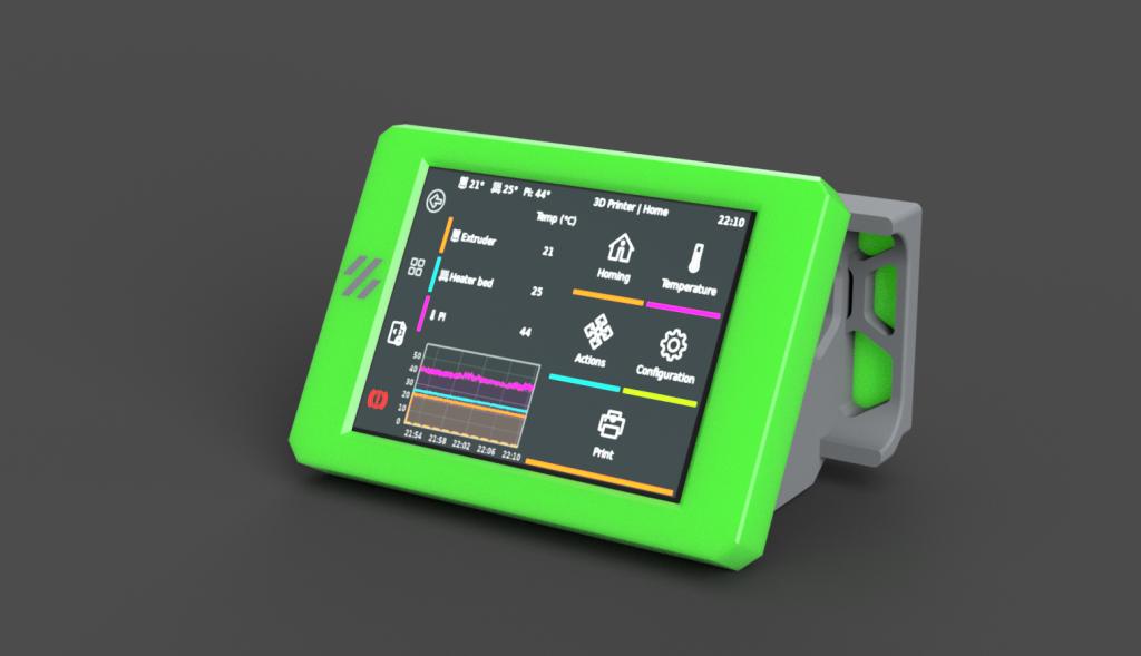

Voron 0.2 Waveshare 2.8 DSI Display
render
BOM
Waveshare Display
DSI Cable

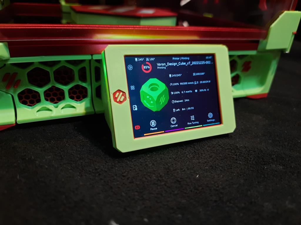

This display mount attaches using stock hardware on the V0.2 as well as the hardware that is included with the display
DK_V02
Thanks DragonKitty! for testing the display mount
