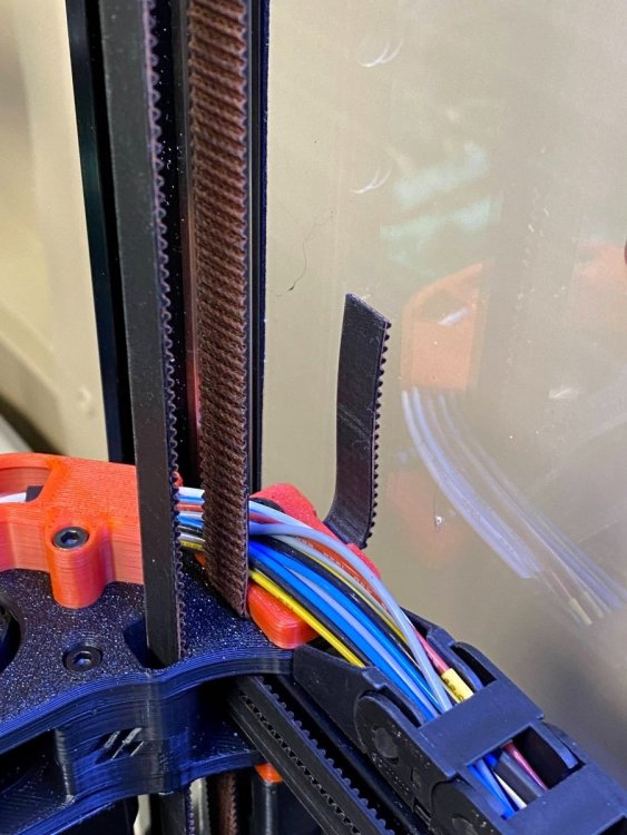

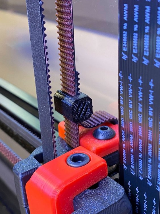

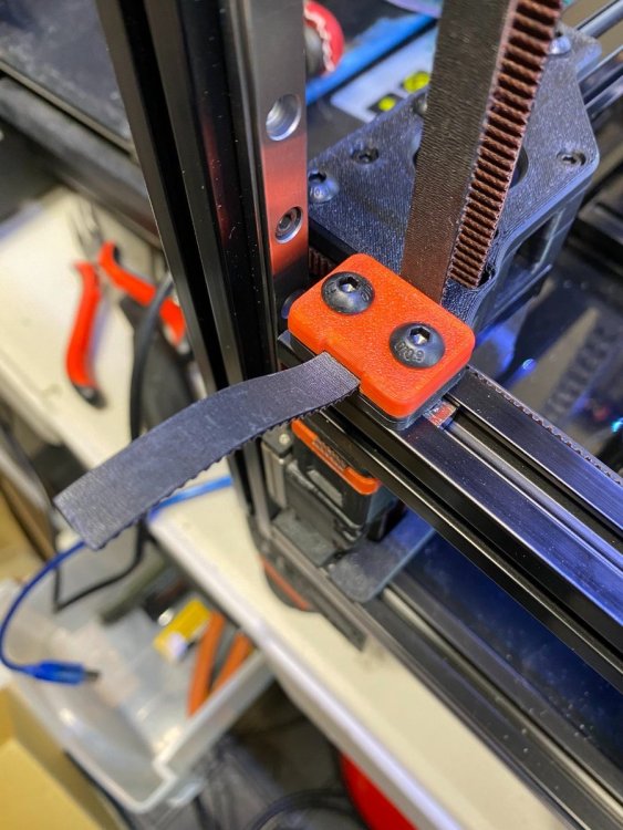

The 2.4 manual suggested leaving 1 to 2 inch Z belts, however, when the panels are up, the extra belt can drag along the panel. Not sure about adversary effects but not a bad idea to keep it tidy. The clip works for 9mm width belts, also should fit 6 mm. Just print and slide on.
Extra Belts Length Before Panel
Extra Belts Length with Panel
Installed Clip, all cleaned up!
