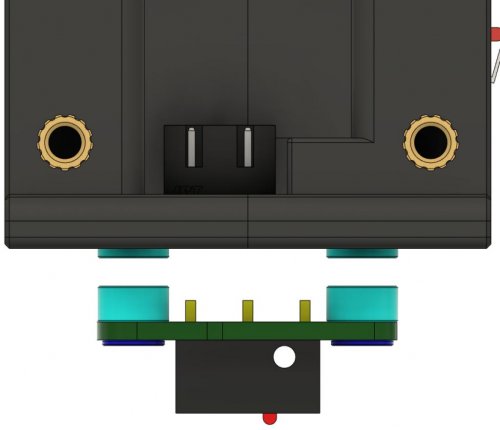

  3. Mgn12 Euclid
    Afterburner MGN12 Carriage with Integrated Euclid Probe
    Euclid Probe by nionio6915 (Github), https://www.euclidprobe.com/
    This is a modified version of the MGN12 carriage for a Voron Trident or modded Voron 2.4 with a cutout for mounting the upper Euclid PCB.
    Other than requiring a Euclid Probe, the only additional parts needed for the MGN12 carriage are two M3 heatset inserts for mounting the upper PCB.
    When installed, the Euclid's magnets should barely protrude from the bottom of the carriage.
    The JST connector should be easily accessible from above

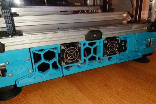

  11. V2 200 4020 Electronics Fan
    With building the famous V2 200mm² there are different challenges to encounter. Adding Skirts is one of them. Changing the file
    6 downloads

  22. PCB Cover
    Voron Afterburner Toolhead PCB Cover
    This cover is made for the tool head PCB from HARTK. To mount the cover, please use a 22 mm M3 screw. The sleeve is used as spacer between PCB and cover.
    It should be also possible to use the cover without the PCB. For that you have to design and print a custom sized sleeve part.
    New version with Air Vents
    This is an updated version to the cover with air vents for better air flow to the thermistor on the PCB.
    426 downloads

  25. Skirt Fan Mount
    Skirt Fan Mount
    To screw the fans in place, eight M3 heat inserts have to be inserted in the fan mount. U can use the heat inserts which are listed in the Voron BOM.
    The cutout at the top (where the mount gets attached to the printer frame) can be used for cable management. This may only work for smaller cable diameters on the fan. I have installed two 12V fans in series to use them on the 24V controller output.
    249 downloads
