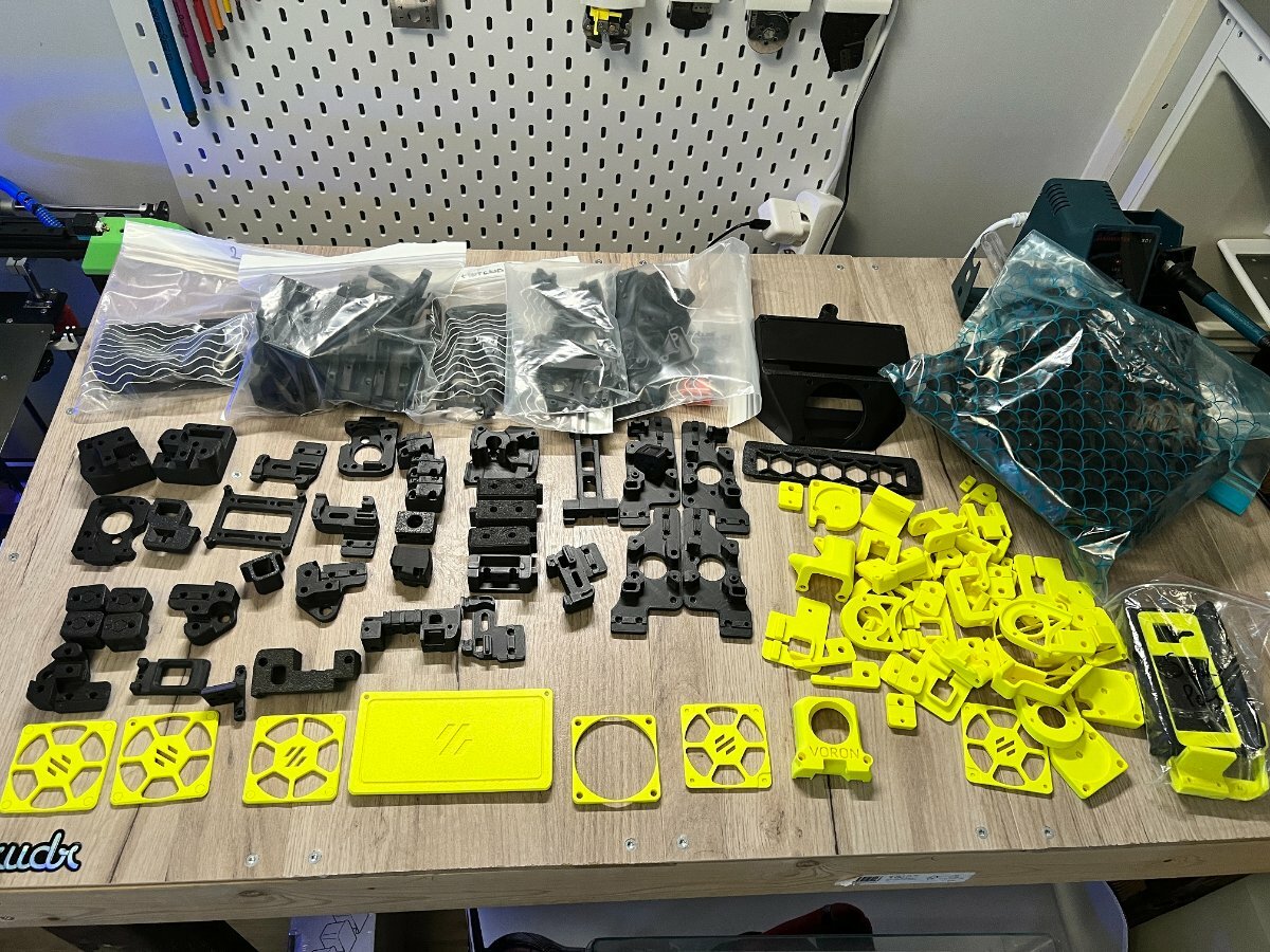

  1. I've been jonesing to start this build for awhile, but got delayed by the various storms (delayed shipping) and then work and travel. I got my PIF parts from triponaduck which looked amazing, and have been working when I've had time the last week. Don't have time to work on it today so I thought I'd start writing some things up. So, working on either a workbench or on a large 2x2' terrazo (cheapest I could find) tile I mounted on some 1/4" ply to make a portable work surface. Putting together the frame was a joy. Just simply and satisfying. Came out nice and square. [[ I tried uploading images, but they come out as a solid color -- any hints? ]]

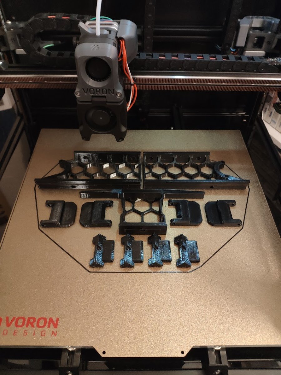

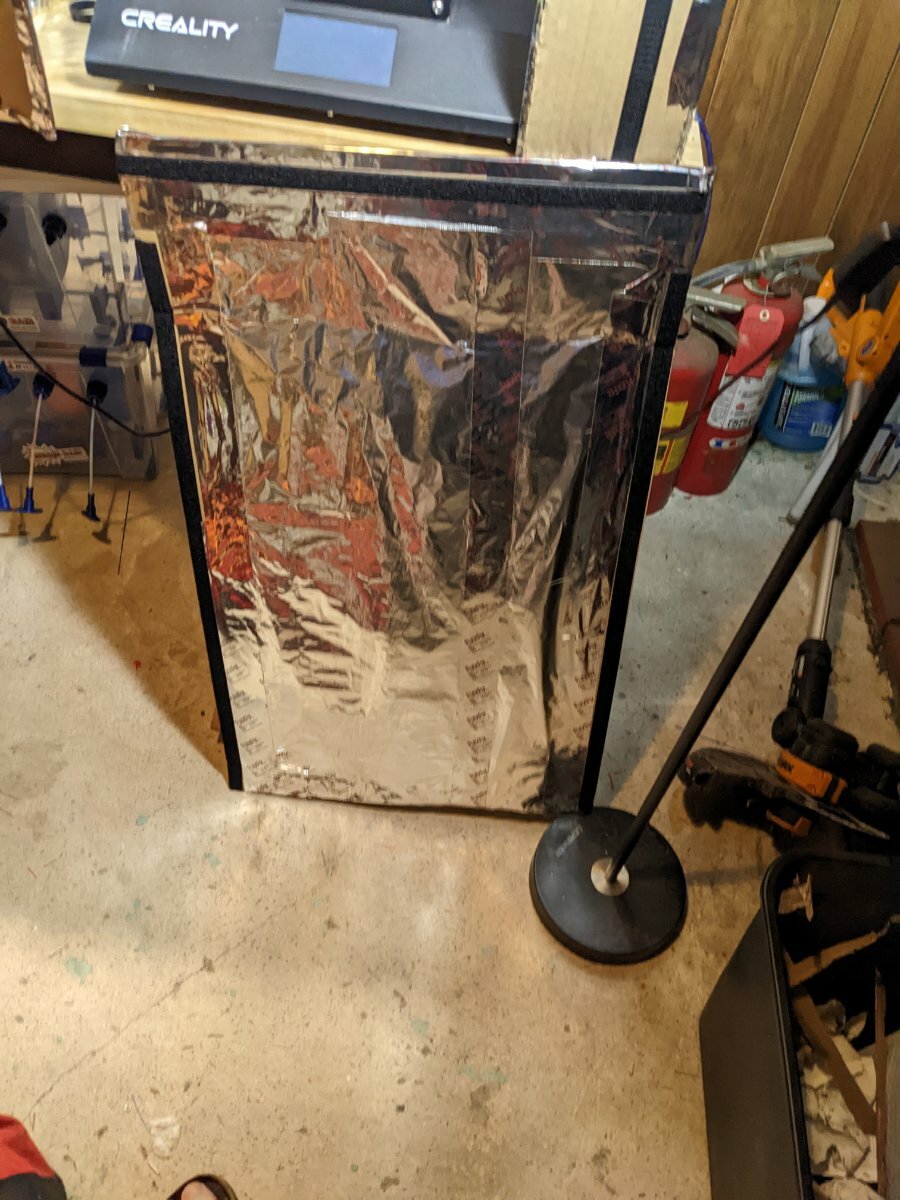

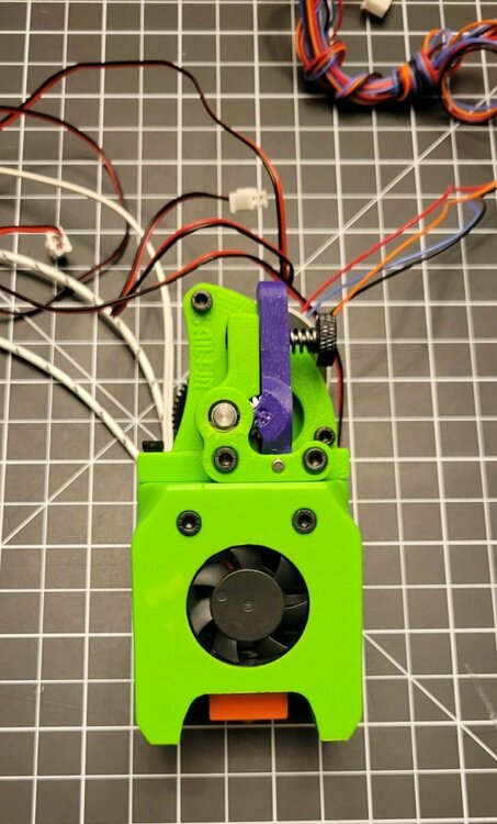

  4. This is my first Voron build, got the email from Formbot saying the kit be being shipped (Whohooo!) I setup a ghetto enclosure with two cardboard boxes for my Artillery X1 to print parts. Also first time printing ABS so this will be interesting any help, suggestion, critic are welcome. Figured I'd start with electronic bay parts to tweak slicer setting (Cura 5.1.0) since parts will be hidden. Base colour Spartan Obsidian Black Sparkle ABS+, accent Spartan Cloud Grey Sparkle ABS+. Build will be in two week increment, I work and two weeks on two weeks off shift in Western Canada, almost at the end of my career I retire January 28th 2023 . I'm still browsing thru build, has anyone done the LDO electronic bay layout with the Formbot kit where the din rail run from front to back instead of side to side? I need to setup one of my Artillery X1 with Klipper so I can get familiar with the platform, presently using Octoprint so may go the Octoprint/Klipper route first then migrate to Mainsail. Print in the photo are 3D3 Sigma Prototype ABS.Printing at 235C/110C glass bed with PEI sheet is why I set it 10C higher. Use hairspray too help with adhesion clean with Isopropyl before re-applying hairspray seem to working for me. Titanium heat break with a Micro Swiss copper plated #4 nozzle.

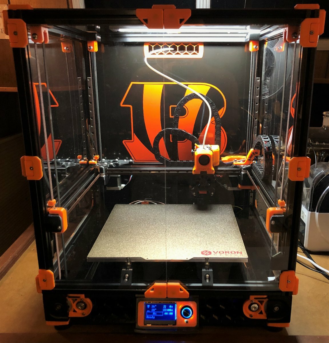

  5. Ah.. nothing beats a short and snappy title Building my 10th V2.4R2 or so, and this one is 100% for myself instead of selling it. Most things I be using here on top of the default Formbot kit, and adjustments to the default print parts are what I use in all my builds, this one has just some little extra or lets call it the "supreme" package... its still a Formbot and not sourced the parts by myself, but its a good quality kit, affordable, and they ship fast, if you like to build your own. I sell Voron builds, fully build, so I get quite a lot of questions, people who want to build themself a Voron, and I am a BIG supporter! Thats the whole idea of Voron. But I also know persons who are now trying to build their Voron for 3 months now, and still dont have it working properly, or at all... So... Hope this Diary/Guide is going to help you, I will try to make the parts that are most asked about better explained... I also get my information from others, there are way more experienced people out there than me, who wrote up great things, I will just link that way when we get there... What will this build look like, im based in the Netherlands Europe, so some links my not be useful, sorry. PS. I am NOT associated with any of these shops, dont earn anything on the links, etc, its just my build, advice is always welcome! Formbot Kit, this is where I order them - https://www.formbot3d.com/ - In europe? choose sending from Czech, and on Paypal payment, check the payment options to pay in Dollars, and let your bank do the conversion rate, for me this is about 70 bucks cheaper, paypal is expensive, shipping is free and there is no import, delivery in a week or so. This time im going for the Revo Voron, but normally I use the Phaetus Dragon HF/SF. Fermio Wire kit, nothing really wrong with the default wiring, yet its bulky and had breaking wires ones. Fermio wire kit is expensive, but awesome. https://fermio.xyz/fermio-labs-gmbh/voron2-wire-harness-btt-octopus-350-spec/ - about 125 euro, all Helukabel Heluflon®-fep-6y wires.. uhm, yeah, whatever, its good! Keenovo bed heater mat - Nothing wrong with the default Formbot heater mat, I just want to try this one: https://fermio.xyz/keenovo-international-group-limited/keenovo-silicone-heatmat-340-x-340-mm-230-v-ac-500-w/ - its a bit larger. Stealthburner with leds, I am a lazy ass, so I buy the LED string - https://fermio.xyz/fermio-labs-gmbh/stealthburner-rgb-led-kit/ its only 6 bucks, and has the thin high quality teflon wires, I just cant beat that price, by burning my finger on clumsy soldering... I am using different prints than the default ones where there are bearings used, especially toothed bearings.. I use smooth pins instead of M5 bolts and smooth bearings instead of toothed for this you need adjusted prints, some amazing guys made this already, and I will link to them later. Smooth pins are available on Aliexpress, or whatever you like. Then some default other wonderful mods, Klicky, PurgeBucket, other Front Idlers, Stealthburner, belt covers, Panzerball feet and 5" Touch display. Using Extrudr ASA Filament (big fan) but I am not stuck to it, I just dont use the cheap stuff, never been successful for me... I may go for another Red Bull theme here... Fermio custom Aluminium Composite panels. - https://fermio.xyz/fermio-labs-gmbh/voron2-v2.4r2-aluminium-composite-panels-350-spec-black-logo/ Other extra things may follow....along the way.. INDEX - to direct you directly to the posts and avoid all the useless comments here Setting up the frame(work) - Click here to go directly there inside this post. Setting up Z Rails, mounts/feet and motors and Z idlers. Page 22-51 in the manual. Click here to go directly to the post in this thread.... A/B Drives and Front Idlers. Page 62-81 in the manual - Click here to go directly to the post AB drives - Front Idlers Gantry! Page 82-107 - Click here to go directly to the post - Gantry! Belts Z and AB. Page 108-146 - Click here to directly go to the BELTS post.... Electronics and Wiring! Click here to go directly to the electronics/wiring post Software setup Klipper/Mainsail (sorry my choice!) - Click here to go directly to Software installation guide Follow this topic if you want updates!

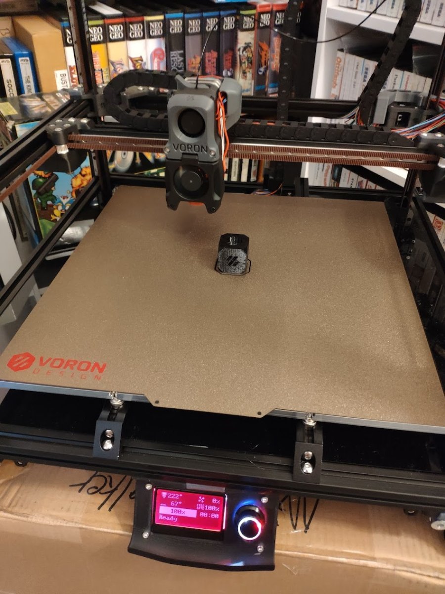

  7. Building a bed slinger this time around. Kit is in transit. I went with Frombot3D, they did me right with my 2.4R2 build so I'm going with them again. Would have like to try the LDO kit but price and availability turned me away. I guess I will see if the savings ends up being worth it or not. So far I'm printing parts. Base parts are Prusament Galaxy Black ASA, Accent parts will be FilamentOne ASA Sky Blue.

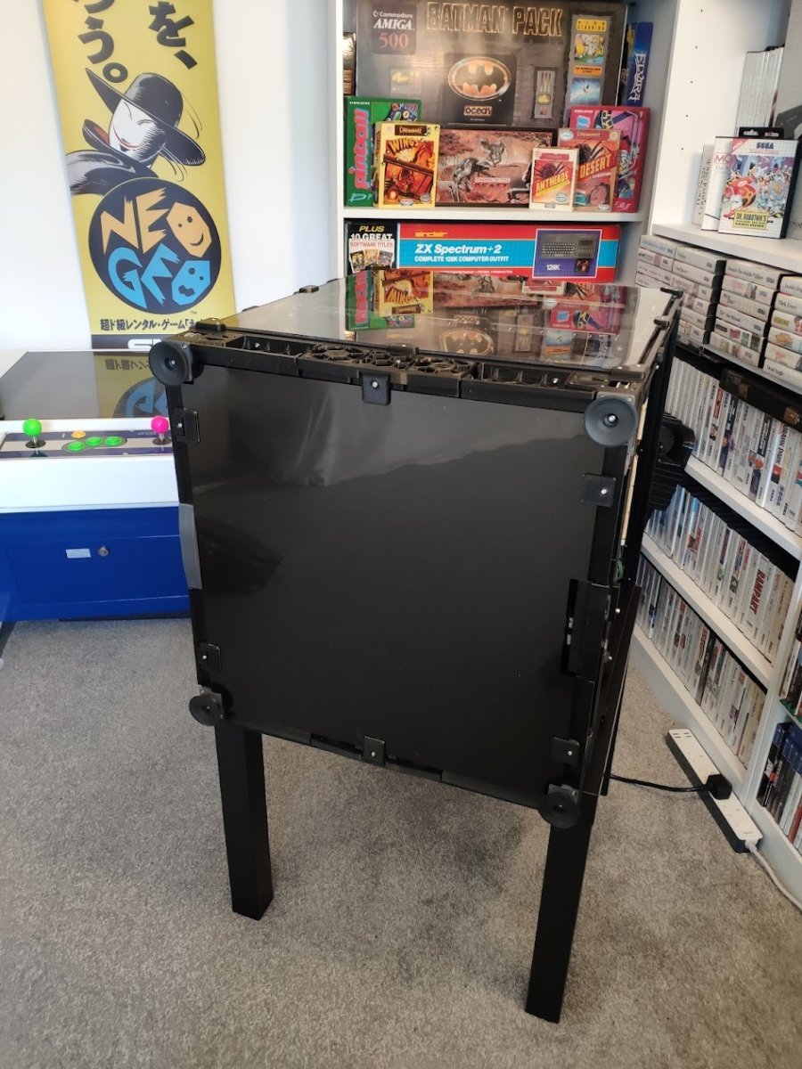

  13. Dusted off the Trident 250mm Formbot kit and laid out the parts on the build table. You're not building ANOTHER one!, she said rolling her eyes. But honey - its the Trident build - remember Poseidon or Neptune - powerful Gods all had the three thronged spear. I gotta have one too. Yeah but you're not in Atlantis - you're in sunny Oz! What can I say but Trident it is. Build plan: (I know it will change as I go along this three pronged journey) Color Scheme: Main: Grey Accent: Silver and Light blue (Black for electronics bay - cause if the magic smoke happens everything is already black) @Buurman - tested the silver for strength as you suggested - seems to be holding up as good as the grey Filament: eSun ABS+ (Hotend 245, Bed 110 Chamber 42) Printed Parts printed on Voron 2.4r2, - 40% infill, 0.4width forced, speed 100mm/s, acceleration: 4000mm/s Hardware: 1. Formbot Kit as a basis (Frame, hardware, wiring, electronics, etc) BTT Octopus v1.1 board, TMC2209 stepper drivers included as well as a Bigtreetech Mini 12864 v1.0 LCD 2. Voron TAP with 5V PCB and optical sensor: (https://github.com/VoronDesign/Voron-Tap) 3. Sexbolt Z endstop: (https://github.com/hartk1213/MISC/blob/main/Voron Mods/Voron 2/2.4/Voron2.4_SexBolt_ZEndstop/STLs/TridentSexBolt.stl) 4. Pin Mods for AB Drives and XY joints:(https://github.com/VoronDesign/VoronUsers/tree/master/printer_mods/hartk1213/Voron2.4_Trident_Pins_Mod) 5. Ramalama2 front idler mod: (https://github.com/Ramalama2/Voron-2-Mods/tree/main/Front_Idlers) 5. Door Hinge mod: (https://github.com/VoronDesign/VoronUsers/tree/master/printer_mods/randell/Door_Hinges) 6. Nevermore Carbon Filter: (https://github.com/nevermore3d/Nevermore_Micro/tree/master/V5_Duo) 7. Logitech C922 camera mount (https://github.com/VoronDesign/VoronUsers/tree/master/printer_mods/Iakabos/C920_mount) 8. Inverted Electronics mount (https://github.com/VoronDesign/VoronUsers/tree/master/printer_mods/LoganFraser/TridentInvertedElectronics) 9. Raspi Pi 4, 4GB 10. BTT PiTFT50 with Klipperscreen 11. Revo Voron Hotend Mods considered but not yet included: (will see when I get to that part of the build ) 1. Internal Spoolholder / Horseshoe spoolholder - don't think this will fit inside a 250mm build: (https://github.com/VoronDesign/VoronUsers/tree/master/printer_mods/LoganFraser/HorseshoeSpoolHolder) 2...... whatever pops up along the way!! No doubt @claudermilk will have some great suggestions. I know he is planning 3 mods on his already finished Trident Unpacking the kit : Well packaged and surprised at what was included. BTT Octopus, Moons Motored, Dragon HF hotend. Rails look OK, but will have to clean and see how they perform

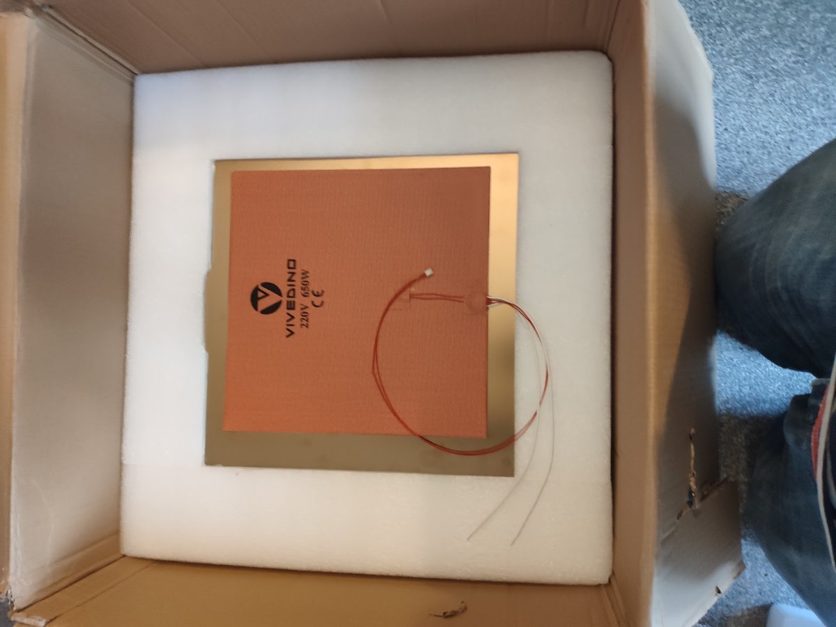

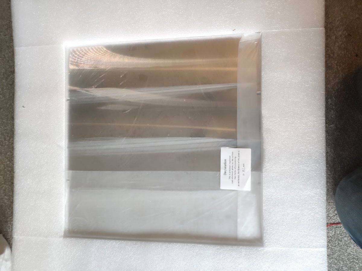

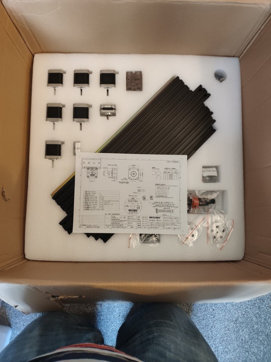

  15. Received three packages from Frombot (Voron 2.4 350mm, Trident 250mm Voron 0 ), as I decided I was going to see what it was like building a kit rather than self sourcing everything as in the previous 3 builds, and comparing the kit form to a self sourced build. The Voron 0 packaging was secure and well packaged. Happy to have received the Moons motors. The controlled board was a BTT SKR 3 mini v3. And No Raspi pi. Luckily I have some spare.

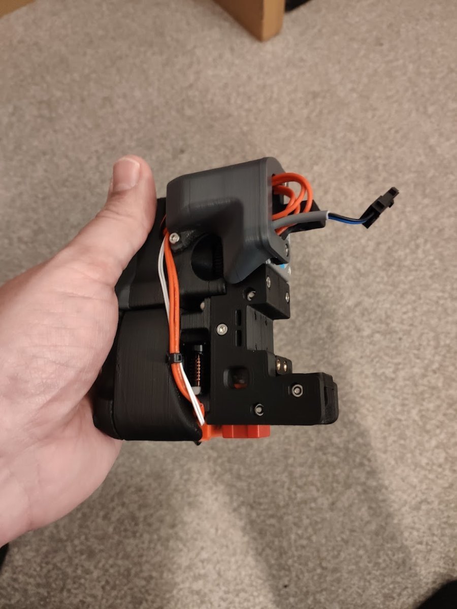

  16. Starting building soon, most parts are delivered or in transport now. had some delay of Formbot city lockdown, but LDO is having massive delays also (even worse). Expecting to start building in about two weeks.... to be continued! Voron Kit: Formbot 2.4 R3 350 Vulcan SF Printed Parts: ASA Carbon Black & Neon Yellow (Neon Yellow was self sources, not a default color offered) High Quality prints from Mehmet (Turkey) on Etsy 5 star rating https://www.etsy.com/nl/shop/Yacime3D?ref=simple-shop-header-name&listing_id=1188668167 Wiring: Decided to buy an all black kit + SB kit from OneTwo3D.co.uk LCD: BTT Pi TFT50 v2.0 - BigTreeTech Electronics: Need to decide to mount things normal, or vertical, see what brings best space and cooling. Ventilation/filtering: Nevermore Duo with two Delta fans. Mostly for the hot air distribution, but filtering helps. VEFACH filter outlet MOD

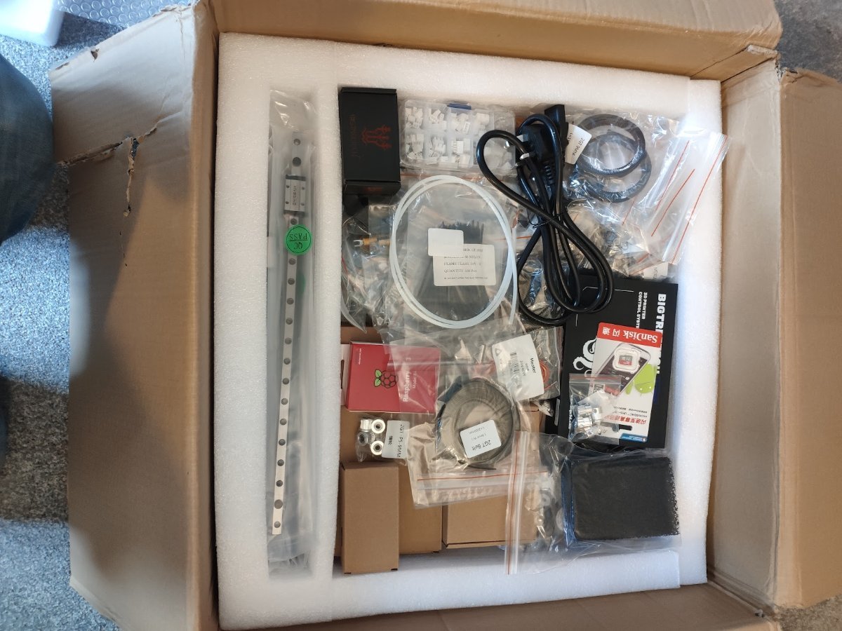

  17. Hi all, Thanks for the warm welcome in the intro section! Appreciate it! just received the Formbot kit. Shipped super fast. Ordered from their website, not AliExpress. There were some surprises in the box. 1. SKR Mini E3 V3.0 board. I was expecting the 2.0 2. All Moons motors, not just the extruder. 3. No JST connector kit or wire. They included the Umbilical Mod. Threw me off. Now I need to research how to do it. There is an umbilical section on the GitHub, plus some extra STL parts I need to print. Looks interesting. Adds plugs for both part fans also, so no need to splice. inventory going on now. Will update soon.

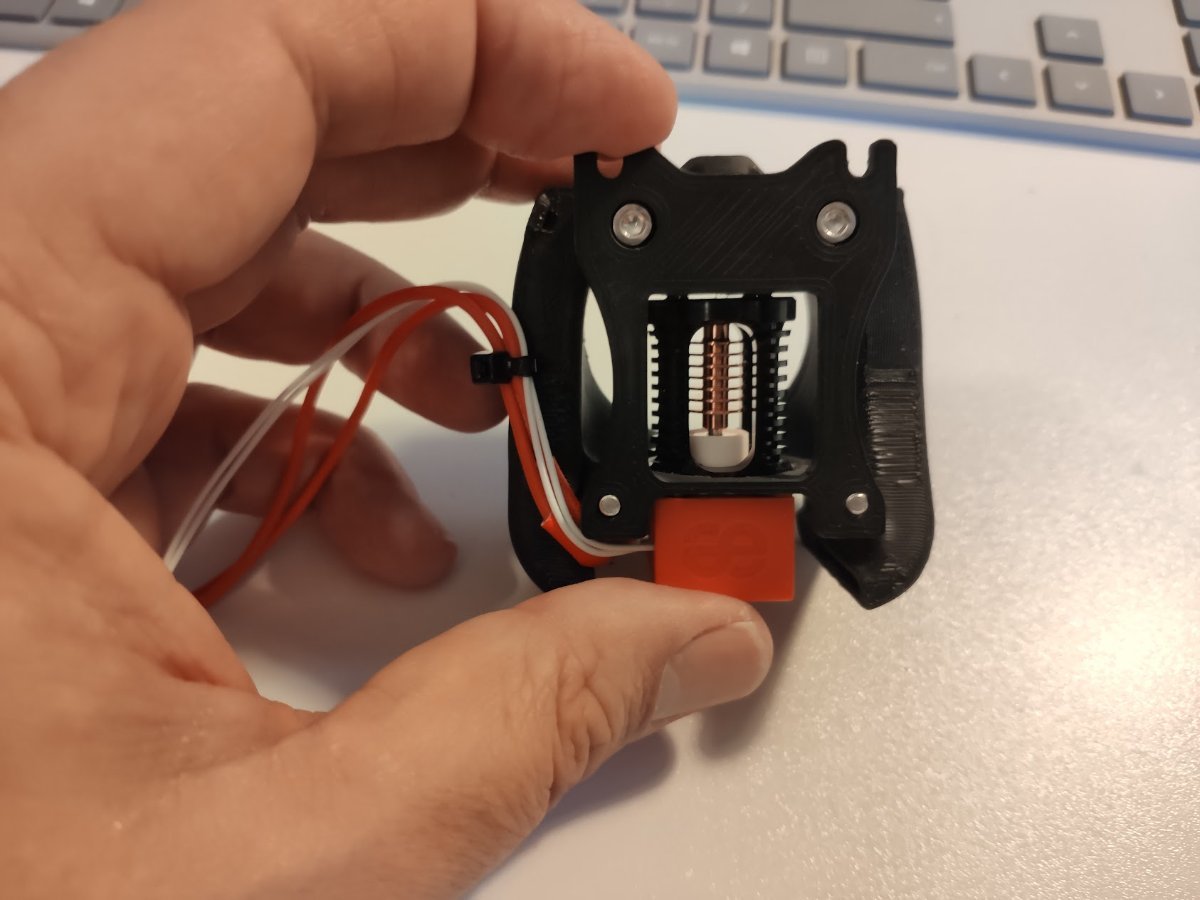

  18. Formbot kit. (Dragon HF hotend) Planning to do the Mini AfterSherpa/Sailfin for my print head, mostly because I really want to be able to get to the large plastic gear to manually advance/retract filament when loading and unloading. I have that on my modified prusa (via a bondtech bmg) and I don't want to go back to not having it. Bought parts for the Umbilical (https://deepfriedhero.in/products/voron-v0-umbillical-and-rear-connector-boards?_pos=2&_psq=umbilical&_ss=e&_v=1.0) but not sure how to get the board pointed straight up given that the sailfin turns the extruder motor sideways. went ahead and built the extruder/hotend without the umbilical for now, since the kit has most of the wires already made, and I'd have had to redo them for the umbilical, anyway. I'll save that mod for the first time I want to change out the extruder (and get annoyed that I have to open up the whole cable bundle to do so). Bought a fan an some (supposedly non acidic) charcoal for a nevermore, so went ahead and printed the parts and put that together while waiting for my kit to arrive. Main parts printed in Fusion Filaments Geomagnetic Mauve Accent parts printed in Atomic Filament Neon Green UV Reactive ABS Black parts printed in Atomic black ABS Other mods/things I'm considering: Per https://www.youtube.com/watch?v=z3_A5d-1Vq4 an additional thermistor (for measuring build chamber temp) can be connected to SPI GND+MOSI pins. That seems useful enough to do. https://www.printables.com/model/146877-voron-0-voron-01-raspberry-pi-camera-mount I'm spoiled having cameras on all my octoprint instances. I'm probably going to want a camera on this printer, too. Though I'm new to klipper, I've seen mention of using cameras with it, so I'll figure it out. https://voronregistry.com/mods/quackprofit-v0adafruitneopixelledmounts Well, if I'm going to have a camera, I'm probably going to need some lights, so why not go a little extra? Kit delivered, and I got all the accent parts printed (since that filament showed up first). Went ahead and built a nevermore filter while I'm at it, since I expect to be using this printer to print ABS and whatnot. I found a link to that cable channel model somewhere in the voron community, but can't for the life of me find it now. The picture I saw was it fitting in a V0.1, so I'm hoping I can find a place to put it and help manage the cable mess that printers always become. Put the extruder/hotend together to make sure I had all the pieces I need. Not sure where I'm supposed to get a different carriage, since this one has a curve in the top that doesn't line up to where the motor actually is on the sailfin, but whatever, it doesn't obstruct anything, so I'll keep it this way for now until I find or design a different carriage. + Tip: The PEI stickers from Prusa for their Mk3 steel sheets are big enough to make exactly four PEI stickers for a bed the size of the voron 0. Since my flex plate came with textured PEI on one side, but bare metal on the other side, and I had a couple spares of these, the bare side got a PEI sticker to give me options for a print surface. Progress on the actual printer build. Having done the bed frame, i now understand why people buy the stamped metal ones. Lining up the nuts for those 8 screws was the most time consuming thing I've done so far on this thing. And more parts printing (the angle of the camera is exagerating the warp, but yes, those parts are warping. This enclosure is a little too big to heat up well, so I probably need to avoid having parts near the edge of the print bed. We'll see in an hour when this set is done if these will be usable, or if they're scrap. Other errata: The printer above is actually my second Prusa mk3 (a mk3s+ to be specific). I printed all the green parts, black parts, and the first batch of purple on my first mk3, but it's old and struggling. I was having extrusion issues (unable to tune for temp or extrusion modifier effectively) when I checked the nozzle and found it was hollowed out to about .6 by years of printing abrasives (it's hardened tool steel, but even that has limits). Then, after replacing the nozzle and getting it printing much better, it had a temperature panic and reset during a print job. I tried to run a PID tune, thinking that ABS prints hotter than the CFPETG I usually run through it, so maybe tuning was in order, when I saw fumes coming off the nozzle during the heatup/PID tune. At first I thought it was steam and the filament was wet, but then I saw the temp go from 245 to 280 in about a second and a half, and realized two things almost instantly: a. My thermistor is dying/failing/flaking. b. That wasn't steam, it was smoke, and I was burning filament. So I quickly reset the printer and opened a window to keep my smoke detectors from going nuts (the camera is close to the nozzle, so the actual amount of smoke was small, but I was definitely burning the filament. ABS doesn't smell pleasant on a good day, but I had to air out that room for a while to be comfortable going in there. So yeah, I guess my old mk3 needs some love before it's going to be doing big print jobs again. Hopefully I get the V0 up and running soon, and it can fill in for now until rebuild the hot end (I was getting annoyed at the PINDA probe, anyway, since printing at ABS temps starts to get to the point where the PINDA messes up its reading and your nozzle height gets screwy. The new generation (Super PINDA) on the mk3s+ has no trouble levelling the bed even after heating up for 20 minutes to try to get the enclosure to a decent temp. (Well, I say that, but the picture above does show the parts curling, so obviously the enclosure didn't get as warm as I'd like). Okay, that's probably enough for now. That batch is almost done on the printer, so I can check the parts and do some more assembly if they're usable.
