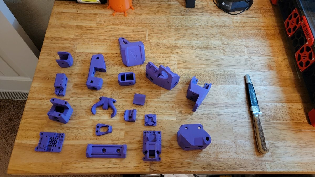

Welp... Venturing into uncharted waters again. This time something new and something different. I started printing parts right after I ordered the kit from @Fabreeko_Hector. The kit comes with printed parts but, I want to build this printer with parts that I printed. I don't know... do you think that's cheating? Some of you already know what it is but for now I'll let you guess, it won't be too hard to figure out. First bunch of parts. Filament is Polymaker Polylite ASA Purple, Noz=240c - Bed=110c, Speed was 40 mm/s 1st layer, 150 mm/s - 3000 accel for everything except the outer perimeter and top which is 60 mm/s. Chamber was ~43c. I would say the results are good but not great, definitely acceptable. Still need to print a couple more purple parts and a few black parts and hopefully... I'll have them ready for this weekend.

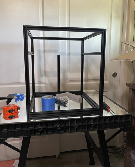

Have had my MK3s for a couple years now and while waiting for their next product decided to try my hand at a Vorn, just couldn't pass up the opportunity after seeing so many videos demonstrating the print quality and the speed... oh the speed. Chose the Trident mainly because I saw someone was tinkering with idex. Did a lot of looking (searching) for kits and ended up ordering the kit from Fabreeko, communication before even considering the purchase was awesome and very refreshing... hopefully the rest of the Voron community is just as nice. No experience printing ABS on my current printer so decided to order printed parts, this in itself was an experience because the options on the Trident are wide and I had no idea what "configuration" I needed to order for the printed parts (direct drive vs bowden, CW1 or CW2, AB or SB, PCB, control board... you know the drill. Luckily this is one of the areas where Fabreeko shined and basically listed out what options I needed to select. Started watching build videos on the day I ordered, initial thought was WTH am I doing, but after revisiting videos the picture got much clearer. Have had printer kit for a week-ish now so built the frame and started loading software on my raspberri pi. Did I say I built the frame? Did I say how I love the blind joints? I'm glad I built the frame before getting printed parts or I feel I would have rushed things a bit... those darn blind joints are a PITA.... get things to what appear to be just right, tighten it down and crap.. it shifted. Loosen a bit, get things re-aligned, tighten down... crap... it shifted. I probably revisited the frame 4 times over a week's time, but the result is nice. I keep having dreams (not really) of whether or not my screws are tight enough for the long hall and have to catch myself periodically to not touch it.... so we'll see how long I can last. Printed parts are supposed to be in tomorrow so this weekend will be a fun one. Didn't take many pics initially, but here is a taste.
