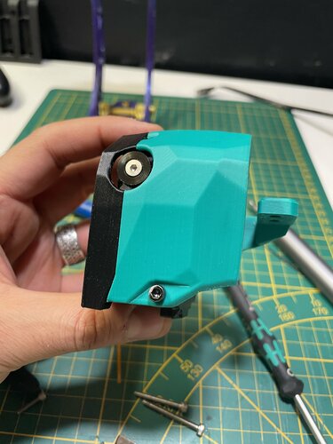

Orbiter 1.5 on SB
20/04/2022 .step available
my config
rotation_distance: 35.1
gear_ratio: 75:10
microsteps: 32
full_steps_per_rotation: 200 #200 for 1.8 degree, 400 for 0.9 degree
nozzle_diameter: 0.400
filament_diameter: 1.75
max_extrude_only_velocity: 60
thanks to Eytecz (https://github.com/Eytecz/LGX_Lite_Stealthburner_CW2_style_mount/ ) for his mount of lgx lite on SB to inspire me to complet this orbiter 1.5 .
i hope you like it
