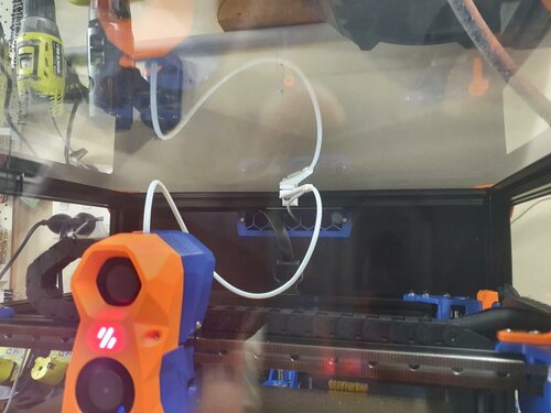

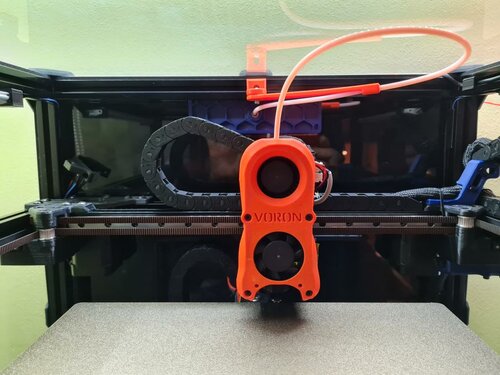

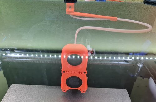

In my 350 build the PTFE tube kept getting caught so I made this arm to keep it up. The shorter arm works better so I recommend using it instead
Install
  • Drill out bowden guide with 4mm drill bit for a perfect fit (optional)

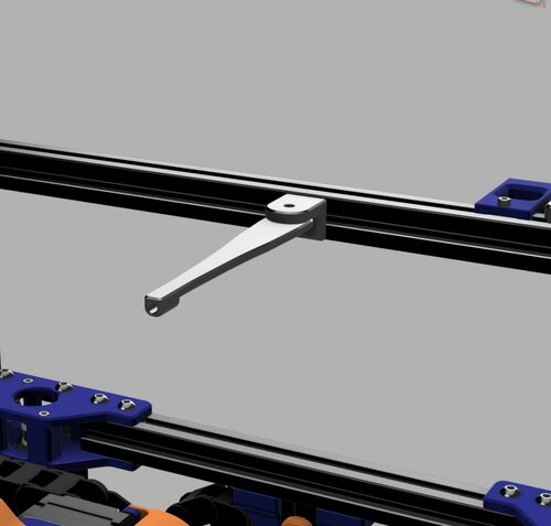

  • Bolt mount to rear frame with M3x8 and tnut putting the lip at the top
  • Screw arm on with M5x10 (I used a M5x8mm and it works fine) into the plastic allowing the arm to still be able to swivel
