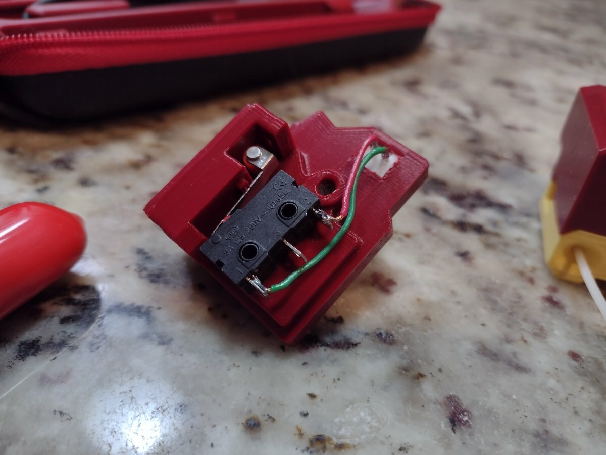

I designed this to replace the tube guide for my side entry exhaust housing.  It requires a heat set insert, an m3x8 socket head cap screw, a KW12-3 microswitch and a jst 2.54 connector.     I used a couple drops of super glue to secure the miscro switch and the electrical connector in place during assembly.
