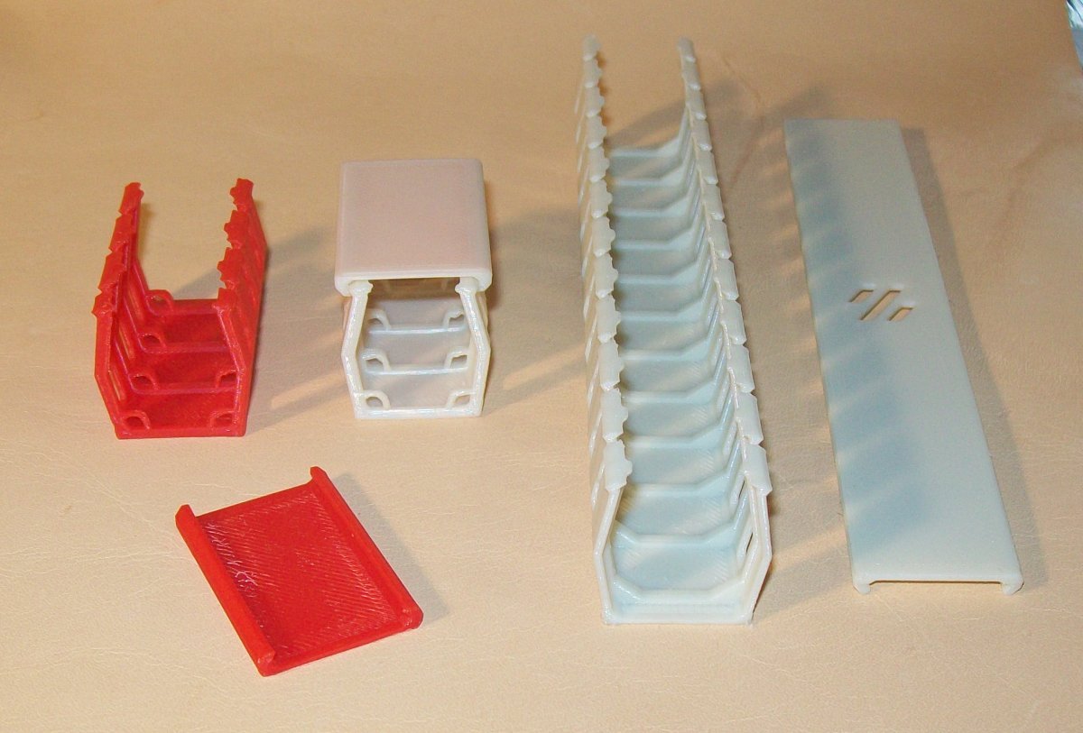

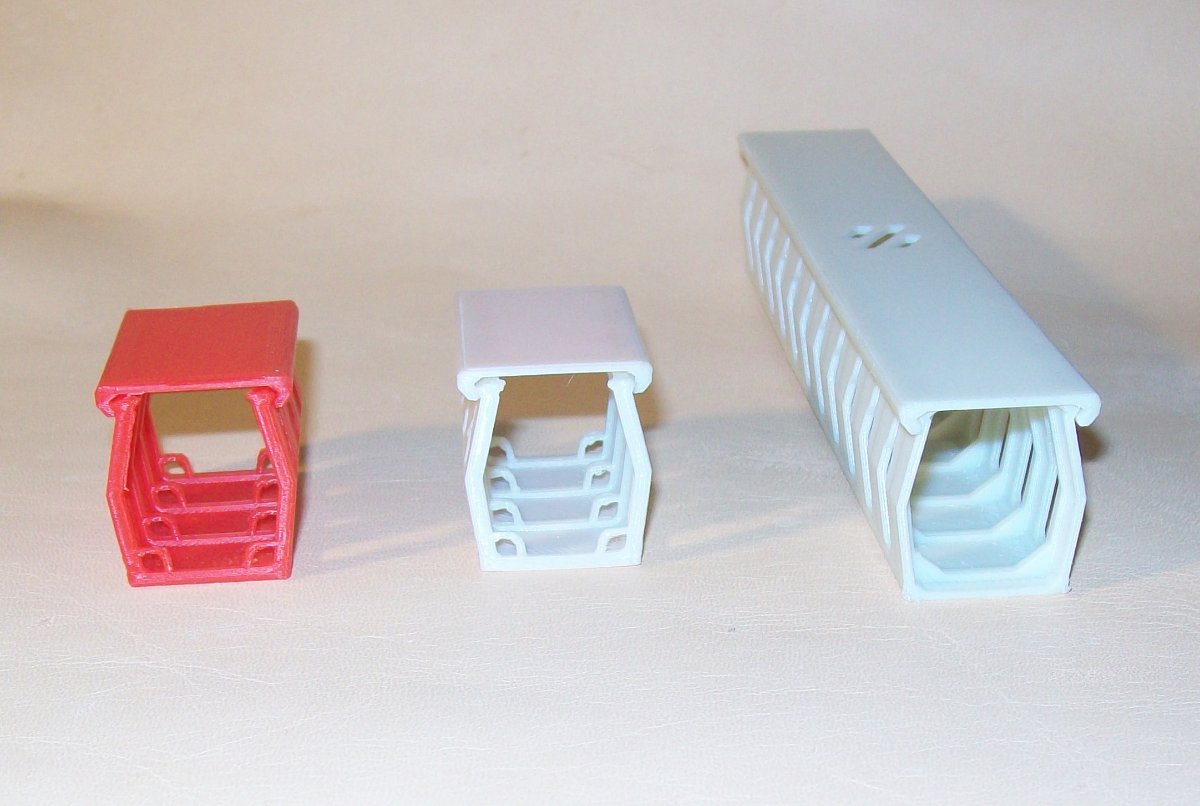

11 Details Changelog 0 Questions 4 Comments 1 Review 0 Tutorials Support Review Averages 5.0 out of 5 stars 100% 0% 0% 0% 0% User Feedback Join the conversation You can post now and register later. If you have an account, sign in now to post with your account. Your email address Required This will not be shown to other users. Your rating Required 1 2 3 4 5 Your review Required Add a review... × Pasted as rich text. Paste as plain text instead Only 75 emoji are allowed. × Your link has been automatically embedded. Display as a link instead × Your previous content has been restored. Clear editor × You cannot paste images directly. Upload or insert images from URL. × Desktop Tablet Phone Add review Most Helpful Newest 3dNutter 7 May 5, 2023 Share this review Good Design. The work of ryandum (his github: VoronUsers/printer_mods/ryandam/Cable_management_duct/ OR https://mods.vorondesign.com/detail/YTmSPTcWpctfTKQj3bOPg Strong enough where it doesn't snap. Tophat stays on when locked into place. Printed in both ABS and PLA. Both performed very well with no supports & very functional. Kudos to you ryandam for a great design. BTW, I printed several designs out there, and none hold up as good. I did make one small mod to it. Bottom inside corners of channels. I changed the Upside down L shaped spring-like forms(wire tie loops) to solid and angled them to a 45°. This provides just a little more stiffness to sidewalls for tophat locking, and reduces retraction to 0% while printing, and prints a little faster. It does however, remove the ability to use wire ties thru those loops, but adds strength. I don't know if I'll actually print & use these for a Voron (only time will tell when I get to that point) since the cost for an 8 pack is less than $25US, but great to have on hand for other projects. See pics below. 1st results printed flawlessly. 2 small samples/Red=ABS/Ivory=PLA. Full Size(140mm) in Ivory-BoneWhite. 3dNutter Link to review
