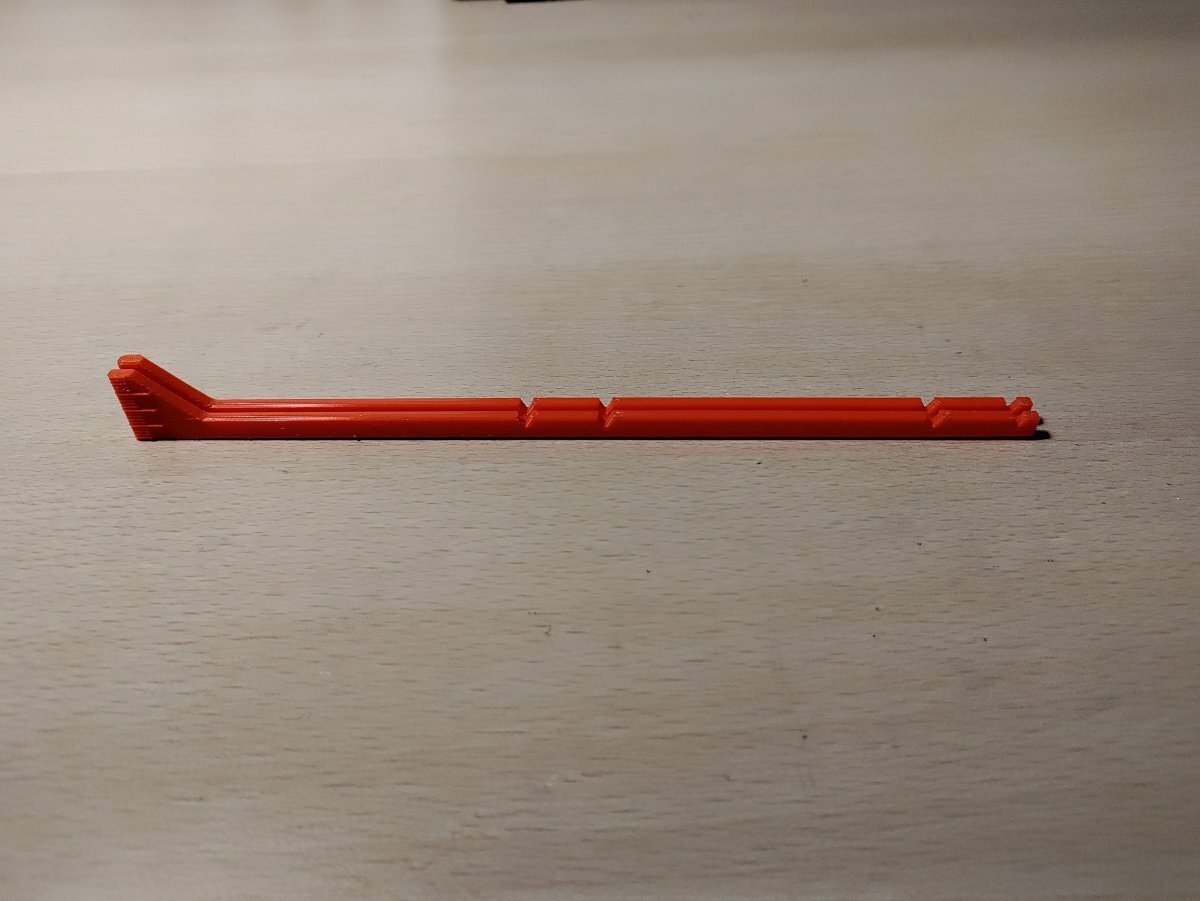

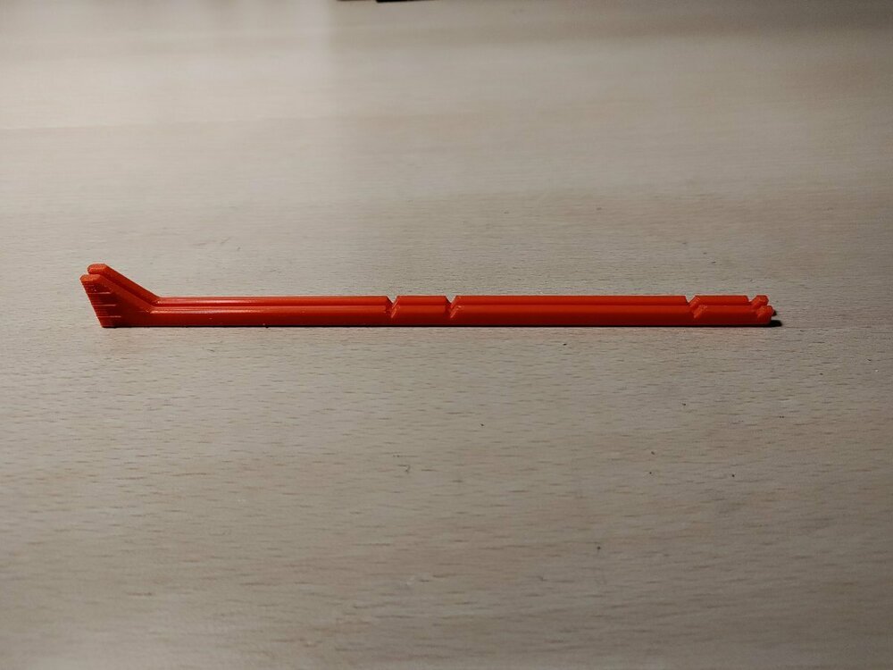

Since I know this forum loves gadgets and especially jigs, let me show you what I found and immediately printed. (no, not on the Voron yet. Getting there though)
It's a jig for measuring filament for e-steps calibration.

1 hour ago, mbunjes said:
Likewise, I learned who Rube Goldberg and Heath Robinson are.
Ooo! A jig! I'll have to mention to Steve on his stream today! He loves jigs! 😁

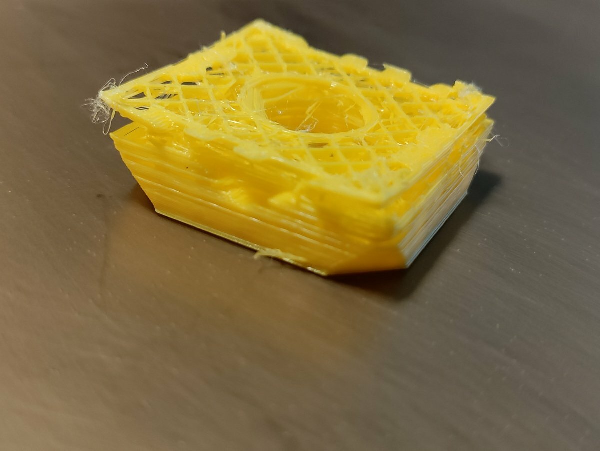

I decided to leave Superslicer for the moment, too many unknown factors. I finally managed to get a consistent Z-offset so I sliced the cube in Cura and behold : it prints !
It all went well for the first 10 or 15 layers but then things started to deteriorate quite badly. I don't know whether this is due to pretty old filament or other settings but I feel I made some major steps here.
  • Confused 1
"Hoorah, it prints?" I have to confess I hate diagnosing horrible print issues like this mainly because you get every piece of conflicting advice under the sun "Print speed too high; Print speed too low; layer height too high; layer height too low" etc.
I guess even well stored (vacuum packed) filament ages. I presume the plastics are full of lovely volatile chemicals that just dissappate//boil-off/break-down over time to change fundamental properties of the plastic.
On the basis everyhing is new (and quality) it can't be a shonky nozzle or one damaged by too many bed-strikes. So my money would be on aged filament and possibly print temperature too low (nozzle temp too low or cooling too high) I note the temperature in the gcode file is a fairly generic 205C, I presume it's PLA?. Having said that (and struck it out), looking at the picture again (and noting that pictures of 3d printing can be deceptive) does look like underextrusion, there's wee whisps of filament so to me that indicates the temperature is OK.
(There again, in the traddition of the internet, it could be your filament is too new, you need to ding up your nozzle and lower the print temperature whilst increasing cooling....oh and throw in buggering about with belt tension for good measure)....Sorry that's probably not very helpful.
What's the voltage to the extruder motor? I tried starting at 0.4A and it worked well...until it didn't. I have ended up at 0.6A which is reliable and doesn't skip steps (causing under extrusion and the mess you are seeing). It's a bit high (I would have preferred 0.45-0.5), but I'm not messing with it now.
