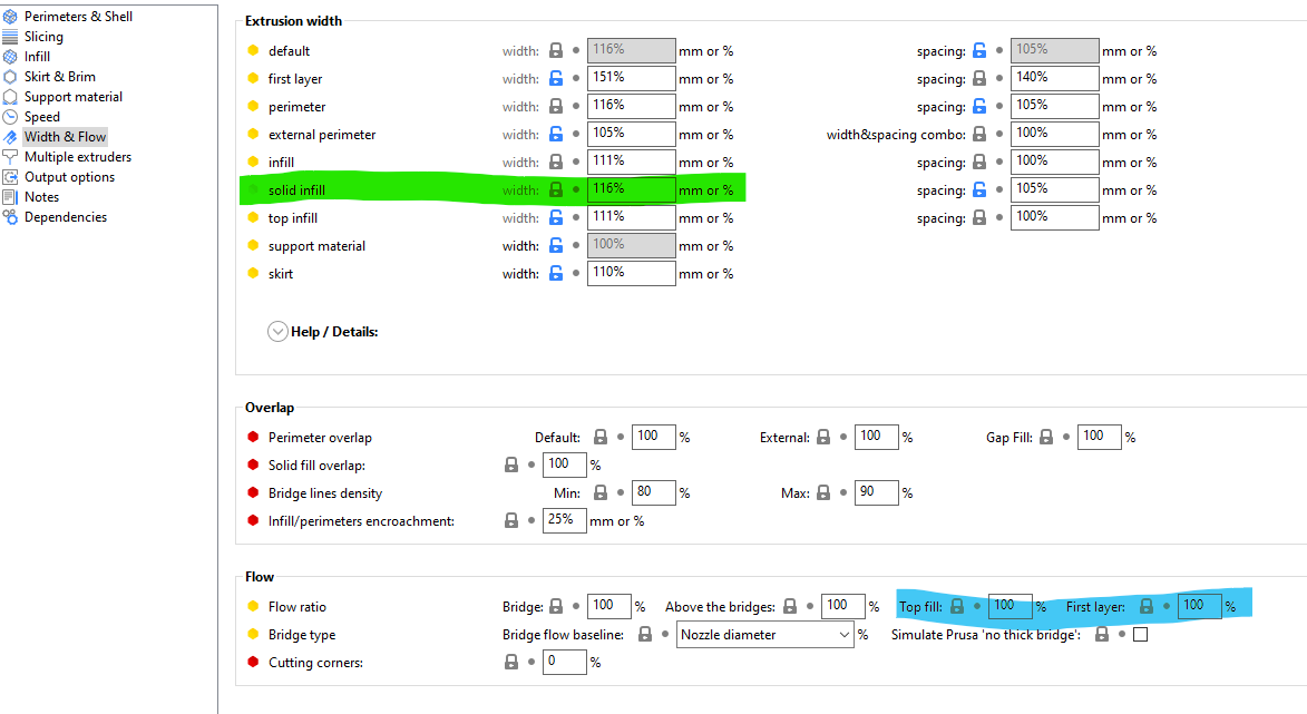

Yes, Actually Width & Flow, I use Superslicer but the same rules apply for all slicers.
For first layer I adjust First Layer Flow Ratio (blue) for solid infill I adjust width (green)
Don't use those values in the example though, the screen shot is a stock SS profile.
Here's what I do, generally...

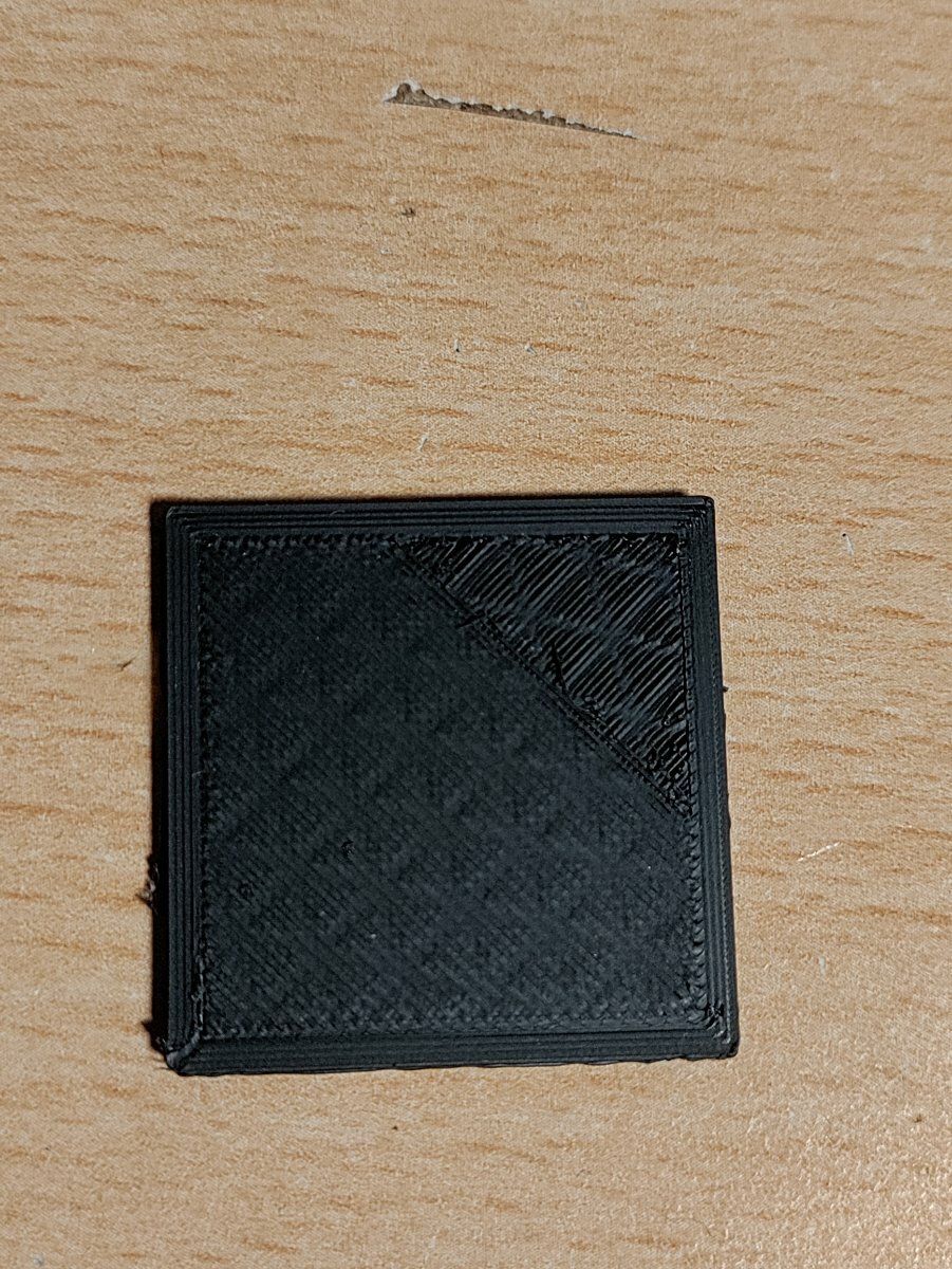

I print my 1st layer at 30mm/s (yes, really slow) 0.2mm high (although I used to do 0.3mm). Typically perimeters whether 1st layer or subsequent ones after I don't have a problem with, sloid infill I usually have to adjust. So for 1st layer, try setting the width & flow for First Layer to 95%. Try not to change multiple settings. Change something, print it. If the 1st layer looks good at your current setting then watch and see how the next few solid layers print and see how the infill prints, etc. If you see something that's not right... then home in on the area and make changes accordingly.

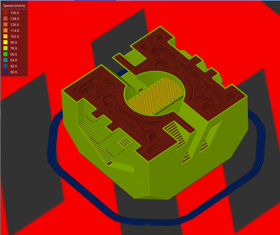

Here's a tip and it works pretty well for me... I print everything at 150-200 mm/s except for the 1st layer (30 mm/s), the outer perimeter (80 mm/s) and the top layer (80 mm/s). I feel it's a good balance between speed and quality.

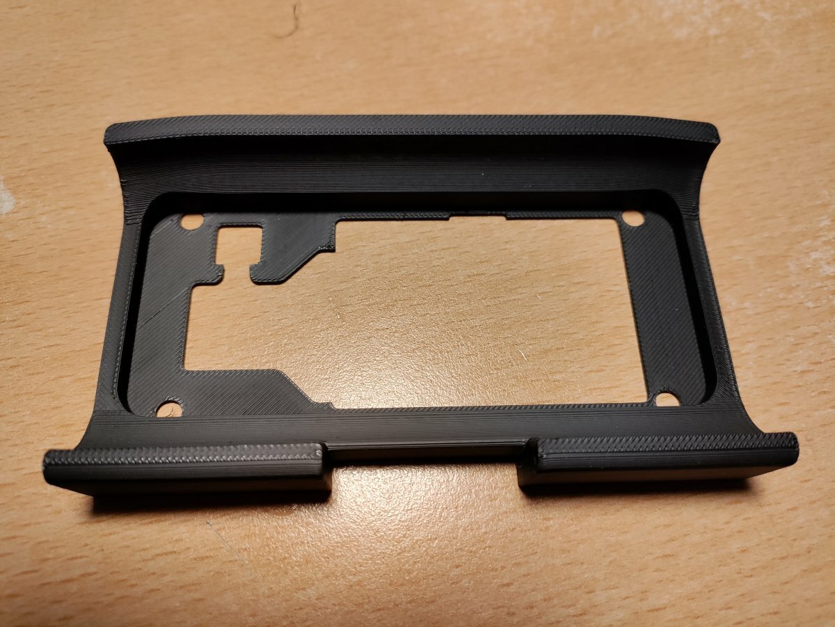

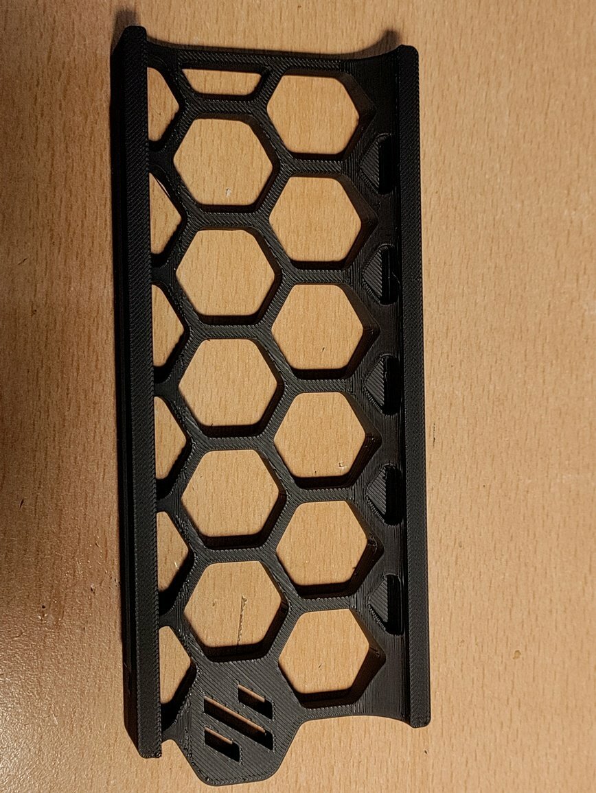

It seems you have to visit the deepest corners of hell before the light starts to shine and suddenly everything comes together : perfection is getting nearer and nearer
Yes you do LOL. It's definitely an iterative process. BTW, That's a nice looking part.
