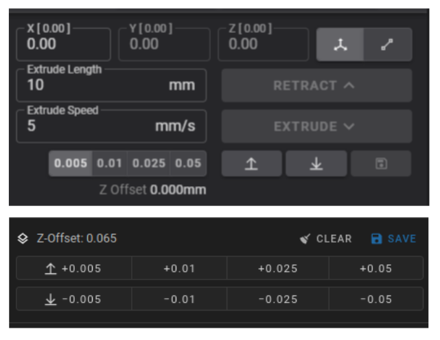

8 minutes ago, mbunjes said:
Arrow up brings the nozzle closer to the bed.
I guess that is another point that makes this process harder to make sense of. In Mainsail it is the opposite but the layout makes it a little more visual which arrow will do what.
Fluidd on the top and Mainsail on the bottom.. To make it even more complicated, in Mainsail, the zoom factor of the webpage will change the button layout.
3 hours ago, atrushing said:
Trying to wrap my head around plus/minus and up/down starts feeling like watching Abbott and Costello doing "Who's on First"!
It might help to keep in mind that Klipper doesn't care if the gantry or the bed moves.. When the Z-offset is accounted for 0.0mm is, in theory, the nozzle touching the bed. Negative numbers should try to move the nozzle closer to the bed while positive numbers should move the nozzle away from the bed.

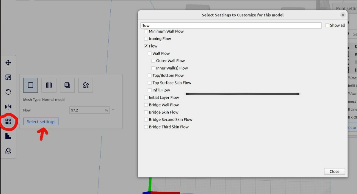

You can have multiple objects with different parameters in Cura. If you stick one of those calibration cube thingies onto the build plate, highlight it and then click the "Per model settings" on the left-hand button bar:
Then click the "Select sttings" button, in the pop up window you can then type the parameter you want e.g. "Flow" (equivalent to "Extrusion Multplier" in other slicers).
Then multple the object as many times as you want to vary the parameter ("flow" in this case). Once you have multiple objects you can then click on each one and go into the "Per model settings" option and set the things as you wish.
