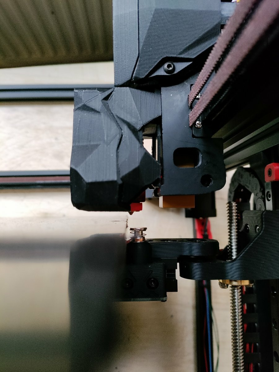

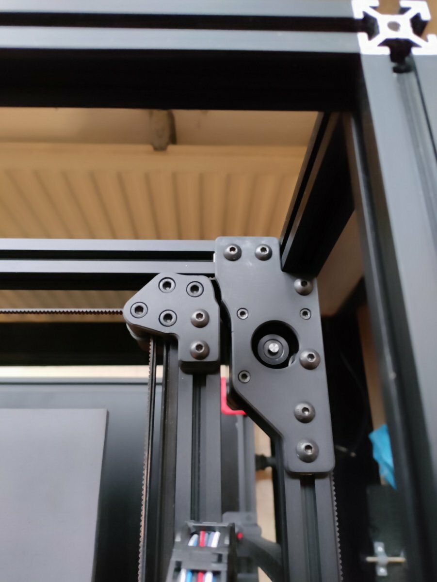

Thank you sir. But now I have a problem.
The Revo Voron does not clear the bed to reach the sexbolt end stop.
The tool head is at max X but as you can see the clearance is not enough.
Since I cant move the Trident bed I'm not sure what else to do

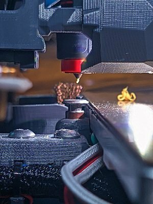

One other thing that I did is filed down the printer part a bit. The edge of the Chicago Screw head is nearly even with the back edge of my bed. I've also shoved the bed as far forward as part wiggle room will allow. It's tight fit, but it works in the end.
Just ignore the drool & yellow filament blob. I had just changed filament. Also, the proximity to the bed isn't an issue that part has nearly 860 hours of print time sitting there, plus any preheat time. YMax is set at 260 which puts the gantry physically about where yours is at.
