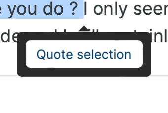

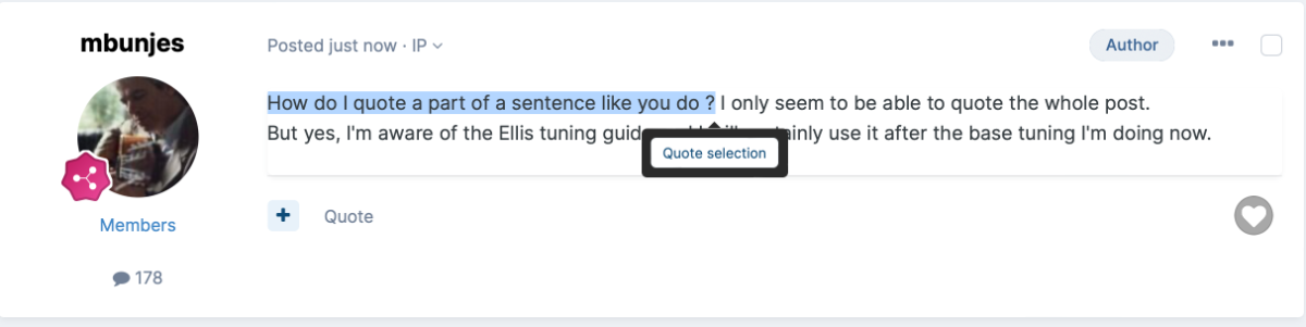

How do I quote a part of a sentence like you do ?
1. Highlight the part you want to quote
2. Then click the "quote selection" box - it will then put that part of text into your editor.
Hope this helps
