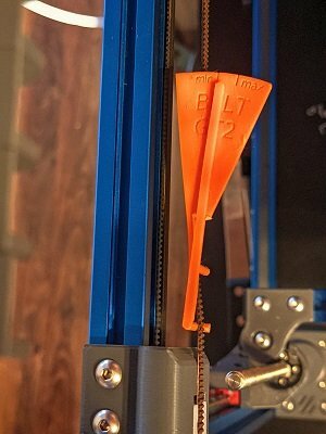

Good morning, long time no write. I had to take a break from my Trident but we're back !
Now, immediate problem for me is belt tuning. The left belt gives a tone (with a lot of imagination) the right just goes "blonk" with no discernable tone. The recommended Spectroid app is not helping, I see a lot of wriggles and tiny ciphers that disappear immediately before I have a chance to read them. I would like an app that just tells me "this was the frequency I just heard " in big bold letters or maybe someone knows an alternative way of measuring tension ? I know there are some printable tools that let you measure tension but they won't tell me what the right tension is. I've tried a few of them.
I have mentioned before I printed up the Prusa one and have been using that. I know I used the pre-sliced gcode they posted, but I also printed on my Mini and used PETG for it. I know there's remixes out there on Printables and Thingivere. Anyway, that's what I use and I am happy with my belt tuning. I took a couple of pic in my build diary when I recently swapped to the idler pin mod. Easy-peasy, the printer moves smoothly. I haven't re-tuned since I'm still messing around with getting Tap dialed in.
Aah yes you did, and you now what, I did print it .Damn I'm really getting old. So how much tension did you use ?
Those are the ones I use and let the print tell me if I should tighten or loosen the belts. Ensures even tension across Z and Y.

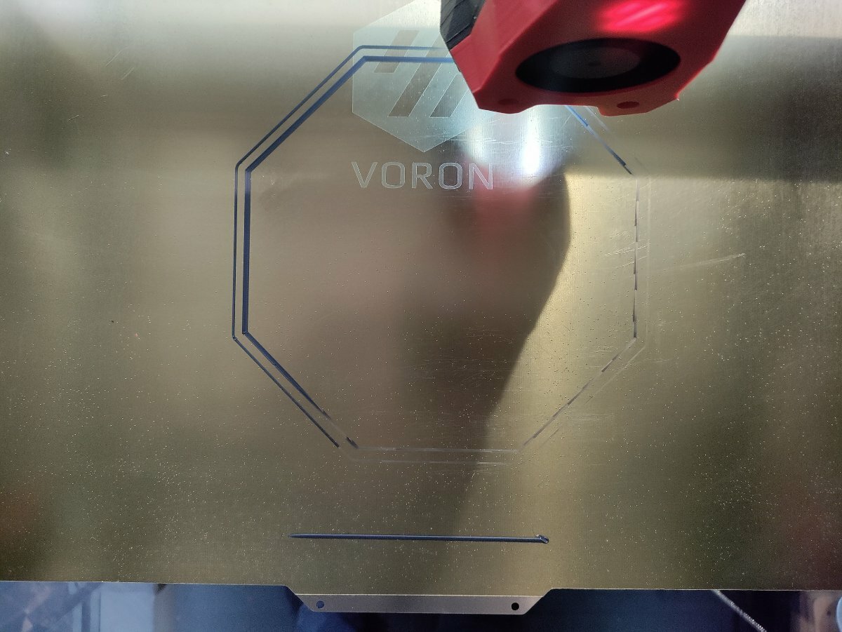

Dear Voronisti, today I have a baffling problem. It looks as if I've dialed in a nice Z-offset, but when I start a print (heat soak, Z-tilt adjust) it lays down a beautiful purge line and a nice left side first line of the print but when it starts to move over to the right it disappeares and is obviously too low.
Could it be unequal Y-extrusions ?
