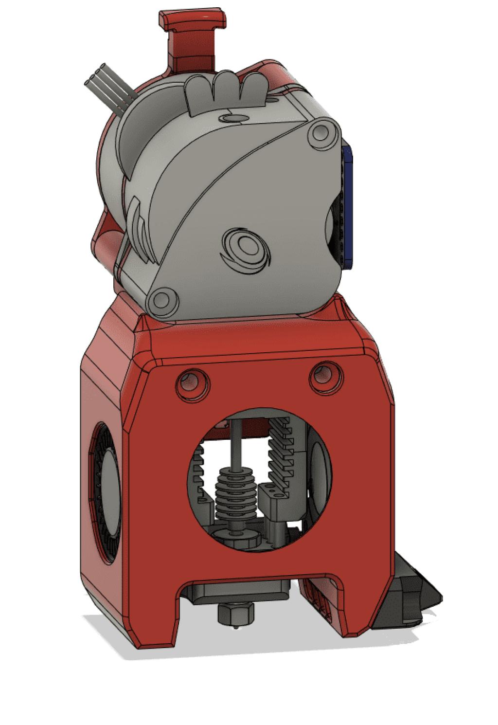

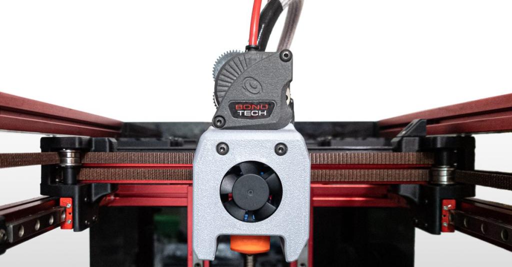

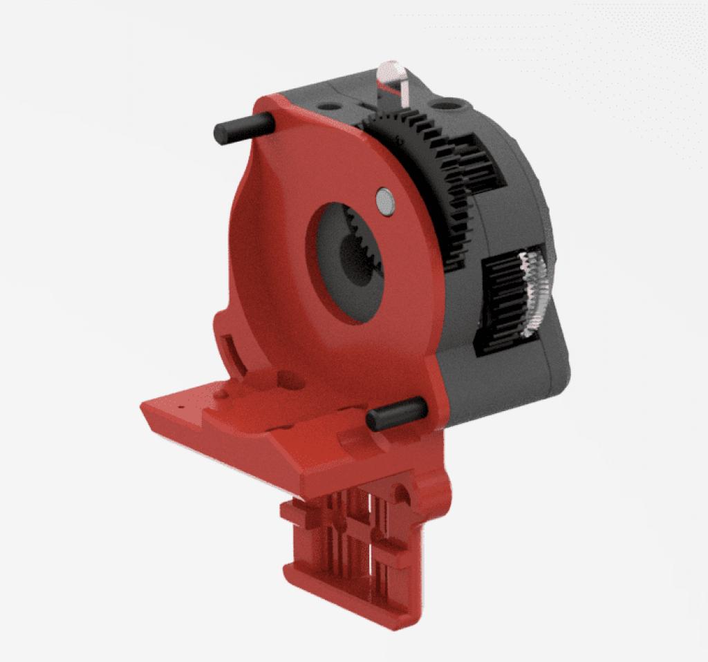

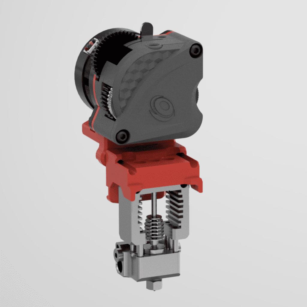

LGX Lite Toolhead Setup For Voron V0.1
AN ALTERNATIVE TO THE VORON ORIGINAL SETUP
The Mini After-LGX-Lite
Designed by Olof Ogland, based on a draft design by Nemgrea.

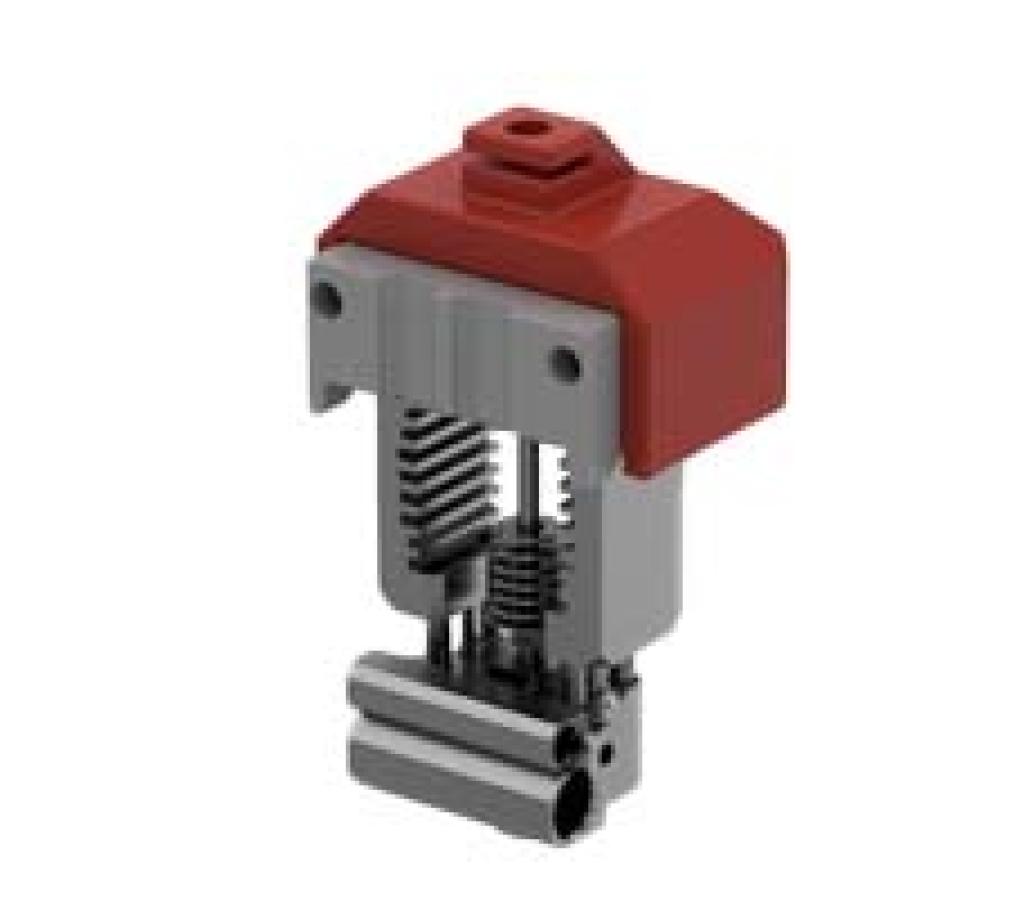

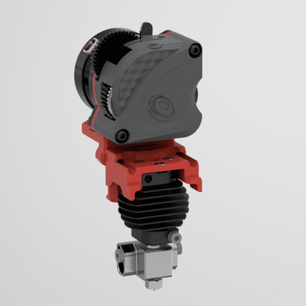

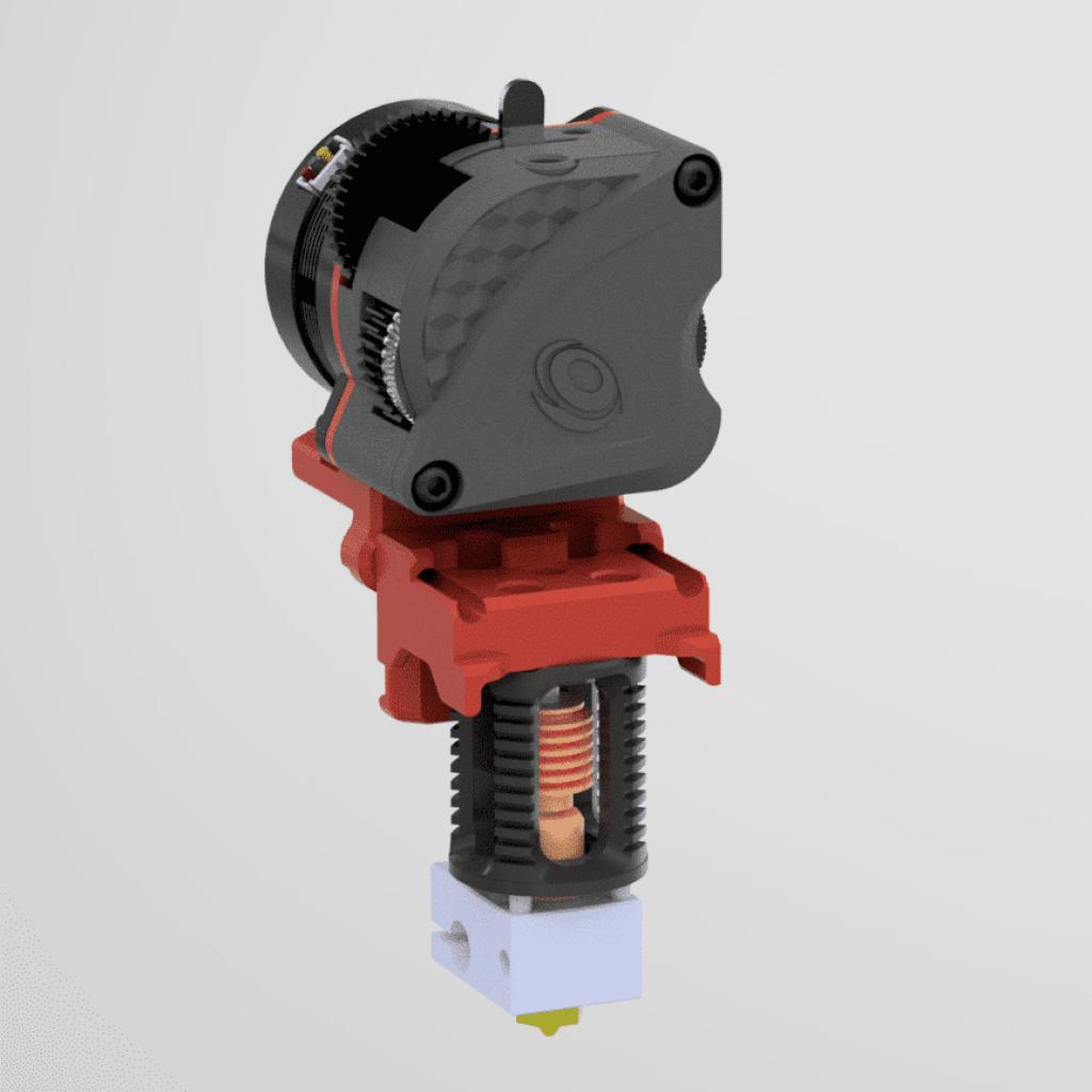

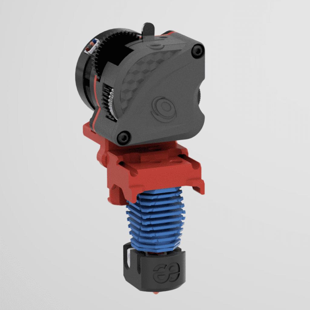

This project also includes:
- Mounts for several hotends;
- AdaFruit and Generic ADXL345 accelerometer mounts – for Klipper’s input shaping tuning;
- Z-axis Bed Adjustable Y offset set – to allow the print bed to move back and forth from -1 up to 3.5 mm.
- Klicky – a z-probe mount that attaches with magnets

Mini After-LGX-lite
Most screws required to perform the installation should be already on your kit. You may need some additional sizes and types. The following list identifies them:
- 2x M3x6 BHCS for belts
- 2x M3x30 BHCS for LGX Lite
- 4x M2.5×6 low profile for Copperhead
- 2x M3x10 BHCS LGX Lite to cowling
