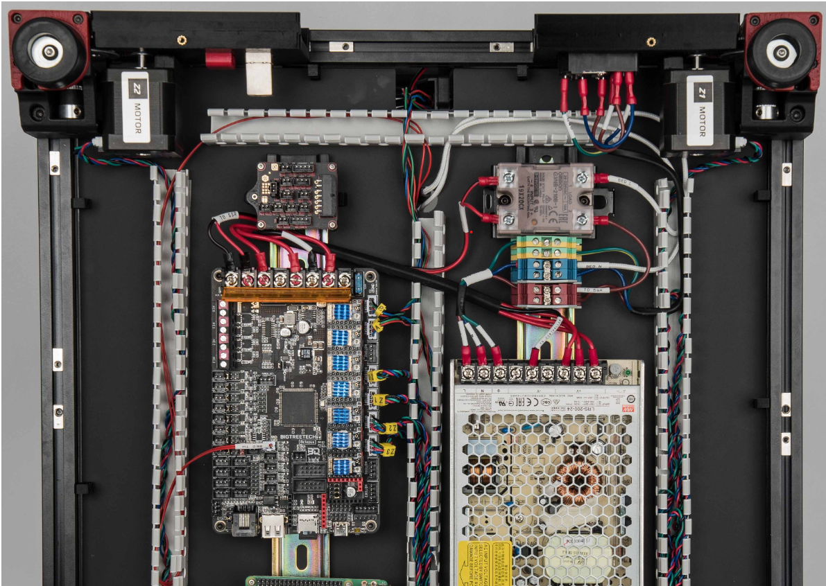

Seperated high voltage from signal wiring. Motor wires and stuff that won't change is separate, too. Everything else sits in open cable ducts for quick access and ease of changing things.© fristle

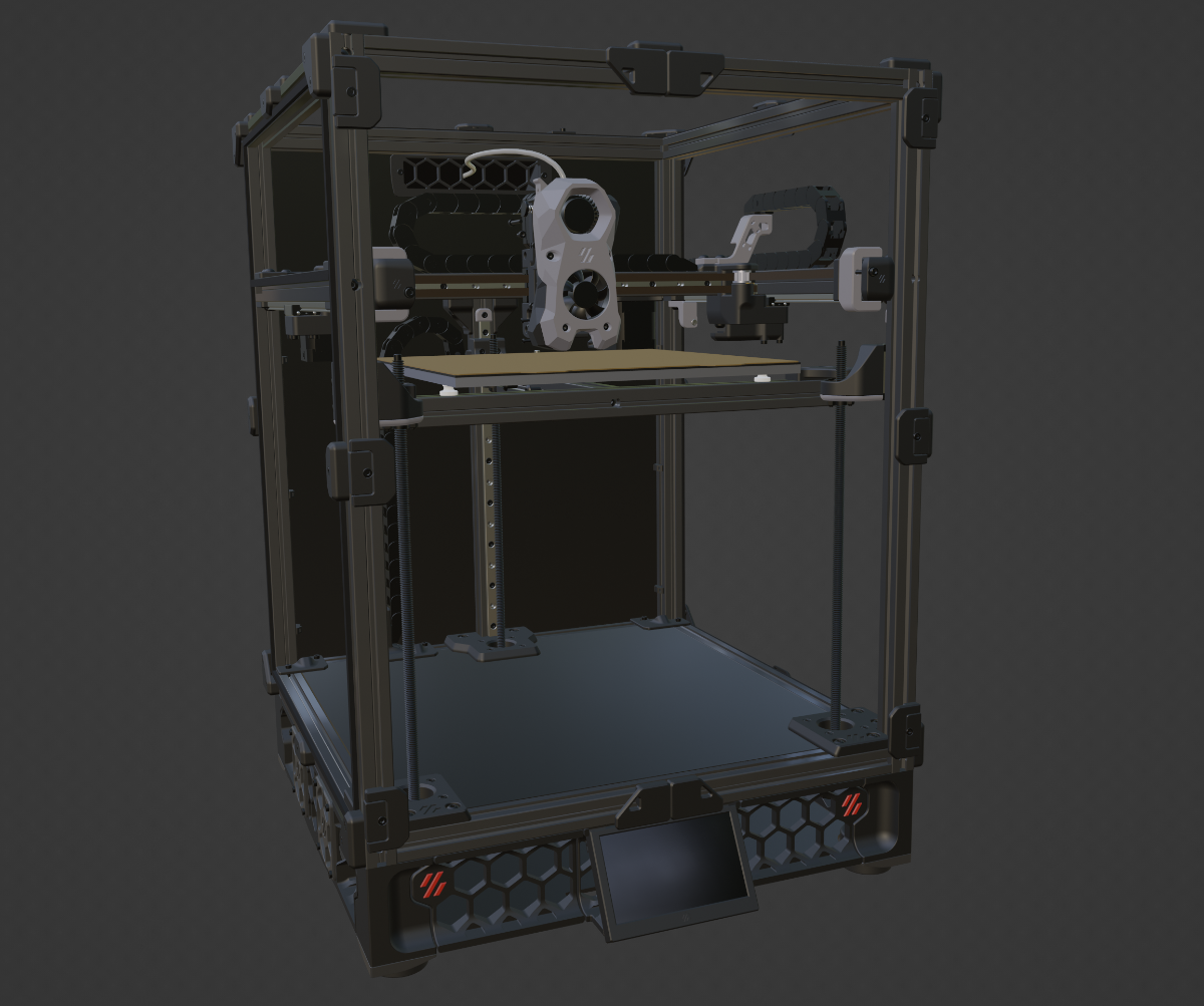

Hello everyone, This is my second Voron printer build, my first being a Voron0 which has been a fantastic little printer. But I needed something a little larger, so I ended up buying a LDO Trident kit. I wanted to visualize the colour scheme of my new Trident a little better than I did with my V0 build. I know there are a few good web based colour configurators for Voron's out there but I needed a little more control. As I know my way around blender quite well and Fusion360 feels quite unfamiliar to me, I ended up importing the cad model (exported as stl) into blender and colouring as needed. Anyway, I have decided on quite a dark scheme with a touch of Voron red. Will post some 'real' build photo's soon.

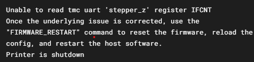

Hello Everyone! I'm building my first Voron 2.4 r2 LDO 350 kit with an Octopus 1.1 board, mainsail OS. I am getting hit with this error: I've followed the LDO wiring docs for this board found here:https://docs.ldomotors.com/en/voron/voron2/wiring_guide_rev_a It seems like the motors are not getting power. Pretty sure that im doing something silly, just not experienced enough to know what yet. for what its worth, the bed heater and rapido hf hotend DID heat up (yay, small win). (screenshot of documentation, but my board is wired the exact same way, just not a clean.) Does anyone have any thoughts? Happy to provide more info if needed! Sincere thanks in advance! Shifty

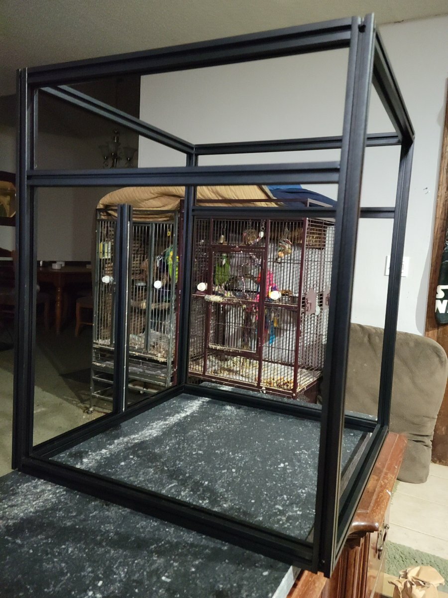

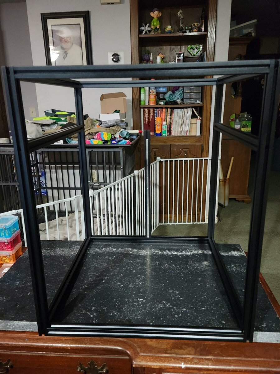

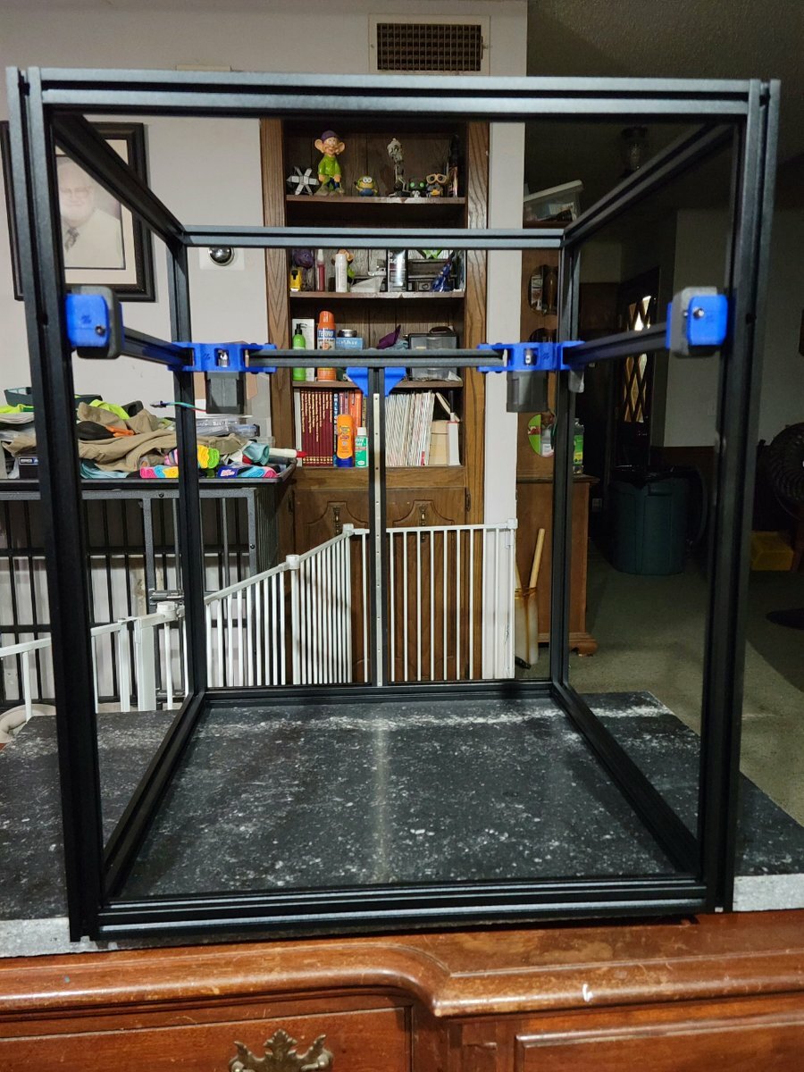

Day one Finally got off my butt and got my kit build started. Didn't get really far. Working on it while trying to get some other projects done, so you'll have to pardon the mess. Got frame done. Only had to take it apart 3 times. Had one extrusion facing the wrong way, forgot to install Y rails, and forgot to install nutbars. Everything checked out square in the end though. Following the manual and Steve Builds YouTube series. First build, so I'm doing it step by step. Trying to make sure I miss as much as possible, that worked out well the first day, lol. Had to stop, because I forgot to clean and prep linear rails ahead of time. I'll work some more on it tomorrow hopefully. Will try to take pics when I remember.
