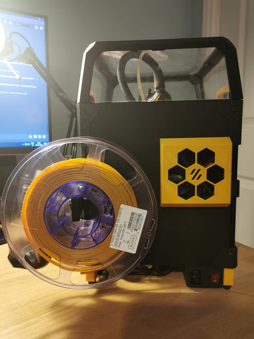

This is a simple and yet overkill electronics cooling solution originally intended for the Voron Zero however could also be installed on any printer with a solid panel covering the electronics area.

- 1x modified electronics back panel
- 1x printed fan cover
use the dxf and a laser cutter at your local makerspace to produce the holes in the panel or print it out and use it as a template to do it manually. If enough people express interest Funnsor said they would stock some panels so drop me a message if you would want to buy in a whole new panel instead of modifying your old one.
Install m3 inserts in the printed fan cover
Poke wire through the hole and then attach fan and cover to the outside of the panel using the m3 screws.
