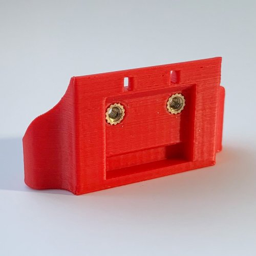

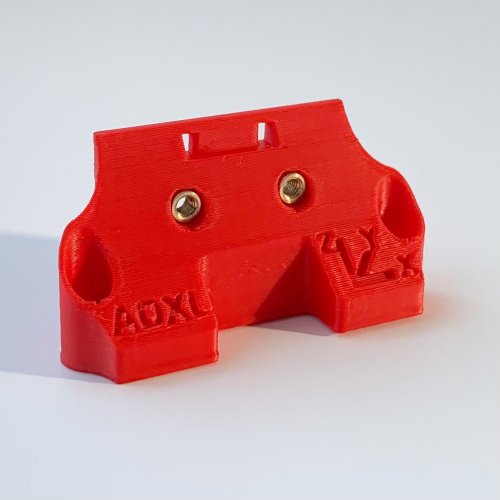

Bom
- 2x heat insert m3
- 2mm wide zip-tie

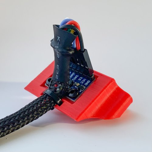

Improvement
Added a cable strain-relief

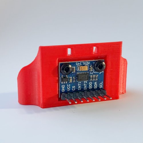

Description
I really liked the adxl mount posted in the voronuser_mods channel by 3DP MAMSIH. Thanks to Th3FalleN it was modified to have heat-set inserts. I added the possibility to fix the cable to the mount, so it does not need to hang directly from the adxl pin headers.
