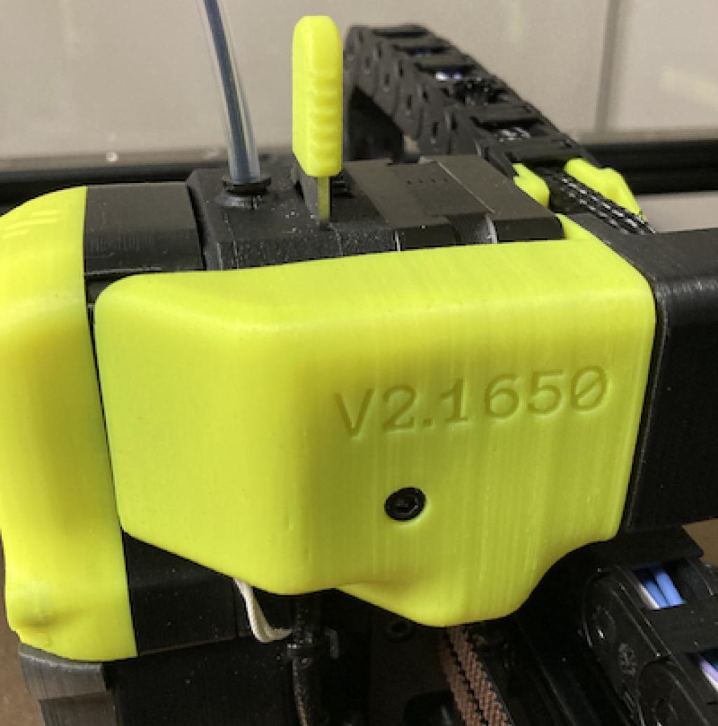

LGX Cable Cover
Besides the mounting parts, most people end up asking about a cable cover. There are a few posted around Discord, but after seeing Craxoor's PCB cover I designed a similar cover from scratch for use with the LGX. Note that this cover does not work with the toolhead PCB - it just looks similar.

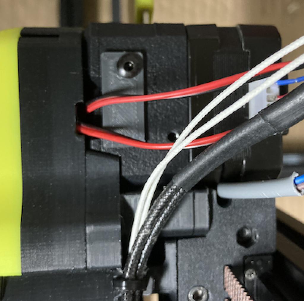

LGX Gear Cover
A little cover for the Large Gears on the LGX so it doesn't chew through the fan wires.

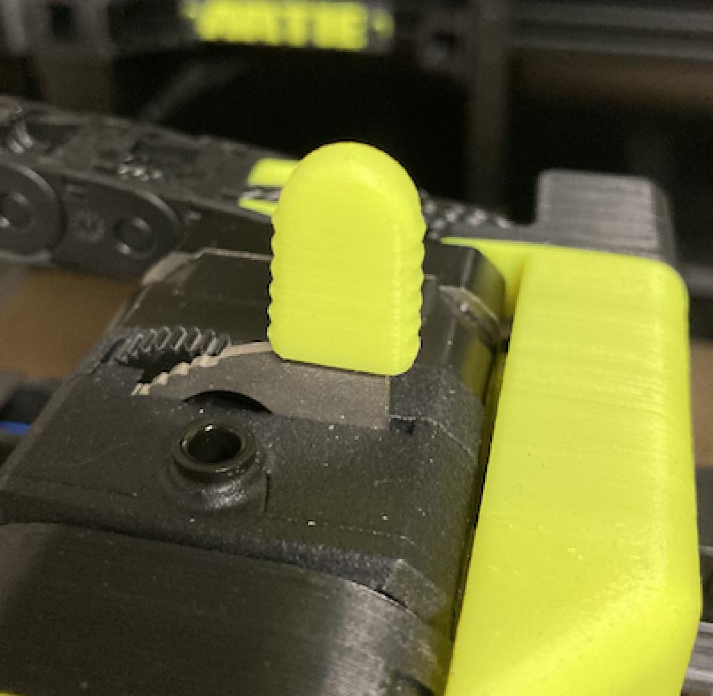

LGX Lever Cover
Drop-in replacement for the filament pre-tension lever, in case you want a different color:
