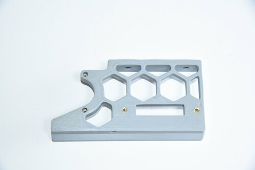

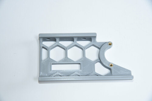

In my travels upgrading Anycubic mega-S printers, I created a sdcard socket mount for the cabinet to plug into a MKS Robin Nano control board. I remixed my design to add the same functionality in my Voron 2.4r2 300mm build. I can create other skirt mods if there is interest.
printed parts
- right skirt with sdcard socket modification

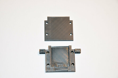

- sdcard mount
- sdcard cover

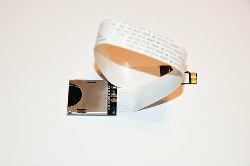

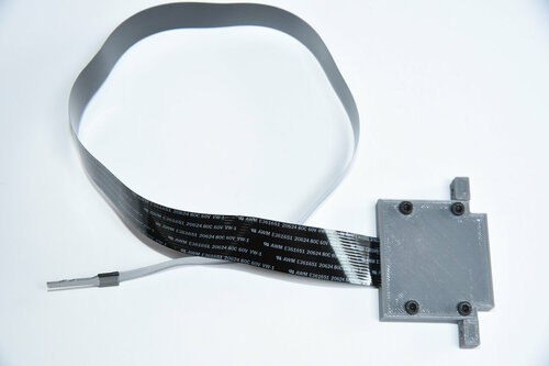

- sdcard extension cable
You do need a micro sdcard to sdcard extension cable. I picked up mine on Amazon made by Lanmu. It is a 500mm long extension cable and works well with the hardware positioning that I did for my machine. They do make a 250mm also which may work better for some installations. All you need to do is remove the plastic end cover for installation in the mount I designed.
