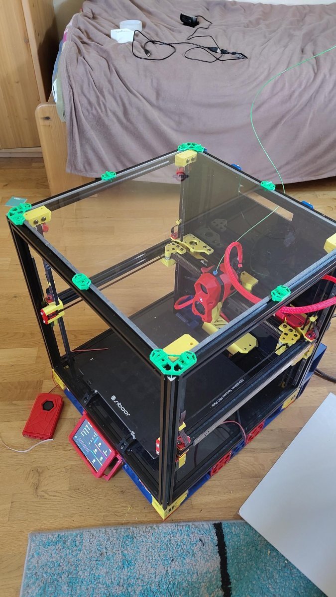

Project 24: Voron 2.4 300mm 'Knuba 3Dubba' - Siboor Aug 2023 Cartographer Kit
Manux

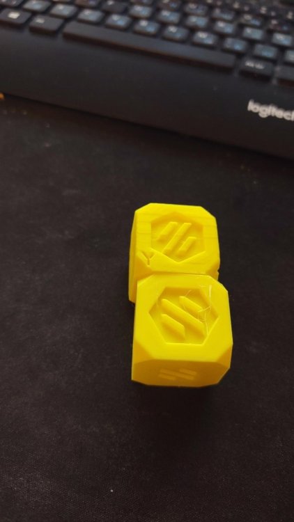

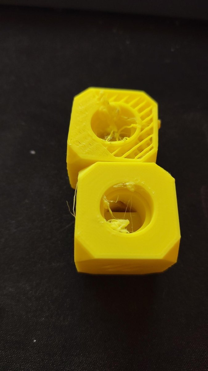

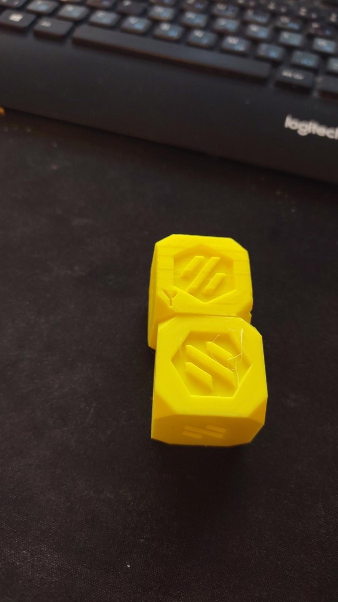

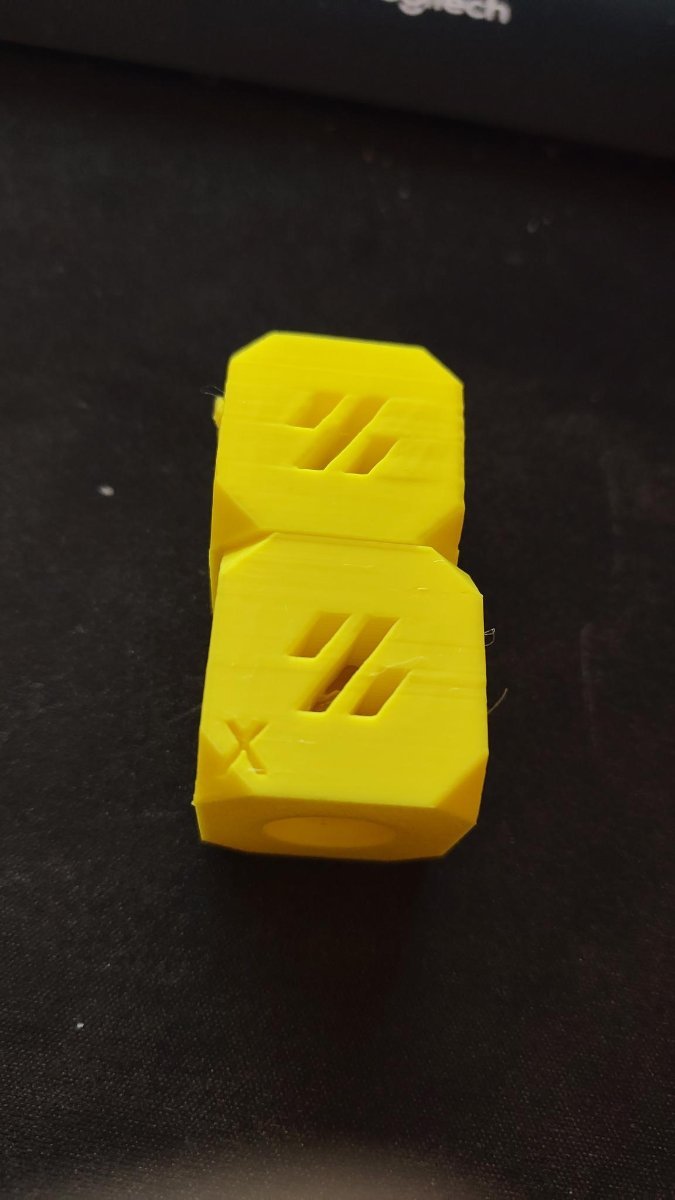

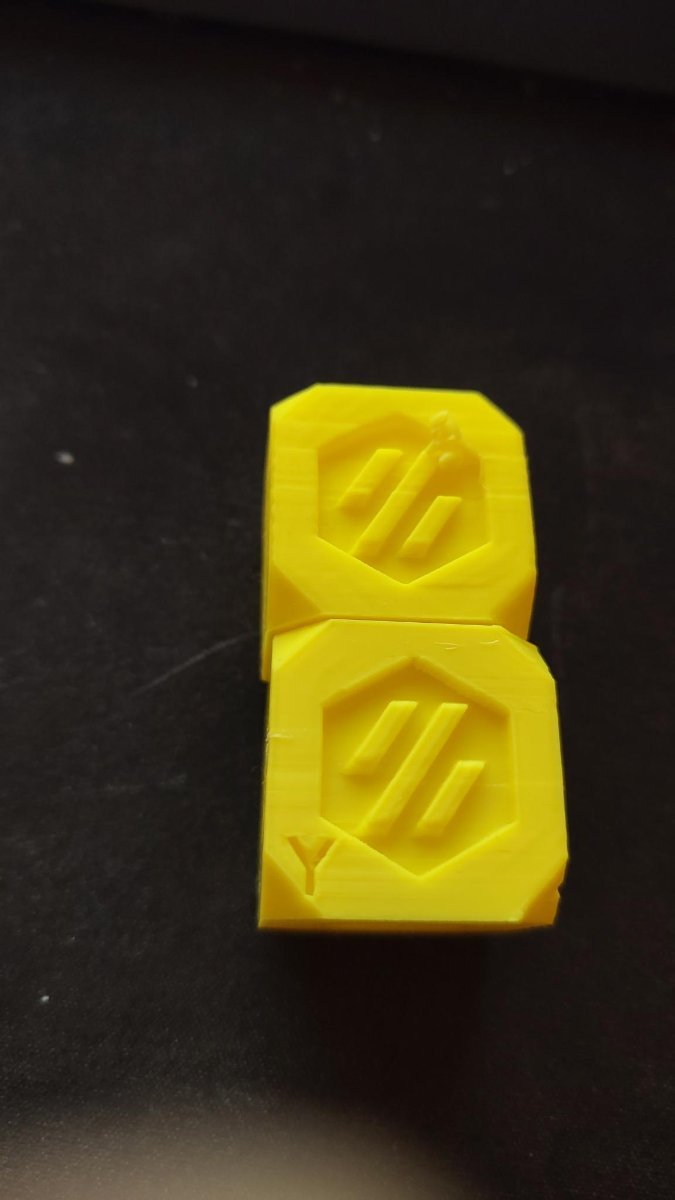

First round of calibration
I'm quite happy with these results. Did Elis Guide and the Calibration prints from Orcaslicer.
Still to go Input Shaper and VFAs testprints.
There is some buildup of filament on the cube but im not sure where it could be from. TOP looks marvelous.
I also did the MAX Flow test and the Dragon HF Hotend with a result of 20 with a CHT Nozzle.

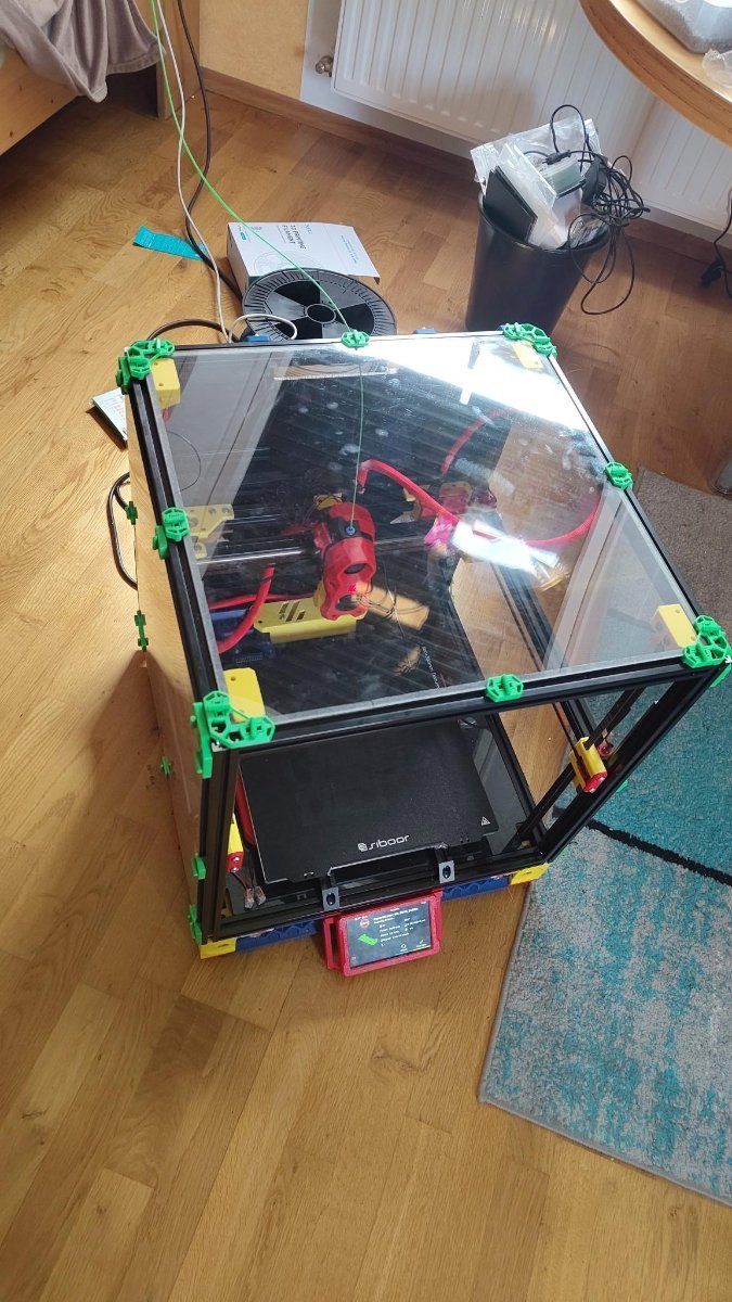

Here are some pics, This is more voron like 🙂

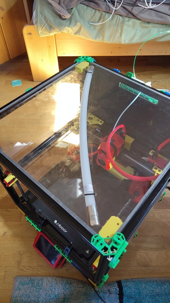

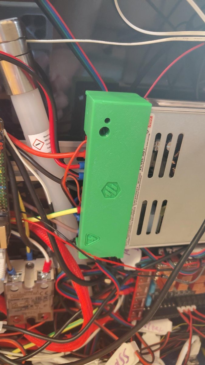

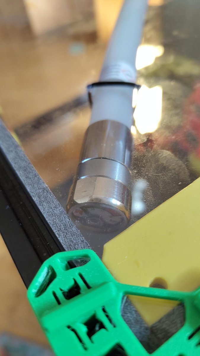

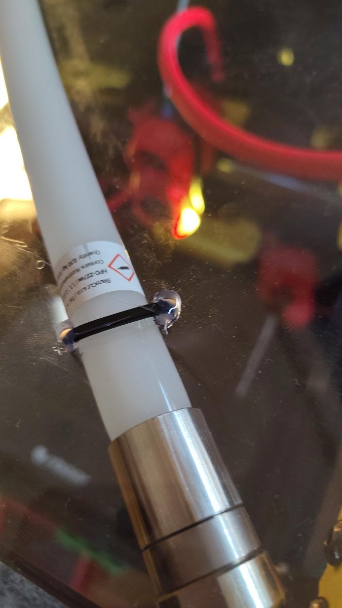

BlazeCut fire supression
I mounted the Blazecut fire suppression tube near the mains with the Omron relay, PSU main and Octopuss mains. I think that a good location.
I secured it with a zip tie to another zip tie that is mounted on the PSU.
Hope i never need it!

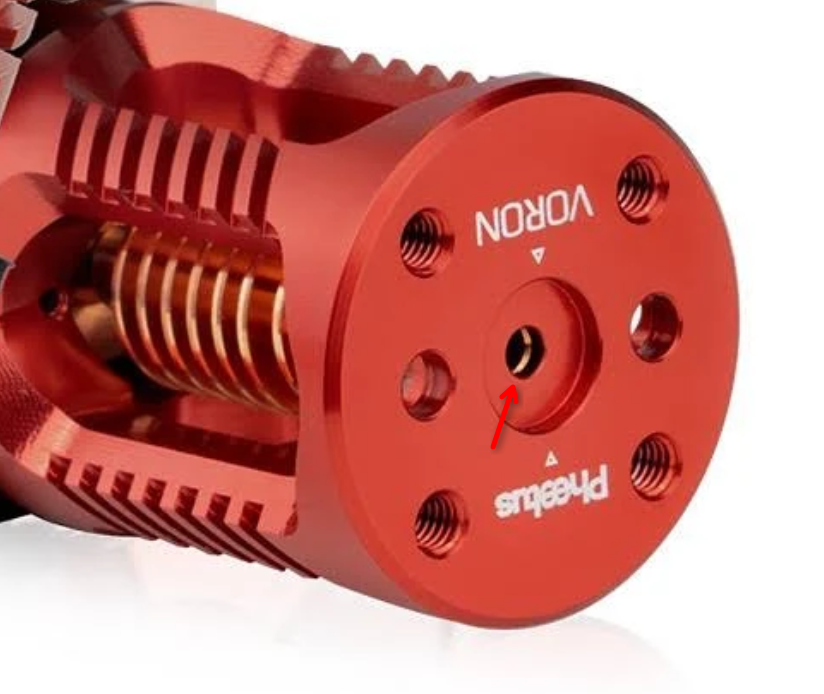

Hotend Serviceability
Others will know it but i had to service the Hotend, because i did not tighten the nozzle fully.
The SB Hotend is quite easy to service, 6 screws its all it took i would say that is Prusa MK3/MK4 level of servicing.
In the end nothing was wrong the problem is with the Dragon HF Hotend. The opening is not like a funnel but just a hole. So the filament has difficulty entering. I should have used a drill to make it better but i could not be bothered this time..
If you are reading this before building make sure to drill the hole a bit of the heatsink tower to have easier filament loading.

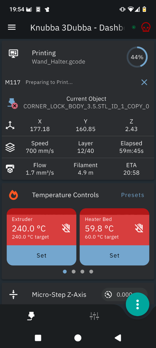

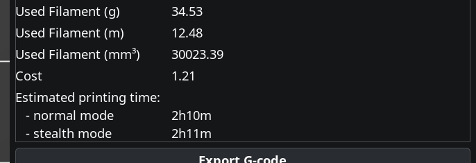

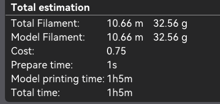

Speed gains
Here is my old Prusa MK 3.5 vs the Siboor:
Prusa:
Siboor:
A solid improvment!
 Same model and Infill of course.
Edited by Manux

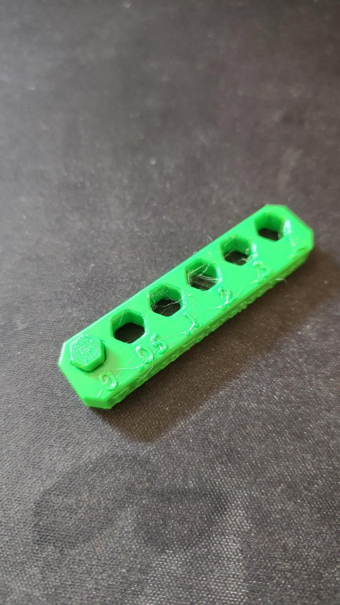

Tolerances
The tolerances are fucking amazing! This just fits.
On my Prusa i had 0.1 to 0.2 depending on filament which meant i had to calculate this into my designs from the start.
This is just amazing😍💯

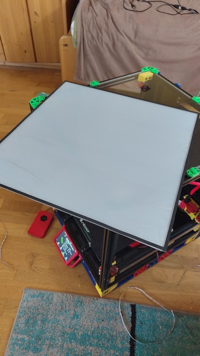

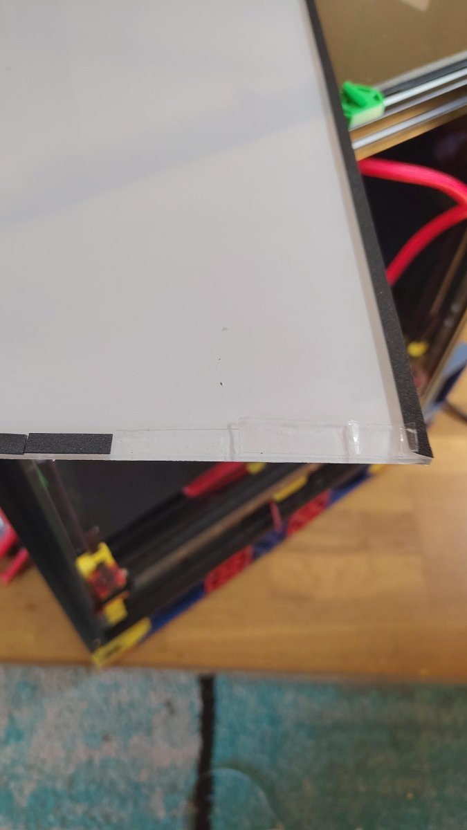

Side Panels
I mounted the side panels with Annex clips. I use 3.5mm Annex clips for 3mm panel and 1mm soft strip.
Sadly Siboor delivered strip was not long enough.. But i had some tape laying around...

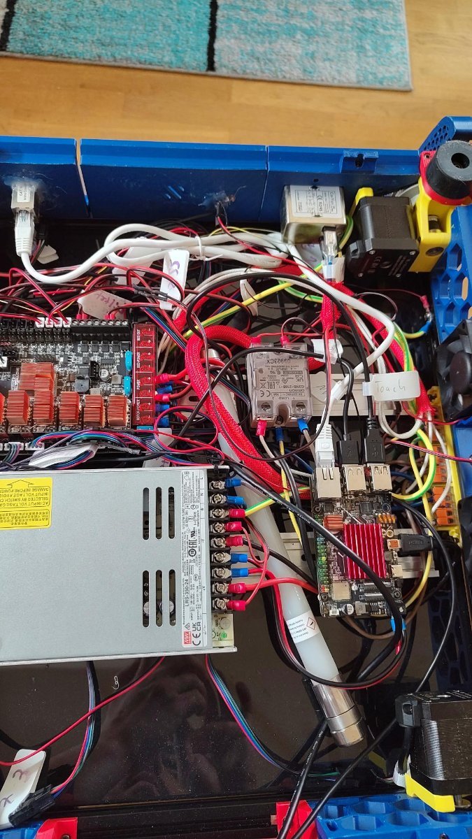

Octoprint Everywhere
I setup octoprint everywhere as it is free and has AI print failure detection. I quite like it as it is also working together with Mobileraker and i can watch my prints on the go with this.

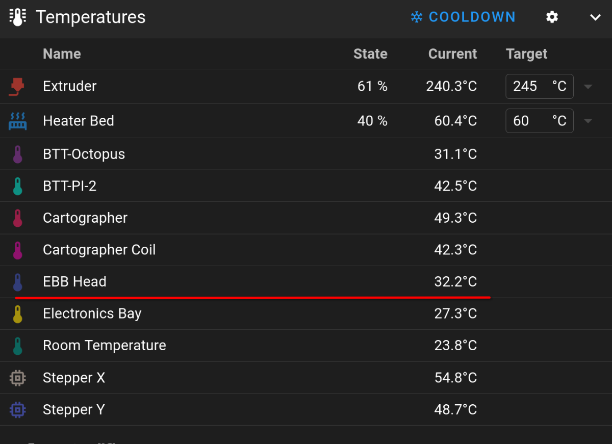

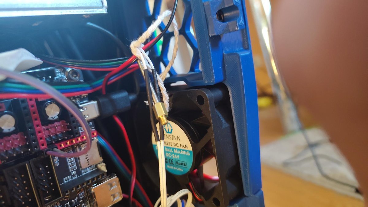

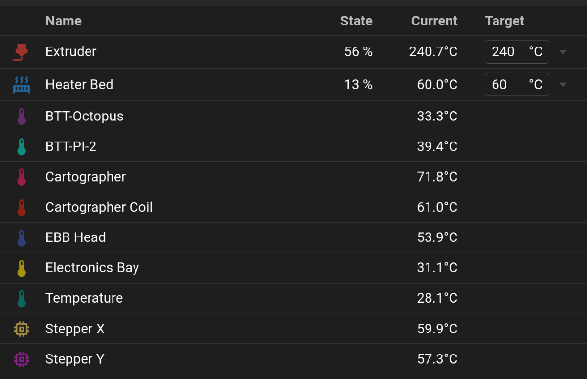

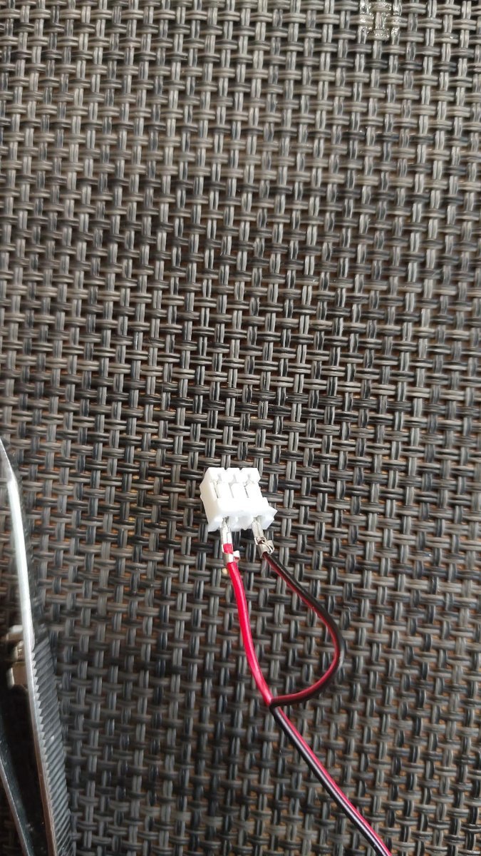

More Sensors
I has two sendors laying around from my prusa modding so i used them on the voron. One near the intake fans for room temp and the other on the blasecut tube to messure heat in the electronics bay.
I used the standard octopus thermistor plugs for it.
Room temp sensor suspended in the intake air flow.
Plugged in to the octopuss board.

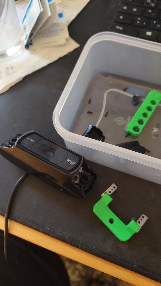

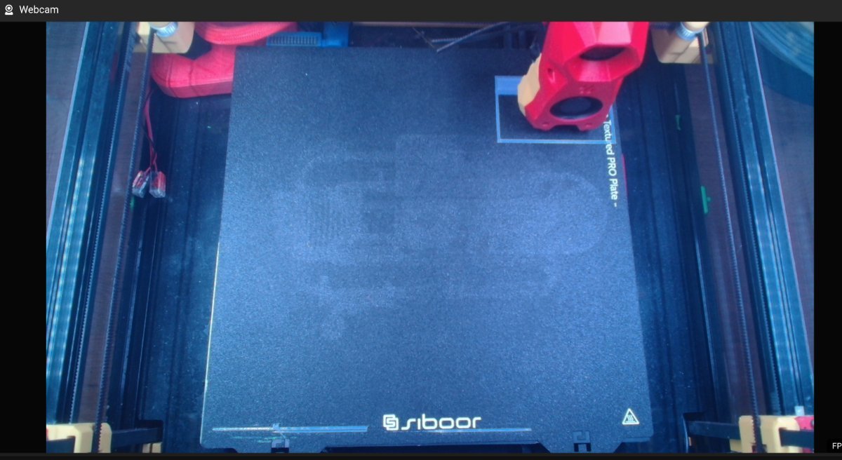

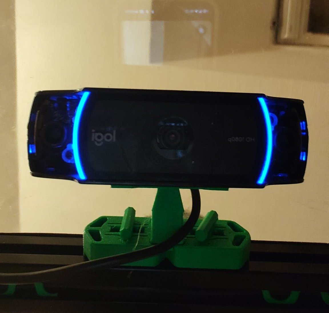

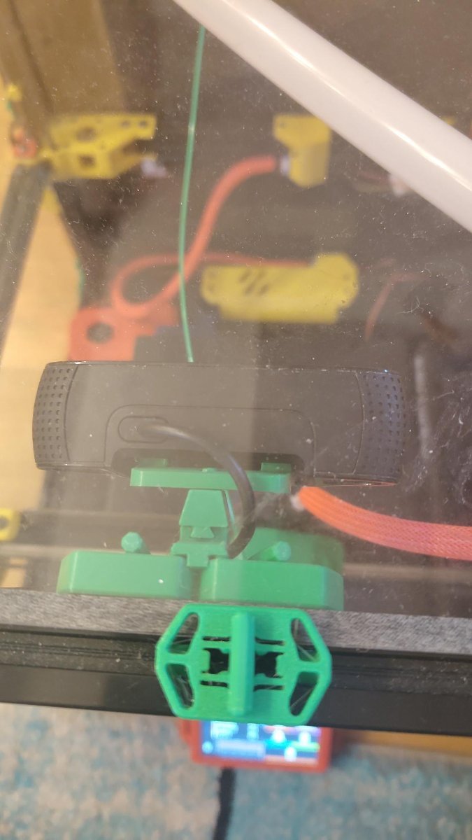

Camera
At the moment i'm working on a cam mod for the Logitech 920 mount.
I want it on the front 2020 extrusion and i got a holder jerry rigged but i will post more when i get there....
I used this design from Crambambuli as a base: https://www.printables.com/model/86224-voron-v24-3003-c920-gantry-2020-mount
For the internal mount, and then remade some annex clips into a holder. Now i get a good Cam picture.
signal-2026-06-08-205116.thumb.jpeg.1450215b74c48d8a7d39a0e4ee781f03.jpegsignal-2026-06-08-205103.thumb.jpeg.9b9878018e5a8fc009b242a210fb0897.jpegsignal-2026-05-28-173146.thumb.jpeg.8046c8c8808bd7661f4721faf2b4fc50.jpegsignal-2026-06-08-220622.thumb.jpeg.63ed9cf0a4e7d4fb80666f4d15823cf1.jpegScreenshot_20260611_204540.thumb.jpg.b58d9630ab1e02d291b759a6712abf60.jpg

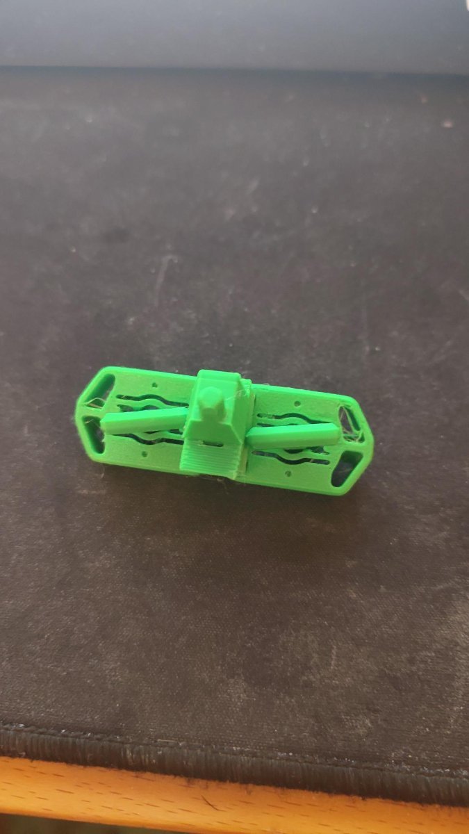

Here are the STL Files:
Snap-Fit_test_key_v1.stl
Snap-Fit_test_part_cam_v7.stl
Snap-Fit_test_part_holder_v6.stl
Snap-Fit_test_part_extrusion_v2.stl
Use PETG and tree support. Also you dont need glue but of course u can..
Edited by Manux

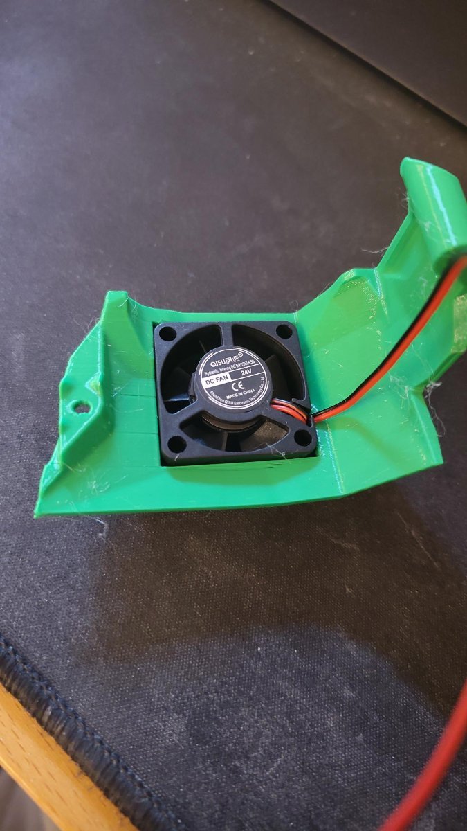

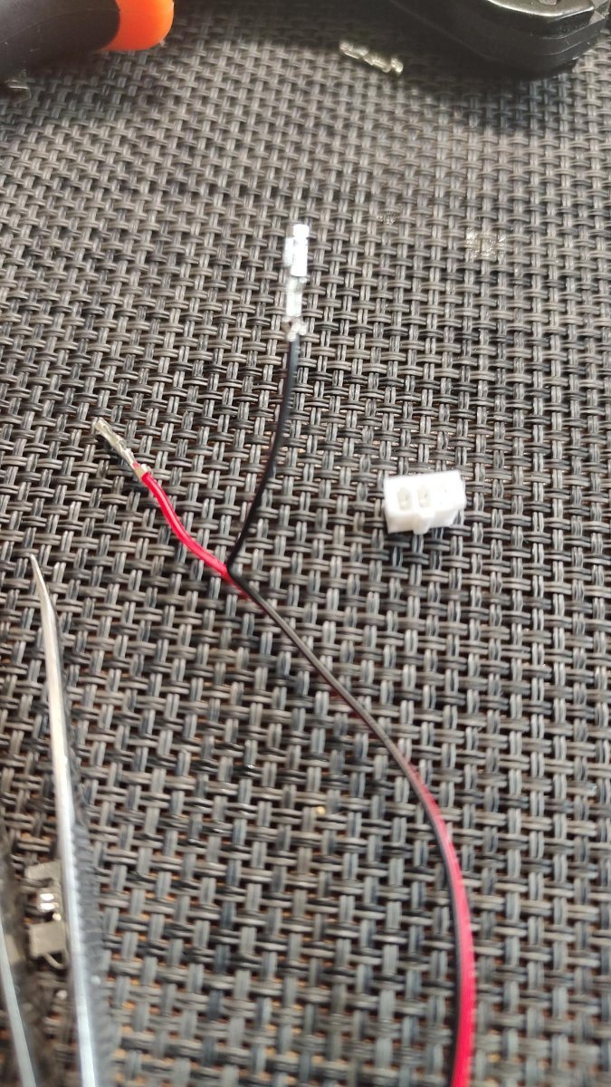

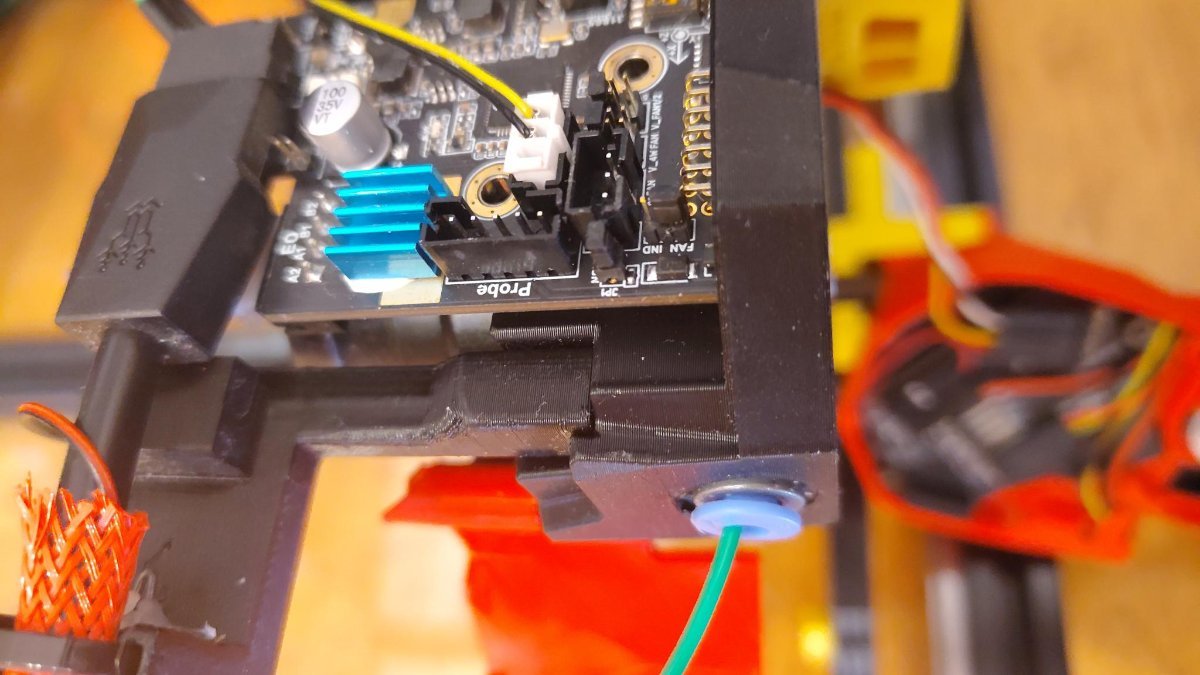

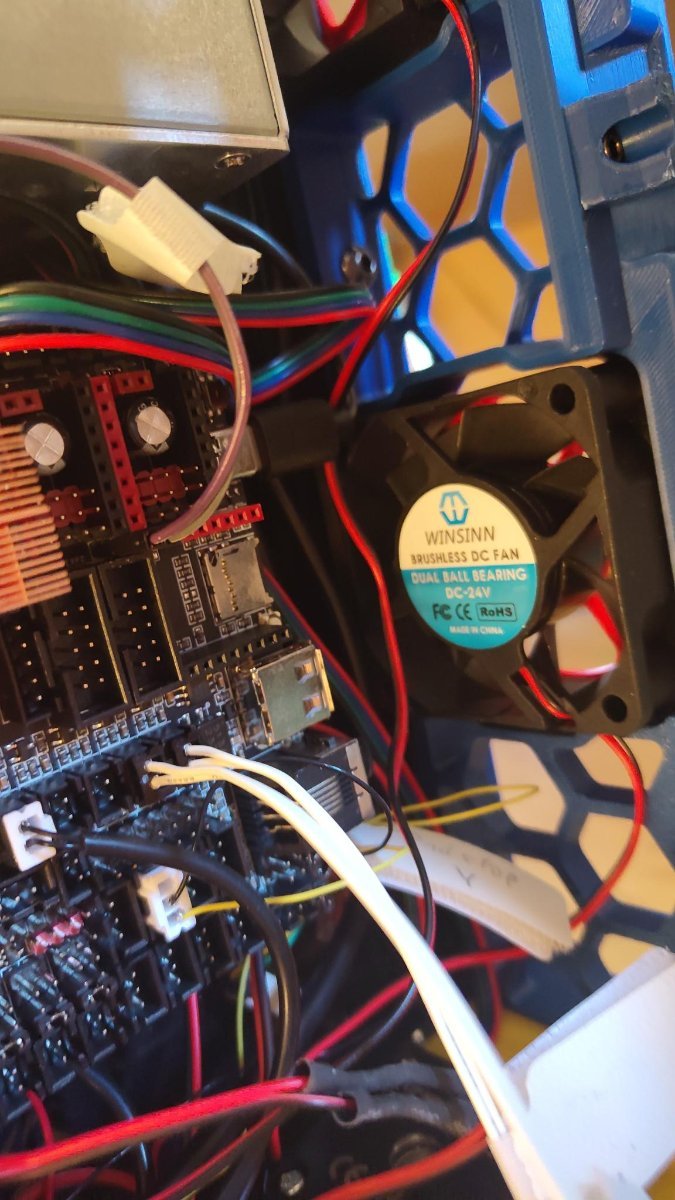

Better fan on the SB2209
As you know i added a 25mm fan on the Galileo 2 Extruder Cover to cool the SB board. It did its job an kept it around 50 degrees but i wired it to the Probe Connector pins, 5v and Gnd. So it was always on when the printer is powerd up not just printing. Which was annoying to me.
I looked around and there is not too many info but you can Jumper the SB2209 so it uses a 24v FAN on the Induction Probe Connector (not the normal one!).
The clue is to wire Ground to the GPIO PIN and VIN onto VIN. Then you can control it with printer.cfg.
I used a 30mm, 24v fan for this.
More info here: https://www.reddit.com/r/VORONDesign/comments/1flee2k/adding_a_fan_to_sb2209/?share_id=Zm7BeqQqyEJTyR3HGms30&utm_medium=android_app&utm_name=androidcss&utm_source=share&utm_term=20
You have to jumper the SBBoard tho like this (to FAN):
- Warning the jumper is very very tiny
Also i had to crimp some wires from the 24v fan:
signal-2026-06-08-184044.thumb.jpeg.341492431ce5de61553bf452903dc903.jpegsignal-2026-06-08-184238.thumb.jpeg.cecc96fc3206b0d752634226c478891d.jpeg
End result:
Printer.cfg:
# SB2209 auxiliary board cooling fan on GPIO6 (IND/CNC header)
# Wiring:
#   Red  -> VIN (+24V)
#   Black -> GPIO6 (switched ground)
# Control:
#   SET_FAN_SPEED FAN=sb2209_cooling SPEED=1.0
[heater_fan EBB_SB2209_Fan]
pin: EBBCan:gpio6
max_power: 1.0
kick_start_time: 0.5
off_below: 0.10
heater: extruder
heater_temp: 50.0
Now it only turns on when the hotend is running and it keeps it crispy cool at 30 degrees...
