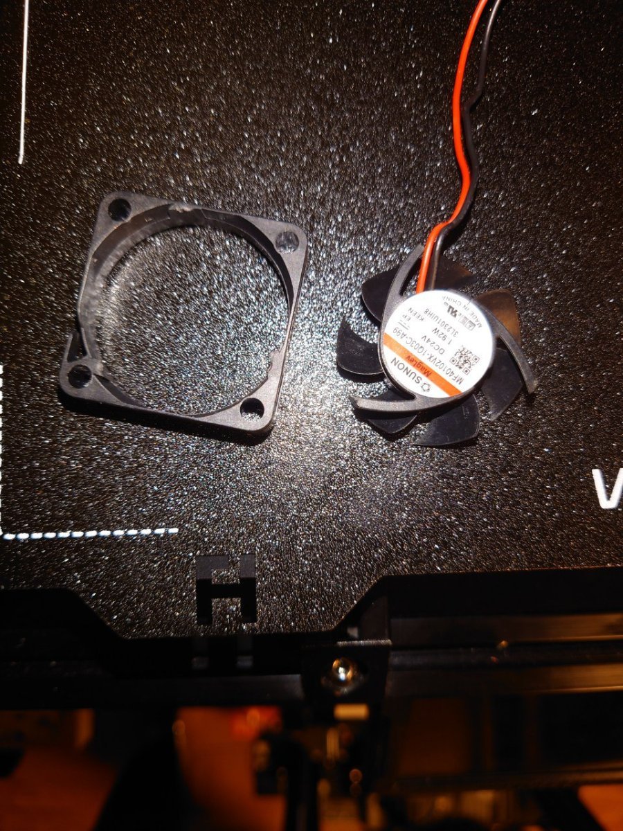

As promised, I put printer on its rightful place, and decided to check hotend LEDs connections. All seemed good, so I put hotend fan back, but did it wrong side. "No big deal", I thought and pushed it out, turned over and pushed back in place. Well, I broke a structural "rib", and because sunon fan have very thin plastic, it jammed blades, and hotend fan didn't work. And I got a clog. And then when trying to find out what happened, I broke fan completely. New fan came only Wednesday evening.

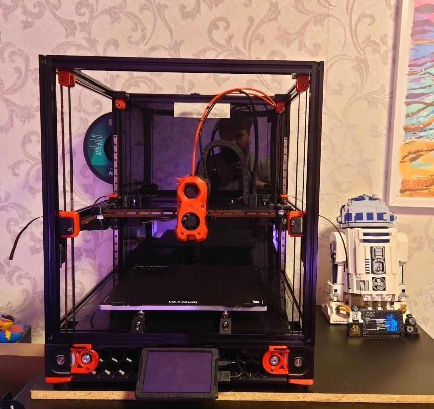

I configured input shaping, first level squish and pressure advance and started printing. And it's awesome. Still need to play with retraction, speeds and accelerations, but prints already come out with excellent quality without  much effort. Only thing that I struggle with is preheating bed for five or so minutes (with 220v it heats up very fast) before print start. I guess, I'll set up a macro for this. Shouldn't be hard.
This weekend will adjust belts tension, and continue with Ellis' tuning guide concerning retractions and speeds - I want to go as fast as possible with best quality. Don't get me wrong, this beast is already fast. But I have a feeling that it is possible to go faster.
And here is short video: https://youtu.be/kDT1SYUyZlo
Now, to problems. "Resume" macros doesn't work properly, so need to fix it. It is annoying that I can pause print, but can't resume it. Controller fans are loud. I'm ok with loud fans, but they not only loud, but they loud with very high whining. Already ordered two new fans for replacement. And that's it for problems with printer, actually. There is stuff that I want to do (brush mod, load/unload macros and so on), but for now it's already awesome. And with way less hustle than Ender was.
Looks  great 😃

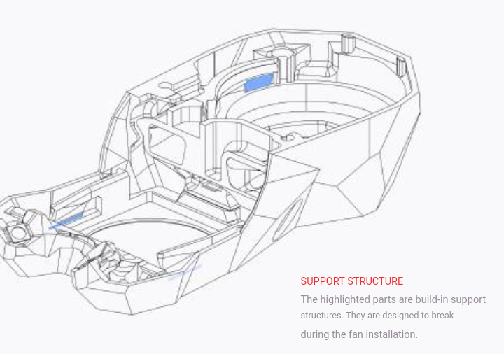

You know that some parts in the stealthburner are supposed to break when you insert the fan? 🙂
See attachment.
First assembly went great. It was my carelessness, inattentiveness and brute force that broke the fan.
