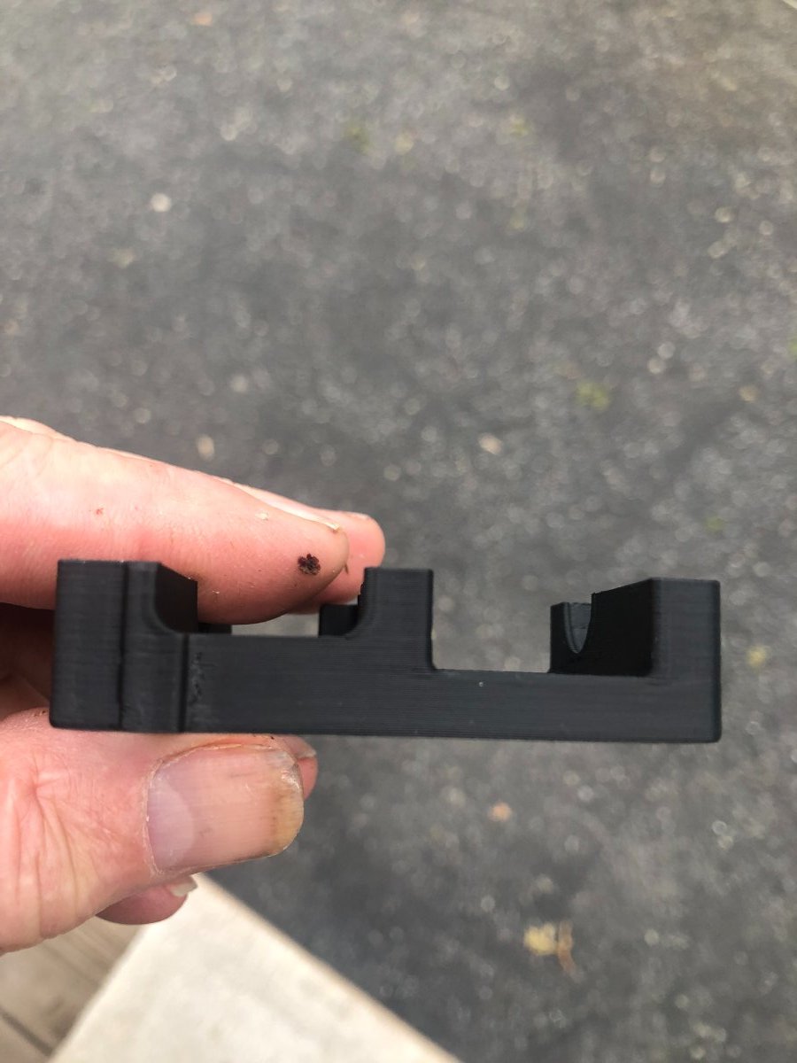

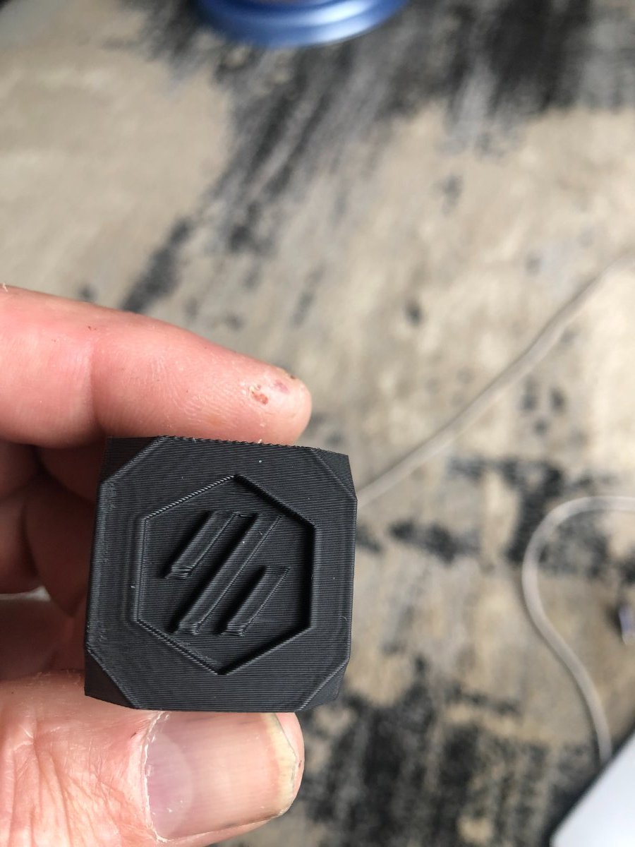

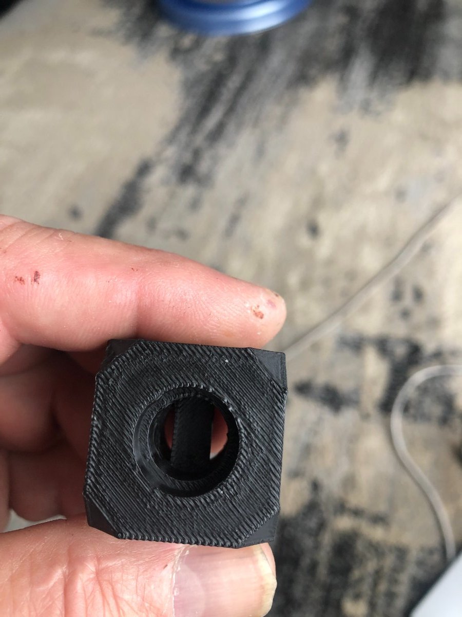

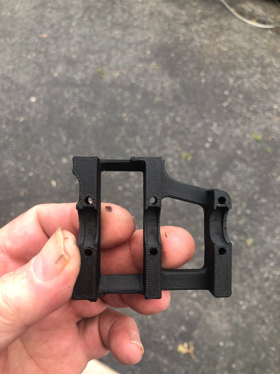

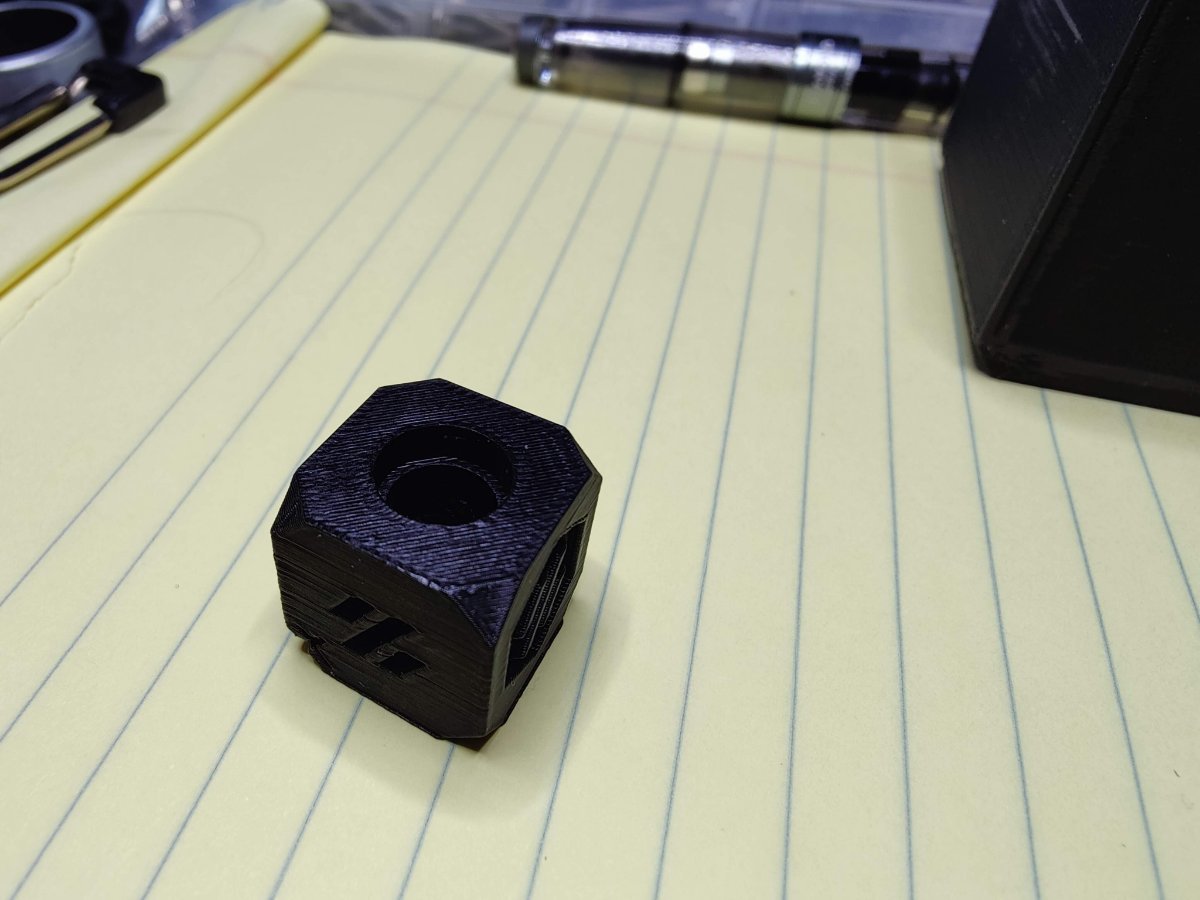

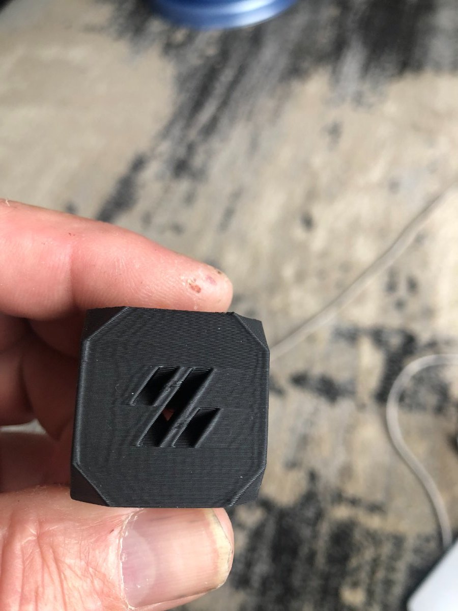

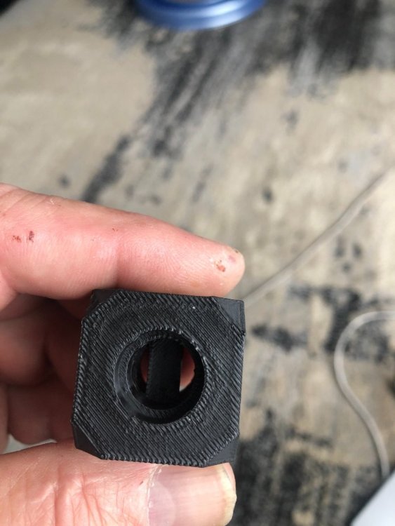

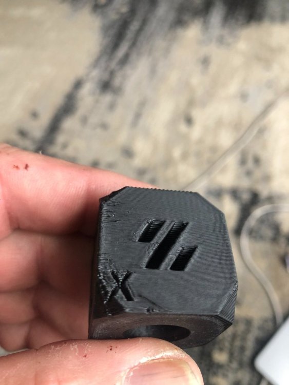

So it was definitely the seam causing the artifacts. Return the seam to the rear and enabled "retract at layer change".  Still seem to be some wall scaring. Thoughts on the corners do I revisit pressure advance?
I was going to say check that your EM and PA calibrations are good. Have you run input shaper yet? How about cooling settings?
I just recently had to re-calibrate from scratch because somehow I managed to bork settings enough that I got lost. Grabbed Ellis' SuperSlicer settings as a baseline, then ran through his calibrations again. The printer is running better than ever now. One thing that's counter-intuitive because of common knowledge is how much cooling he runs on ABS. It makes a difference on the overhangs and bridging.

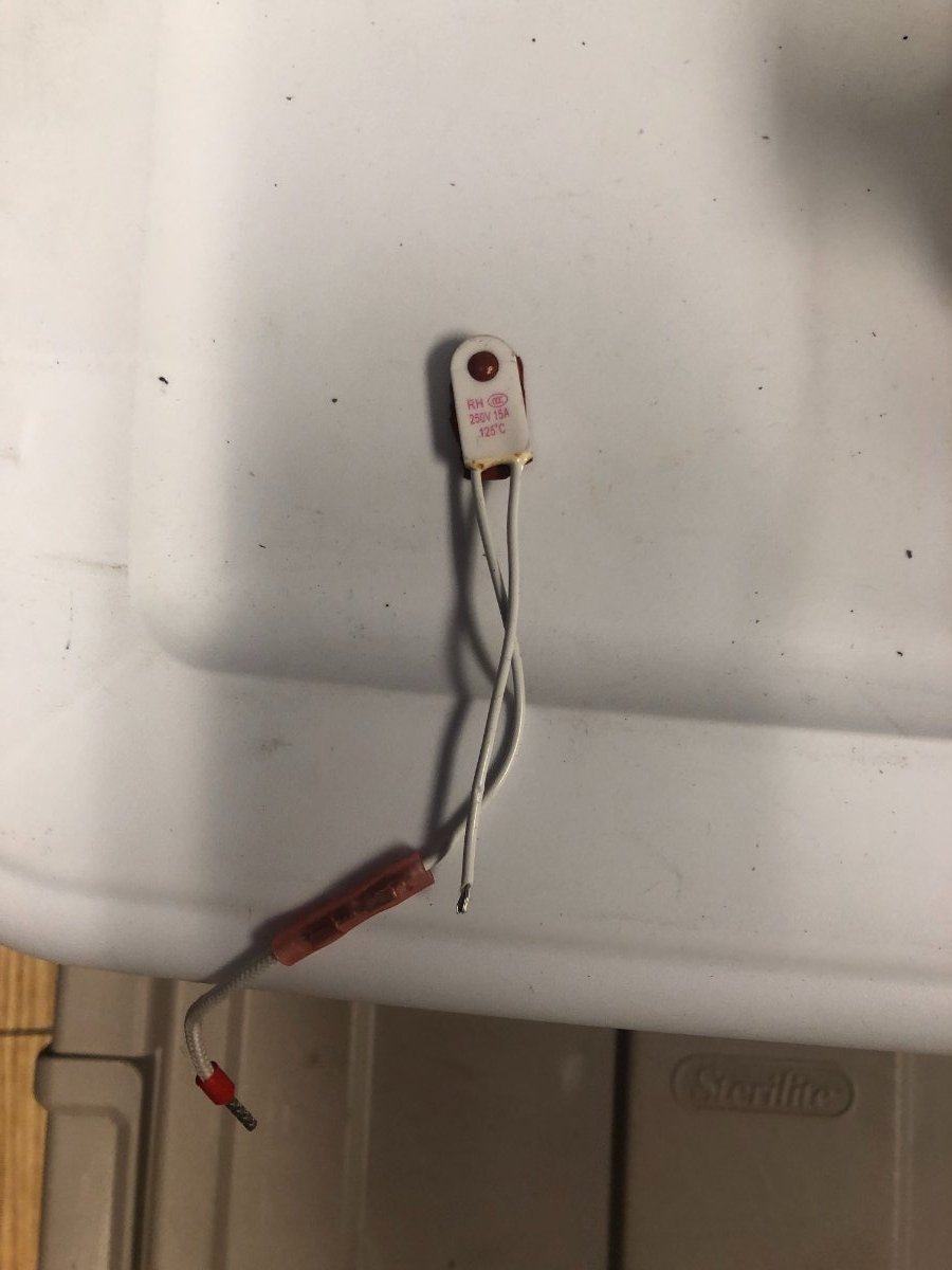

Out of the blue (WTF) right after a completed print, the thermal fuse on the bed gave up the ghost. ☹️ Bypassed for now till I get another one.
  • Sad 1
very close to a good end result I think, looking good already, yet to me it looks like somehow its stressed at some points.
cant really tell what this could be, and hard to tell without having the part in hand...
What is the speed you are printing at? and accel for inner/outer walls?
Looks really good overall. The top layer still looks a bit over extruded to me. Maybe a touch lower on the EM, maybe change the top infill extrusion width? I grabbed Ellis' SuperSlicer profile as my base & that uses 100% for top infill. I get super clean top layers now.
For ABS I took the advice Andrew Ellis provides and bumped my cooling up. 50% in general, 80% for a single part. It did help with overhangs and bridging.

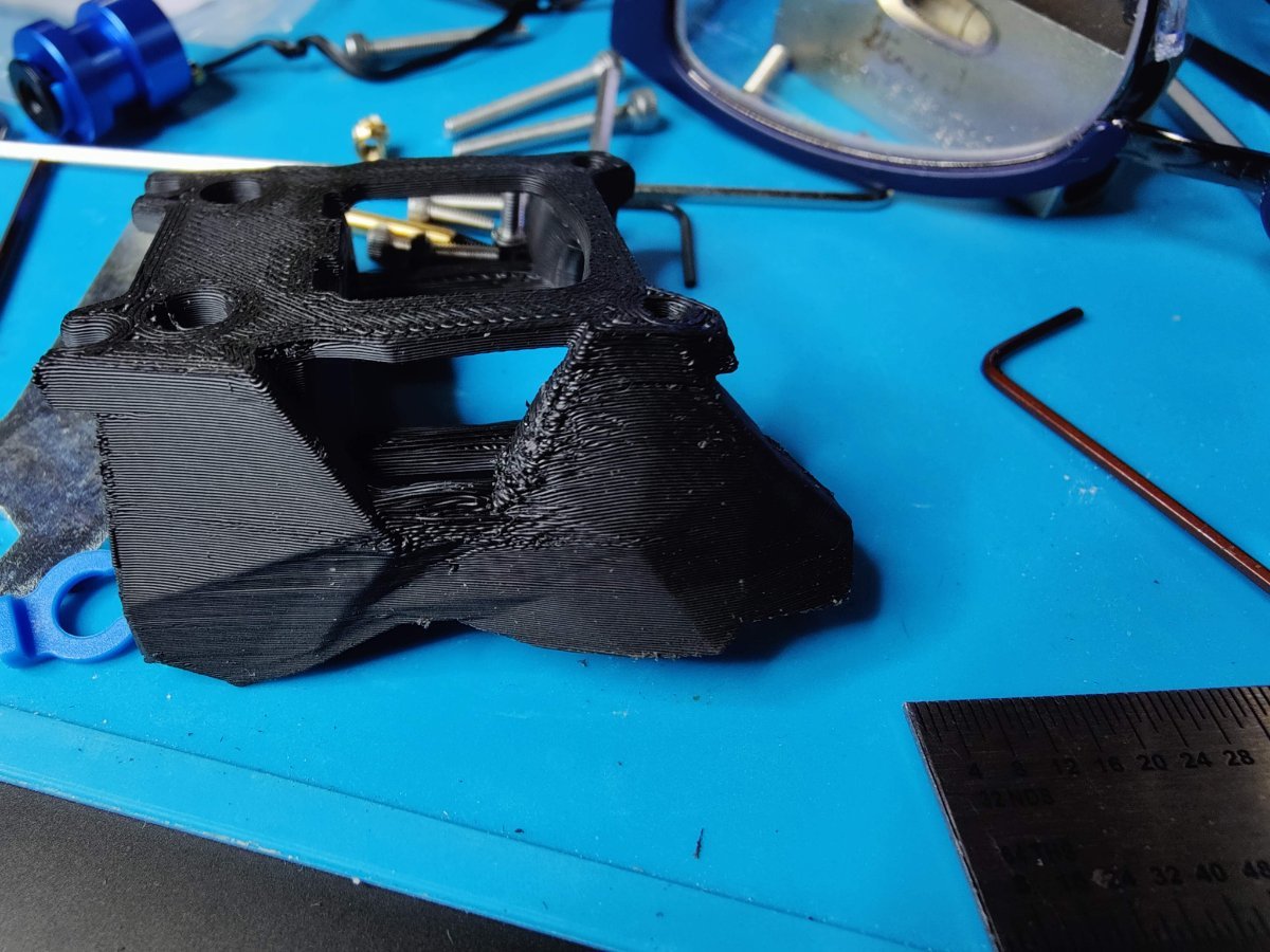

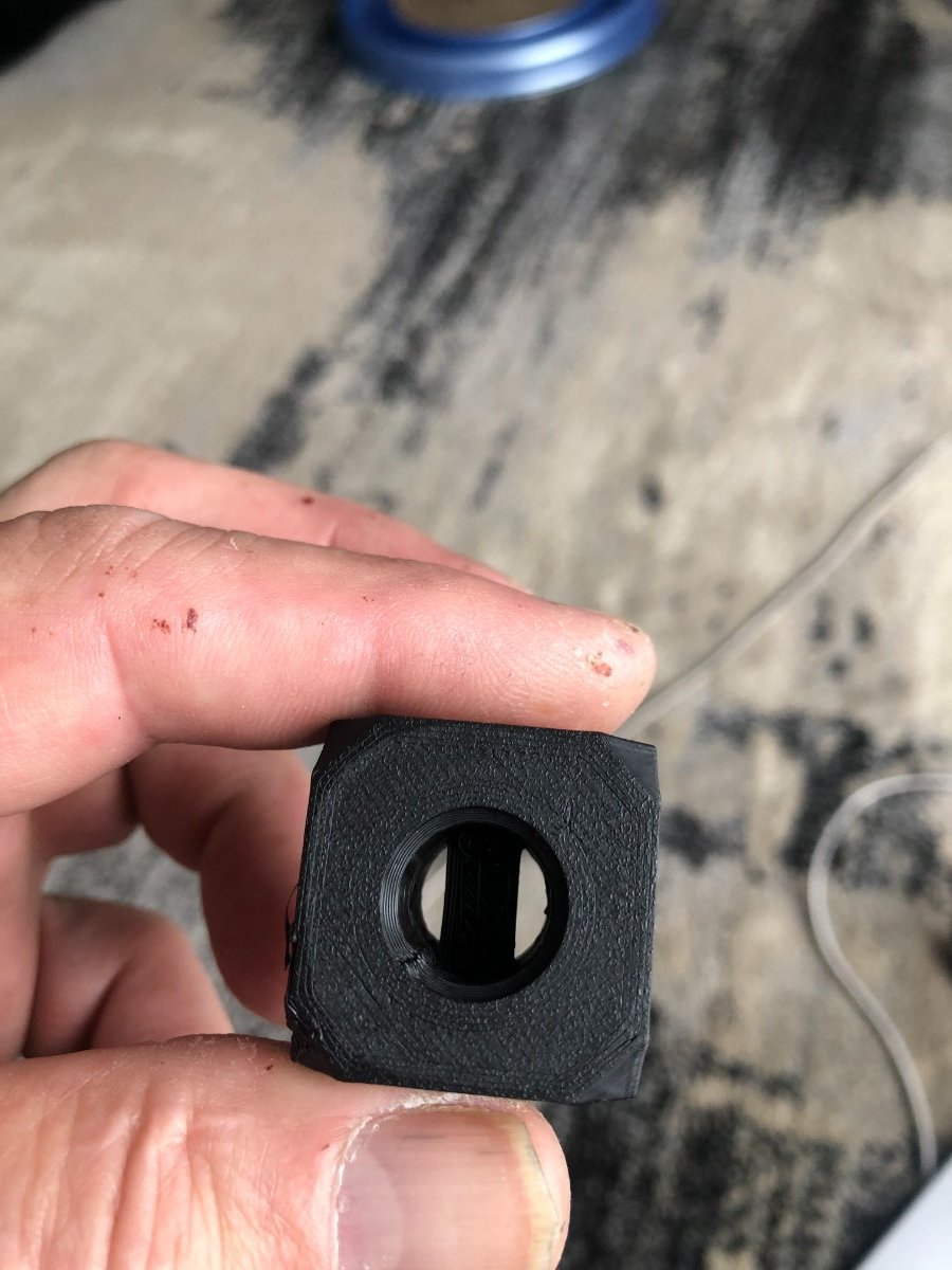

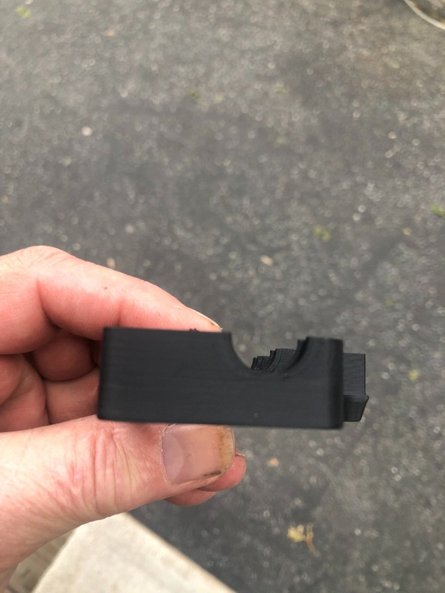

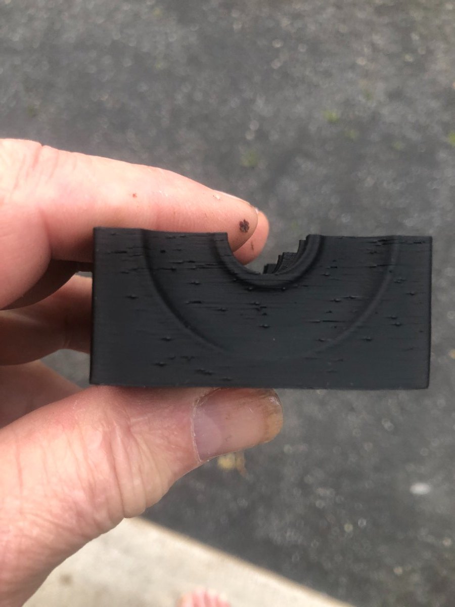

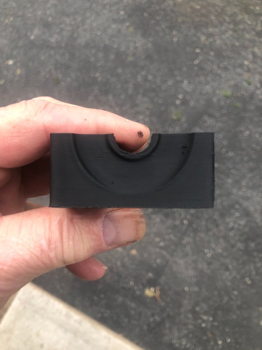

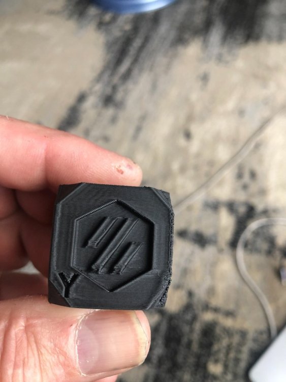

Is this normal (CW2) or a bridging issue? Over-extruding as well? Was having an extruder issue and finally got it sorted.  Need to check the rotation again.
I think that is normal, but then I am still learning to fine tune slicer settings.
