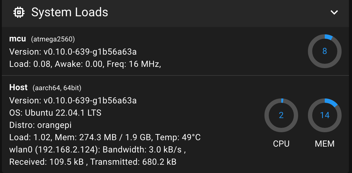

So I've converted my other Artillery X1s running on a OrangePI 3 LTS to Klipper/Mainsail. Used Kiauh to first remove Octopint then to install Klipper, Moonraker, Mainsail. What nice about using the OrangePi is the Klipper is install on the EMMC no more SDcard. 😎

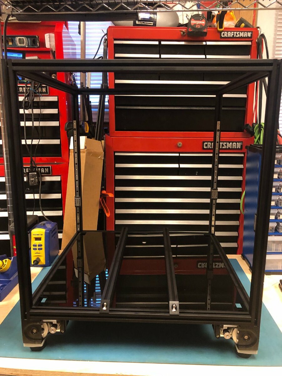

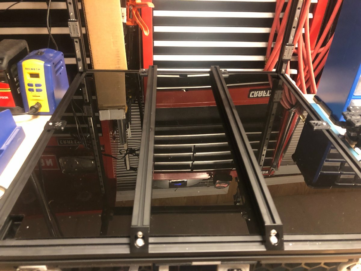

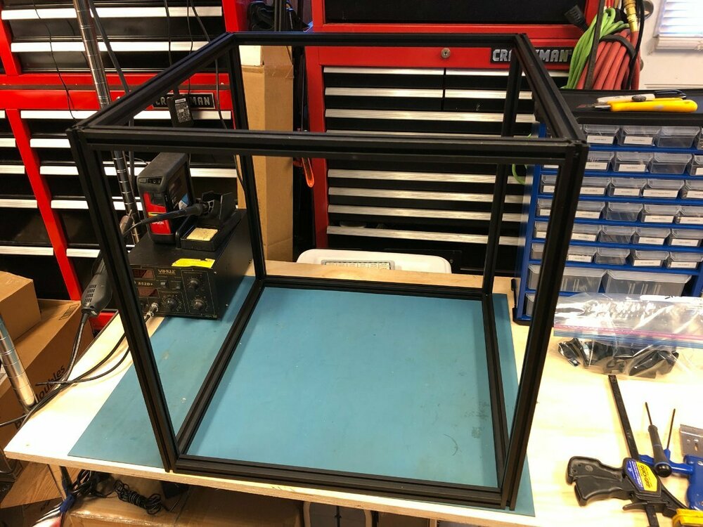

Got the frame together and squareness check! Still printing Z-drive parts so will prep and mount the z rails.
I am getting very jealous looking at the craftman wall there... oooh, I love these drawers with all the toys useful tools to spend money on!! (my wife walked by) 😛
Frame looks good, square is GOOOOOOD!

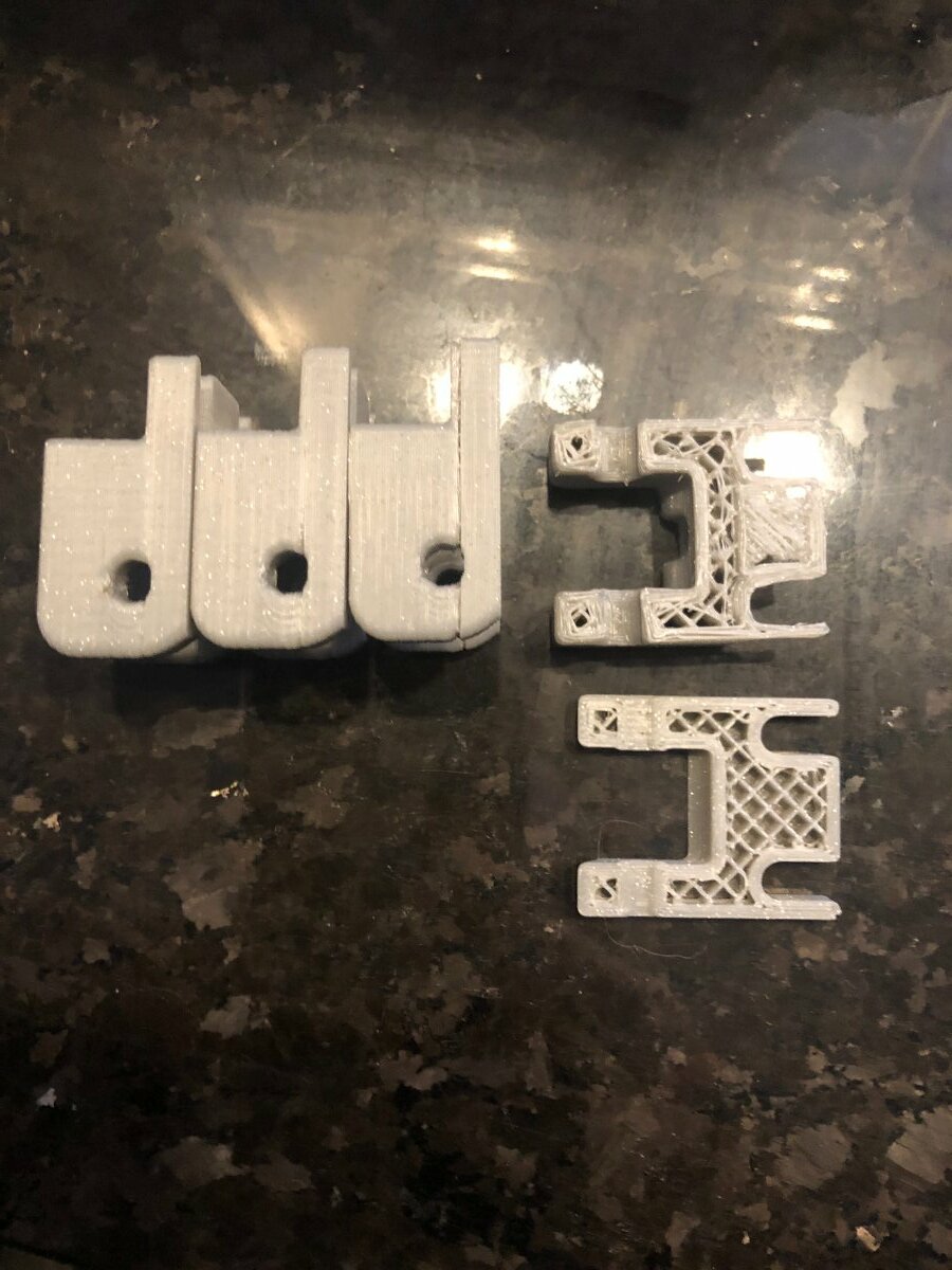

So this cloud grey is more like a silver color and your's right there is layer adhesion issues. Going to try printing it at 245 instead of 235.
I've order Cherry Red for the accent color.
Wow. My Trident accent parts are Sparta Cloud Grey Sparkle, printed on a Prusa Mini+ under a cardboard box. I have had zero issue with layer adhesion from those. The only part that's broken on me is the probe mount piece that replaces the inductive probe for Klicky--and that was because of damage from the blob monster.
What temps & speeds are you running? That infill doesn't look good, like it's running too fast. I t also looks like grid? Switch to cubic; that shifts the crossover points every layer so they don't pile up.
Thats what I was thinking too, the infill and parameter too for that matter, on the top right one in the picture is something from a horror movie...
The layers are almost random distributed, like they are.. turning, changing, doesnt look like printed too cold, I would expect, even too hot?
Changing infill can help in some cases, I used to playaround, mostly because otherwise my nozzle sometimes grinded the infill, and some infills are worse than others, but now I dont have that issue anymore, with any infill.
For this case, I think there is something else going on, I see open corners an the walls, so this could be too much speed, or pressure advance thats totally off.

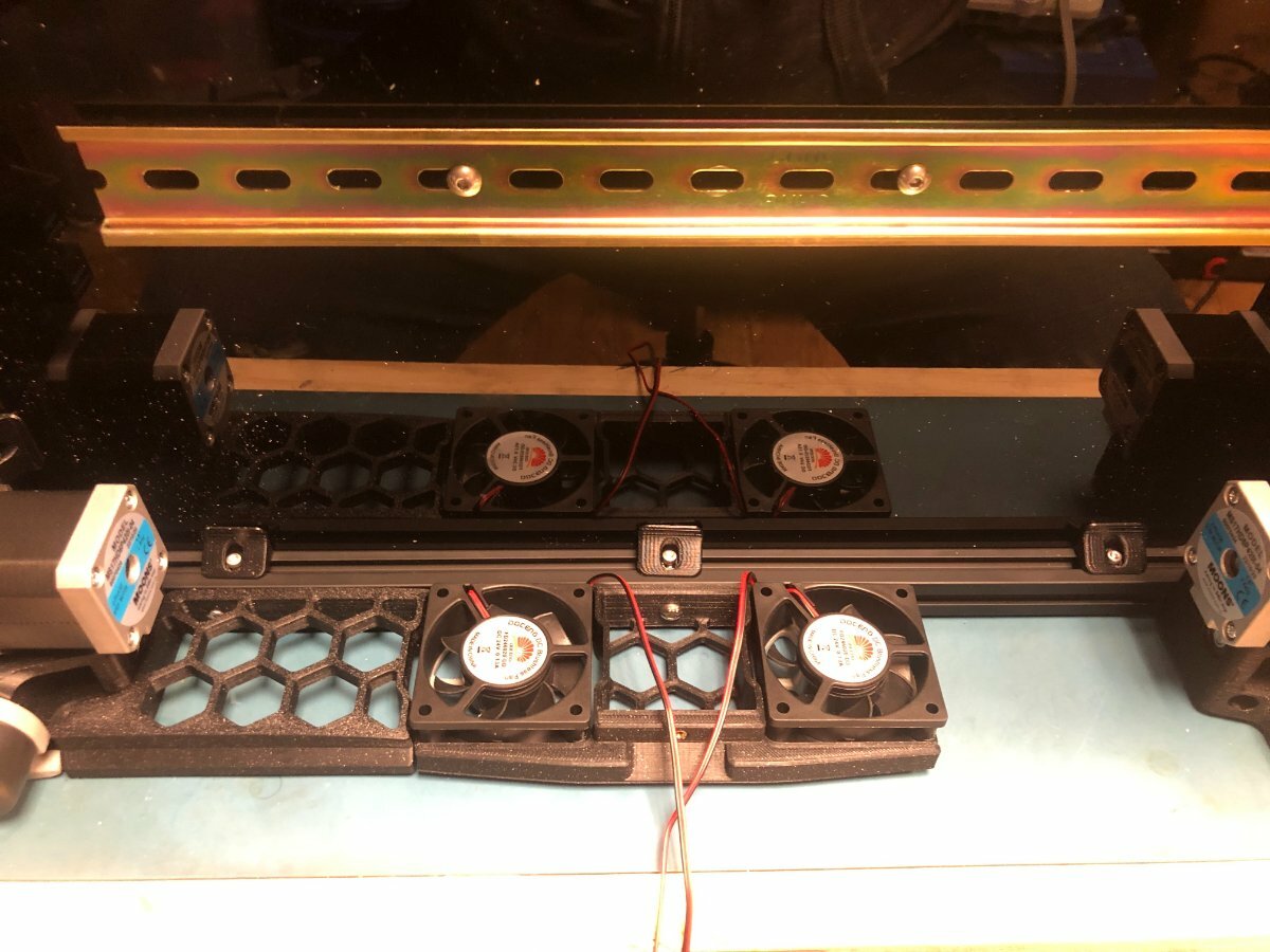

Well some progress today, z motor, Z rail, din rail  mounted.  @claudermilk @Buurman again thanks for your feedback got the cloud grey ironing out, change infill and lower temperature and it all good. Last day at home before flying off to work, last post till I'm back in two weeks time.

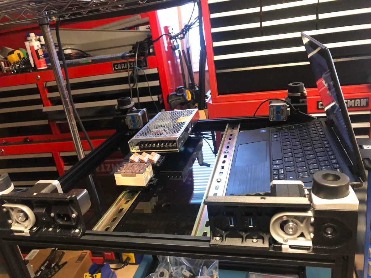

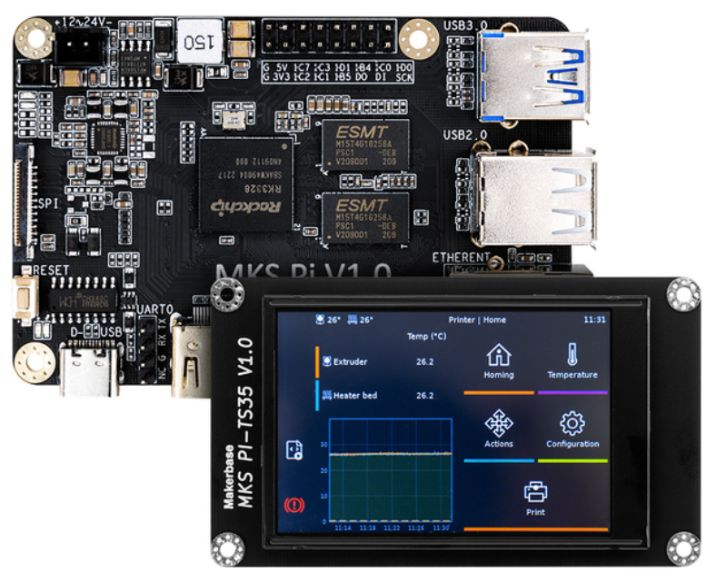

Decide to go with the pin mode for the xy and front idlers while waiting for them to arrive I've started assembling electronic. Kit come with 4amp and 8 amp fuses. Which are you guys on 220v installing? I went with the Makerbase MKSPi module, was easy to configure firmware comes with Fluid pre-loaded, powers for this module is 12/24V so no needs for the 5V power supply. I replaced Fluid using Kiauh love this application simplifies all tasks. Got the Octopus flashed as well. Printing skirt stuff so can be productive. Will must likely wire up whatever I can. Used the din Wago angle mounts I installed the din rails in the opposite direction I think this will lead to a cleaner wiring, we'll see! Go some leftover cable duct from my CNC build a bit big but will still work, no one going to see it when its all buttoned up.image.png.f34b0ac02ccecb15fdd02acb788c02f2.png
I'd probably go for the 8amp fuse. 220v @ 4A would give you 800W(ish) of head-room, but I imagine the bed will be 700(ish) W and the hot-end will be 40 and the electronic and motors will take you closer. On the basis of a 70% - 80% (of total budget) then I'd would say the 8A give plenty of head-room (granted more than you'll need) without getting close to the maximum.
