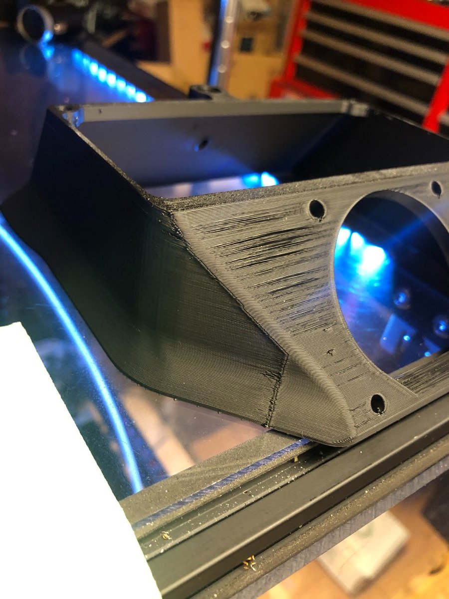

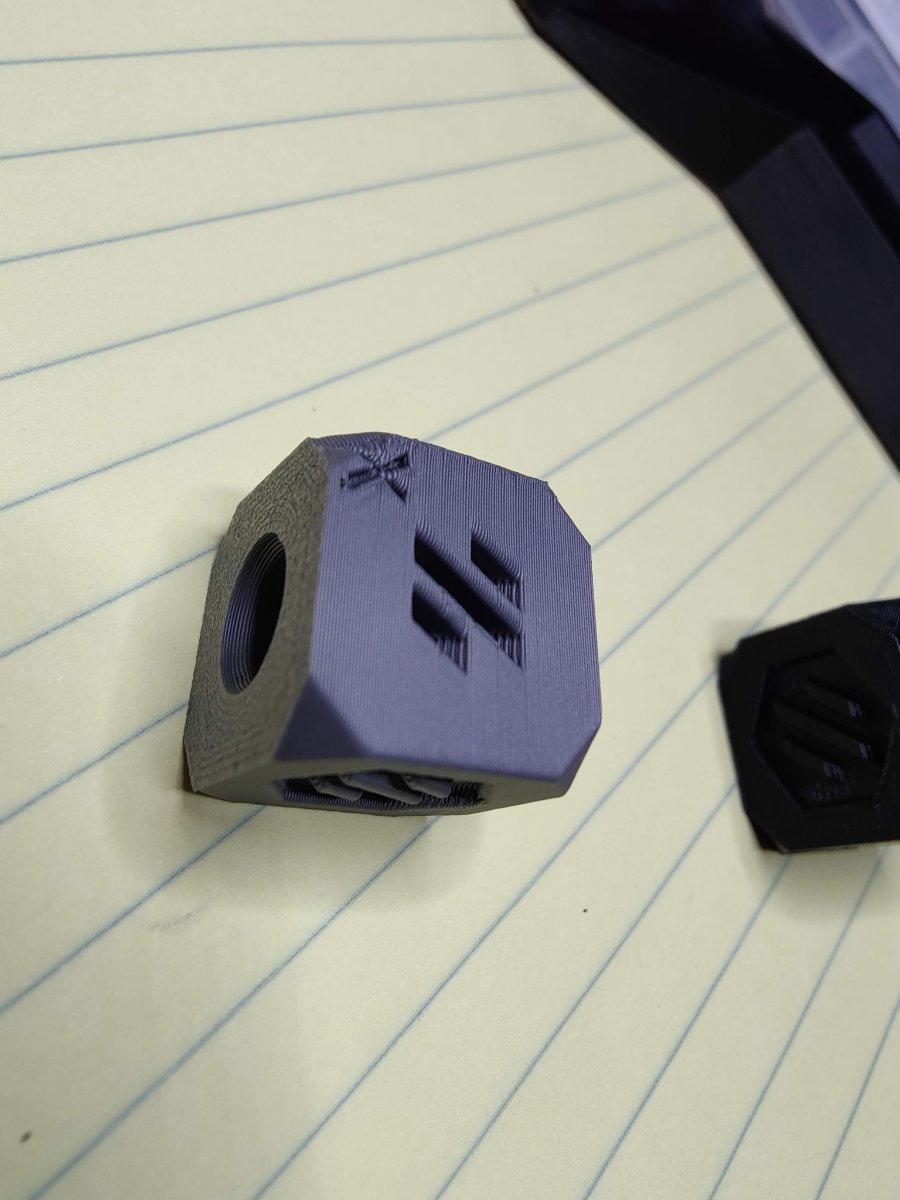

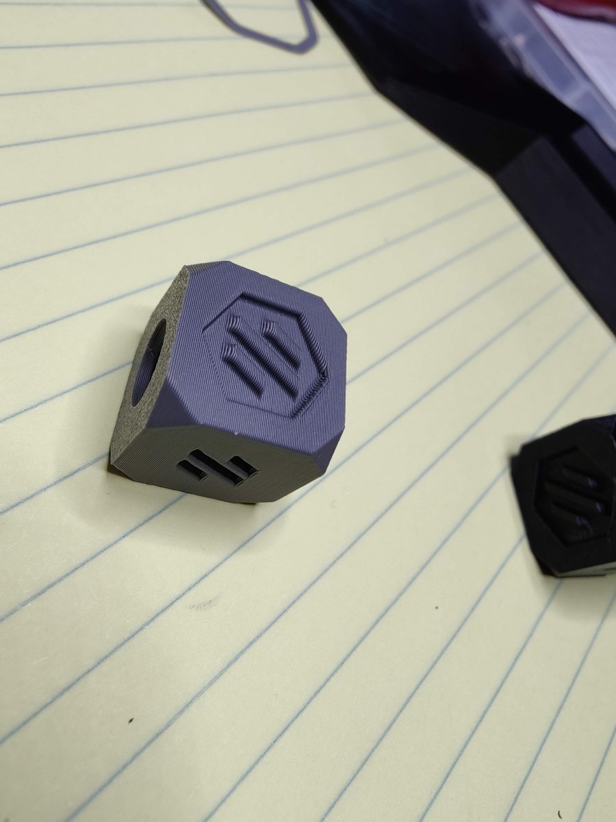

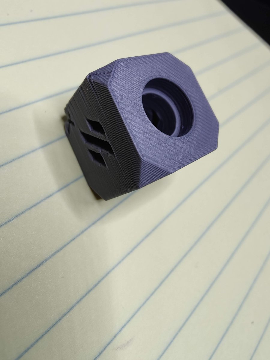

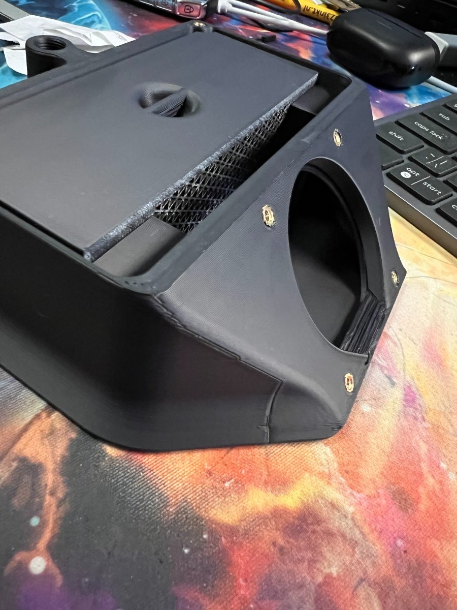

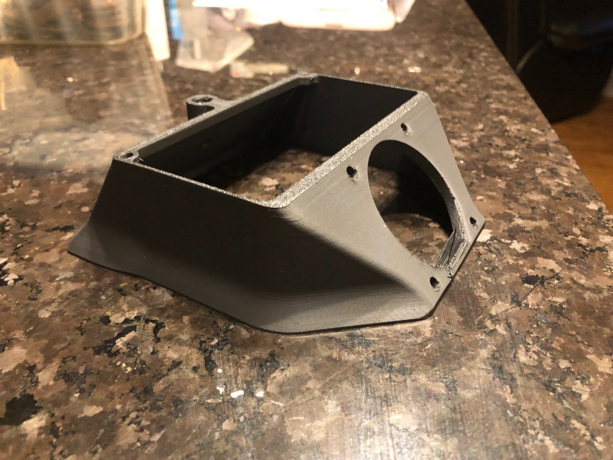

@Chuck_Snow Using your setting and fan speed gets me one step closer to tuning in the Esun ABS+. Activated the "External perimeter first" think I also had too much cooling which would curl the corners slightly. EM is at 0.97 and needs to work on top finish. All other parts printed for a 2.4r2 were coming out looking pretty good but this Z drive main body was giving me some grief every time I printed it so this tells me I'm getting closer.
Looking Good it took me a good while too to Dial it in what I use to clean up the top and ruff spot is a Crescent Nicholson 6" Mill Single Cut Bastard File just make sure its a mill file mean it only has one cut grove not a hatch pattern . so ////////////>--
and I use the Sharp edge of the Tang as a deburring tool lol.
I have included my Super Slicer profile maybe it can help you. I added Picture whit the thing you should change that suit your printer build.
Just import the config then you can rename the setting to your liking.

@PFarm What is your extrusion multiplier set to in your slicer? From the looks of your parts... you can probably reduce it by 5%. That should get rid of the elephants foot on the bottom as well as the over extrusion on outer perimeters and top solid infill.
I also had some issues printing ASA parts for my RatRig 3.1. I would get excessive corner lifting on parts even though I had good, dialed in settings. What I eventually discovered was that my part cooling fan was set to 40%, I lowered it to 30% and the lifting went away.
Some things to think about. 🙂👍

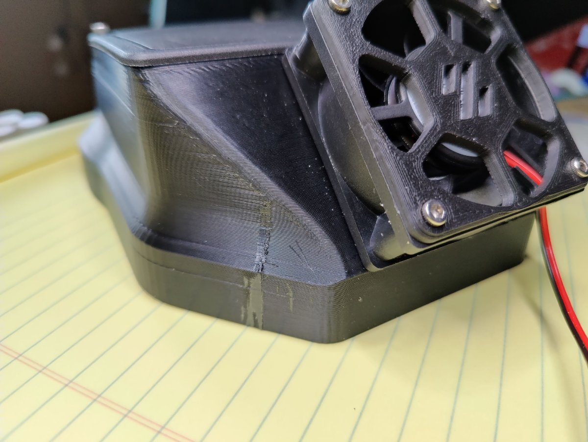

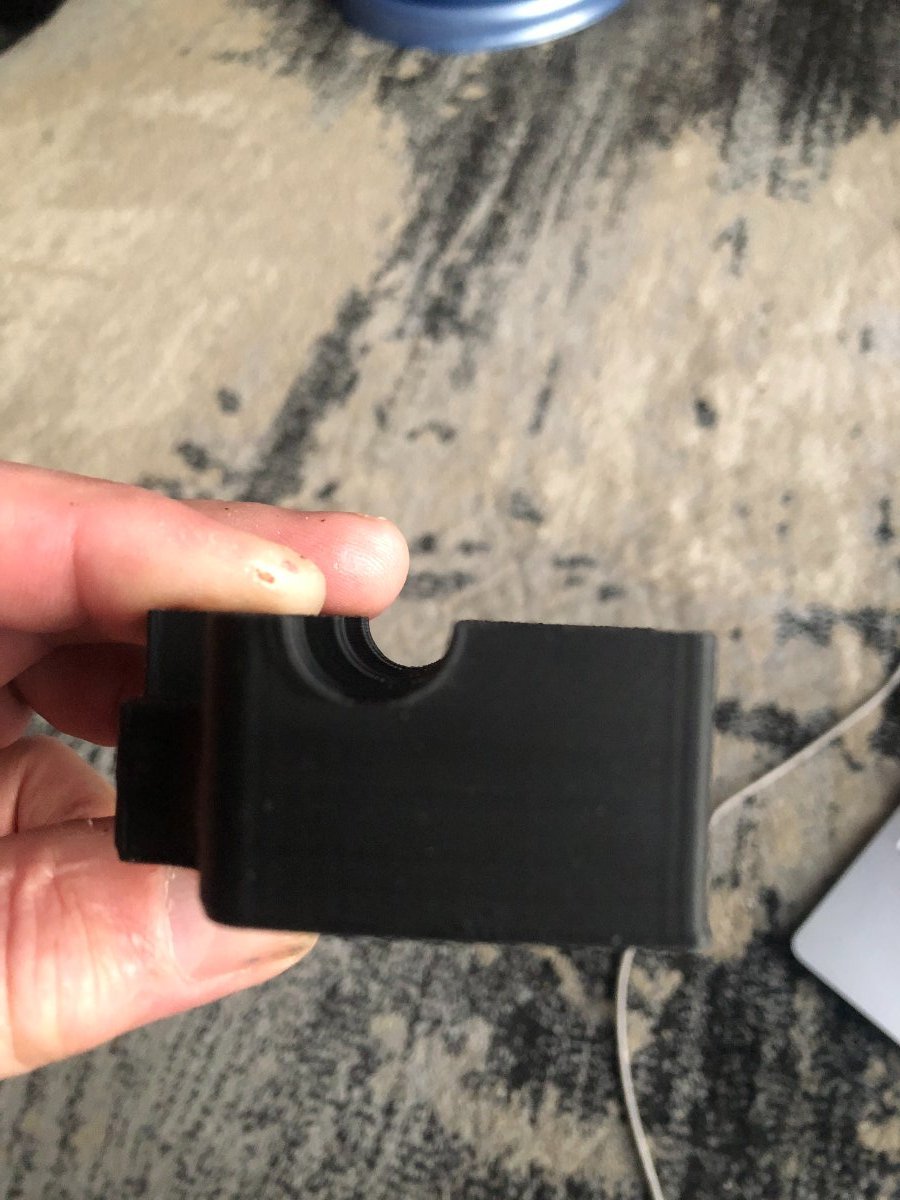

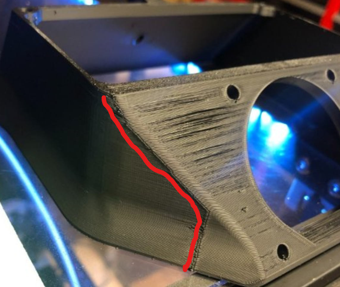

Any suggestion on how to fix the de-lamination and bulge on the seam? All other prints come out fine.
Update: Think I've got it figured out, been having extruder issues I'm going to install a genuine Bondtech gear assembly. When extruding 100m there's a slight slowdown in the extrusion.
The bulge at the seam looks like you might need a little pressure advance. Here is a decent starting value..
pressure_advance: 0.045
pressure_advance_smooth_time: 0.04
That is the Seam line..
The other lines on the other hand, might be cause by the Fan filament is cooling to fast and it stretching out thin and it not bonding properly adding more flow could help. or partly the Hot end Temps..
See when you're trying to print hot and fast the filament wants to ooze hot it flows faster thinner so it comes out thin and stringy and if you add high fan cooling and can alter it ability to adhere fast enough and shrink faster which creates under extrusion. you can compensate for that whit a small amount of more extrusion/flow..
I mean that has just been my observation whit my prints so far..
And for the extruder, I just switch mine to the Bondtech LGX Lite seam very good so far ,,and it has room later if you want to upgrade to a CAN bus board etc .. jsut a few printed part and it fits right in easy as pie..
With default alignment I have the seam on exact the same place.
And quite clear, never took the trouble to place it better, since its on the back of the printer.
Rest of the print is pretty perfect, so this seam is quite a rare one, that its so obvious. I am also strugling with the seam placement on the Stealthburner, perfect place doenst "seam" to exist...

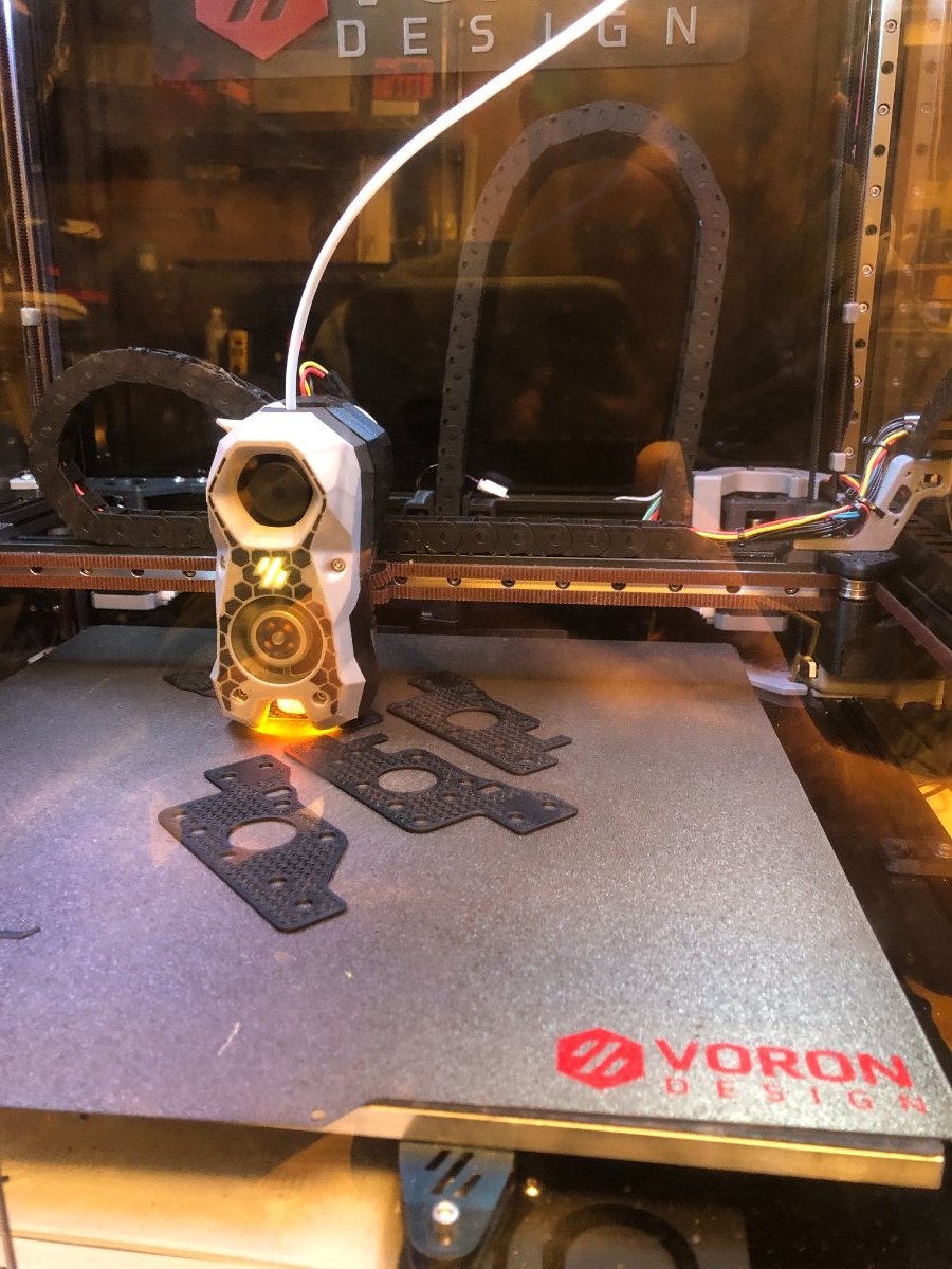

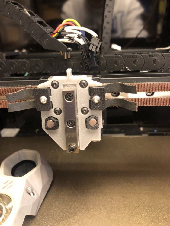

Replaced the extruder internal drive component with genuine Bondtech parts, extrusion is a lot smoother, re-calibrate the extruder. While I had the CW2 apart I installed the Tap R8 parts, I was having issues with the upper belt on the right side staying in place under tension. Like the newly added feature of the locking block for the belt. Also went with the second set of magnets over the screws.
Note: just noticed I've got the cover installed backwards when compared to the change log photo don't think it matters?
20 minutes ago, PFarm said:
Adjusted the seam location to corners and this was the result - seam is gone!
Great result. I love your persistence and quest for perfection. In that, I learn - thanks
Yesterday while swapping out the Tap R8 changed out the Stealthbunrer body as well. The next mod is installing the backer plates and BTT 2209 Canbus with the BTT U2C. I'm glad I took the advice of getting the printer working before doing Canbus, so now that it working great let's see if I can break it :classic_cool:, the only way to learn right?

I like the hotend fan you are using! what is it?
It's a Noctua fan, I'd cut off the two wires I didn't need but wish I didn't cause I think the BTT 2209 Canbus can monitor RPM.
