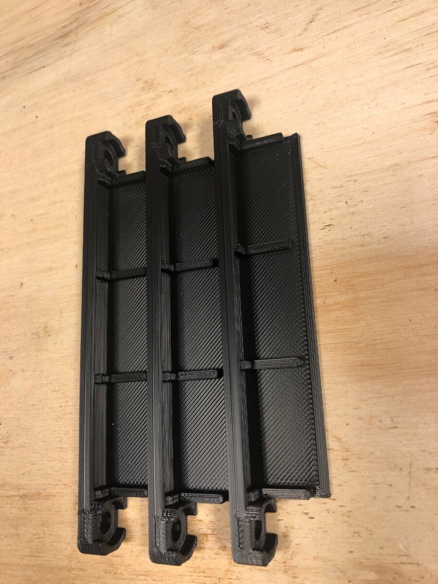

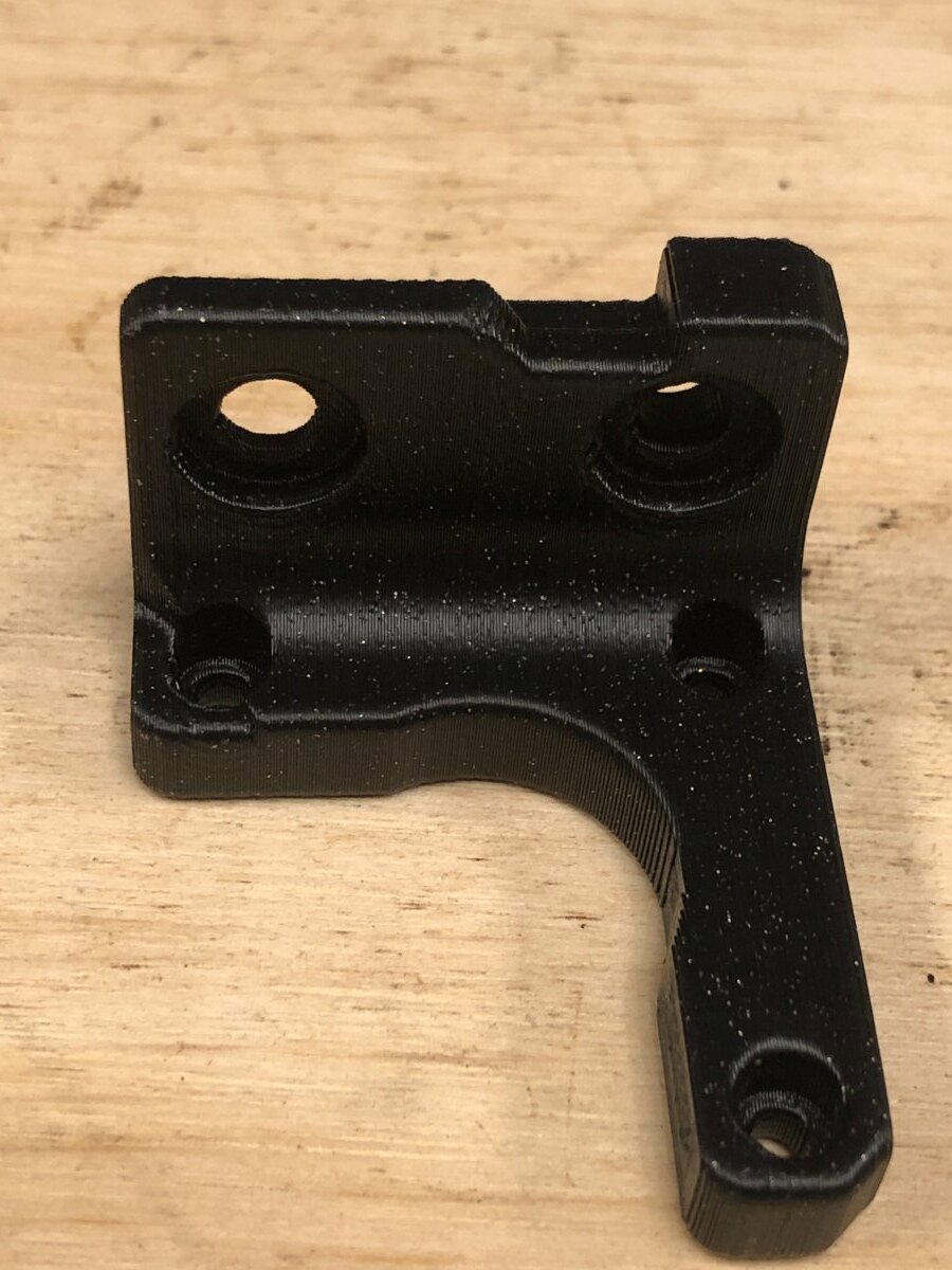

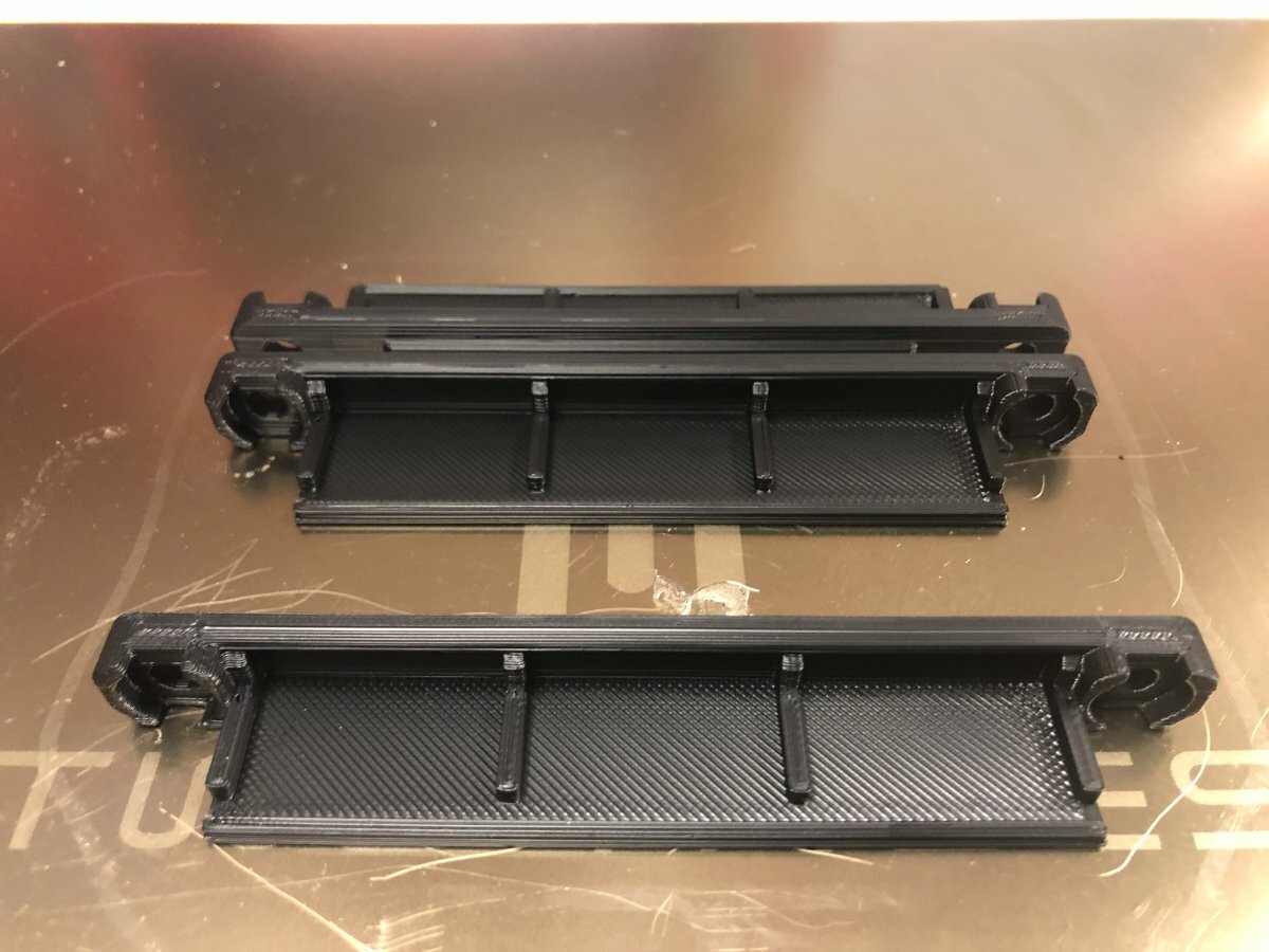

This is my first Voron build, got the email from Formbot saying the kit be being shipped (Whohooo!) I setup a ghetto enclosure with two cardboard boxes for my Artillery X1 to print parts.  Also first time printing ABS so this will be interesting any help, suggestion, critic are welcome. Figured I'd start with electronic bay parts to tweak slicer setting (Cura 5.1.0) since parts will be hidden. Base colour Spartan Obsidian Black Sparkle ABS+, accent Spartan Cloud Grey Sparkle ABS+.

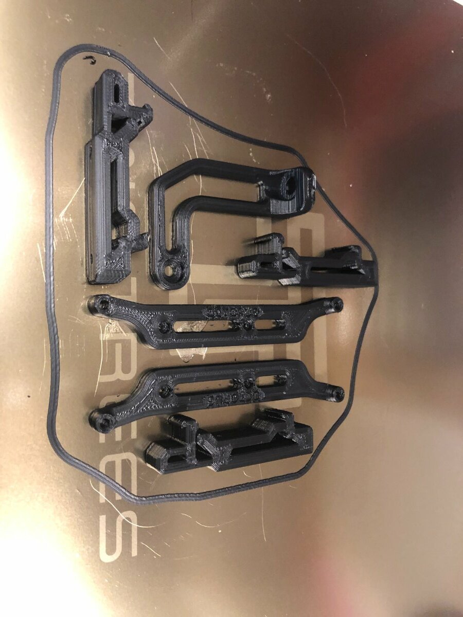

Print in the photo are 3D3 Sigma Prototype ABS.Printing at 235C/110C glass bed with PEI sheet is why I set it 10C higher. Use hairspray too help with adhesion clean with Isopropyl before re-applying hairspray seem to working for me. Titanium heat break with a Micro Swiss copper plated #4 nozzle.

Looks good! From my experience printing ABS for the first time (for my first Voron) using a very similar cardboard box approach on another printer.....with hindsight,I would strongly recommend using the thread tests from the Voron githuib for me my issue (which I only discovered after printing most of the parts) was I had not tuned my flow rate sufficiently well. Everything looked good  and "fitted" but my flow was too high so things were just a little too large and things like the threaded V0 belt tensioners just would not screw together, and bolt holes just a little too snug.

Looks ok PFarm, its always hard to judge from a photo, since they can differ so much from reality.
I would go trough the Ellis guide for tuning, I think you can optimize the top layer (this can strangely have to to with bottom layer, so do the whole guide) since to me it looks like you can see the lines a lot, and where the text is on the brackets, I expect, printing to hot ot maybe too fast, seems like details get lost.
But overall, I think (based on photo, again, if it looks good to you, its good!) you are on 80% of whats achievable.
https://github.com/AndrewEllis93/Print-Tuning-Guide
pS. I think the wago holder look very solid! its the brackets where I think some improvement can be made.
Parts look good. I'll add another recommendation to do the Voron thread tests. I did that with my Mini+ in its ghetto cardboard box enclosure. Those prints passed, so I moved ahead, and most of my Trident is still those parts from the Mini. Also another recommendation for the Ellis tuning guide; it helps you get your printer really dialed in.

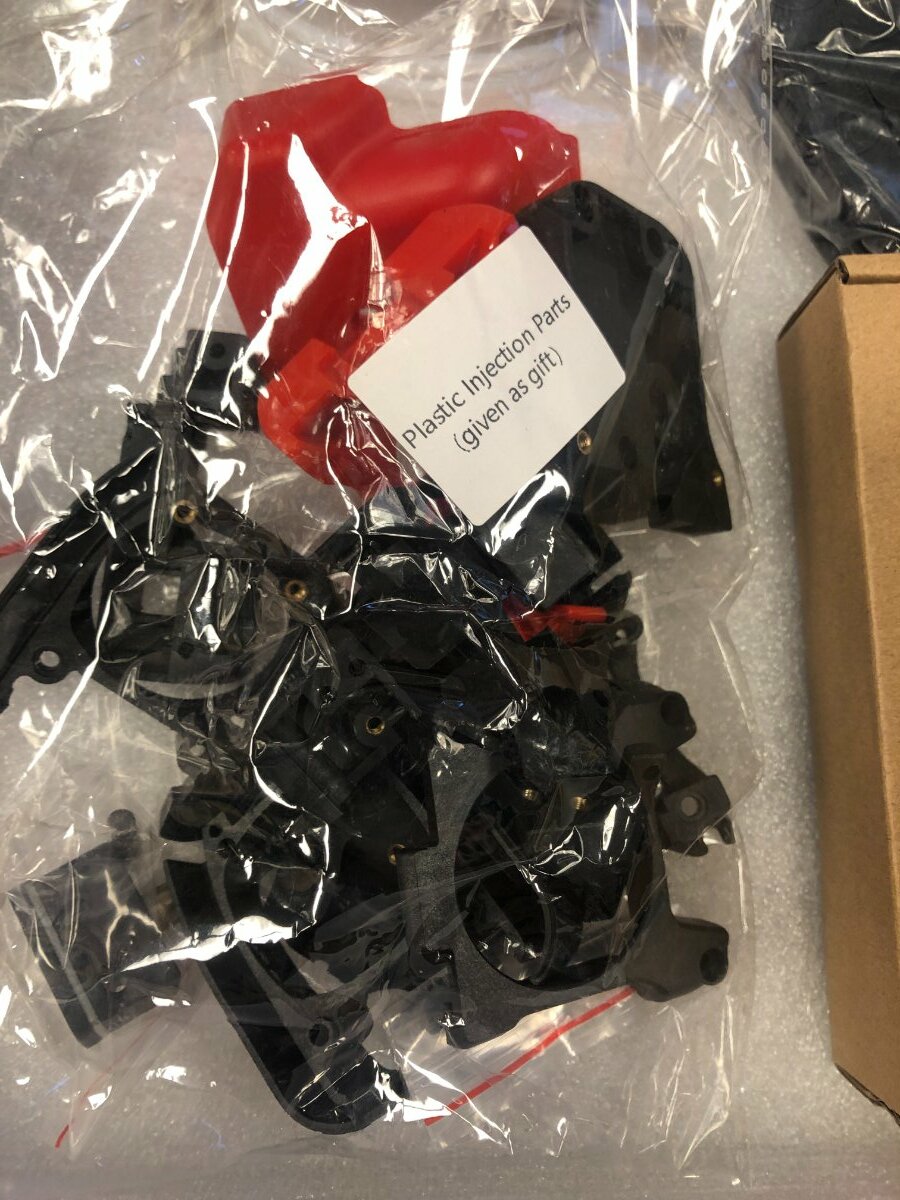

Yeah could be LOL! They did send a few printed parts as a gift (filter and hot end).
That's cool of them, but is that your collar scheme? Standard Voron 2.4 colors. Happy building. Take your time and mostly enjoy.
