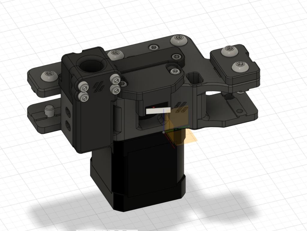

Rear Umbilical Addon and Y Endstop Relocation
| BOM | Pieces |
| M3 Heatinsert | 4x |
| M3x10 SCHS | 4x |
since my a/b motor mounts are MJF single pieces i needed a way to add umbilical compatibility without the need to reprint anything. so i designed this. its however heavily based on Selliot79's Design. i just designed it to be a bit smaller, to fit a IGUS CF5.05.18 perfectly and moved the mountings to the rear, so theres space for a Y Endstop relocation
