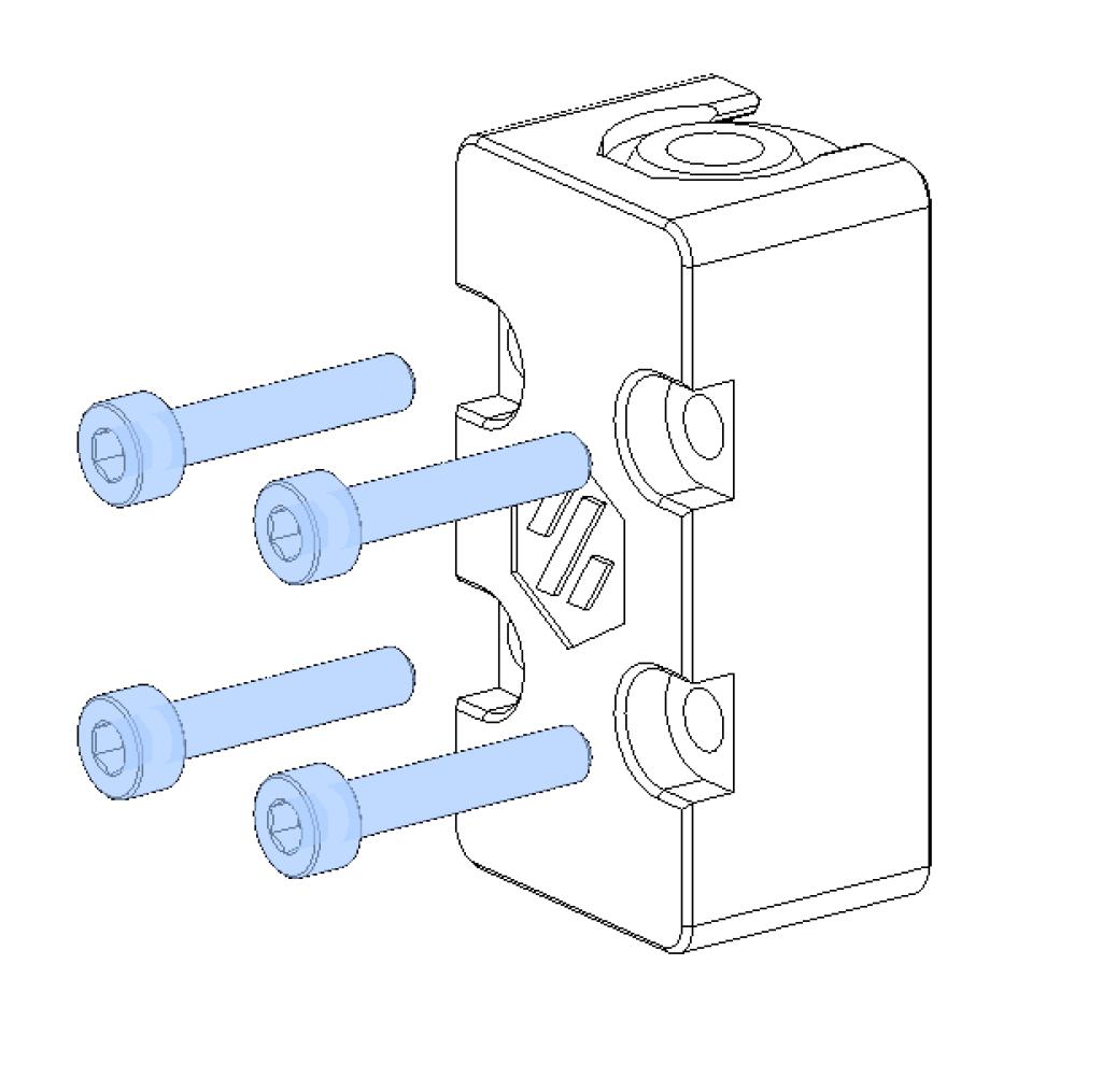

Voron 2.4 GE5C Z joint
BOM
| Screws | Size | Qty |
| M3x12 | 4 | |
| M3x16 or M3x20 SHCS | 16 | |
| M5x20 | 4 | |
| Ge5C Bearing | 4 | |
| M5x1mm spacer | 4 | |
| If using Halleffect 6x3 magnet | 1 |

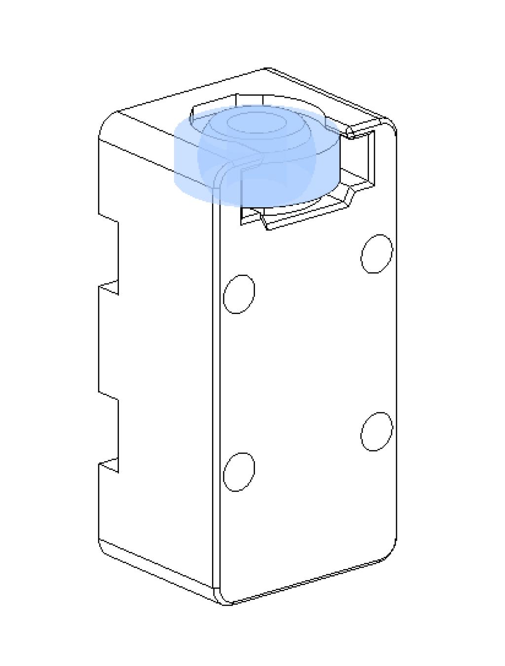

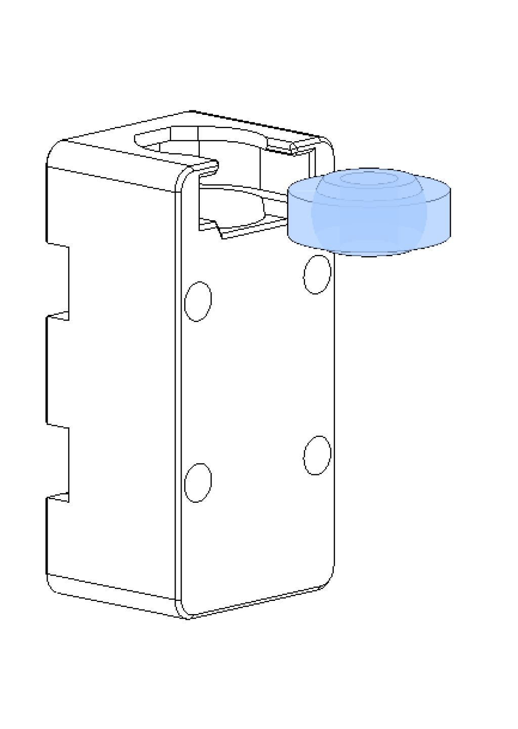

First just insert GE5C bearing , it should just pop in
Now if you are using the
