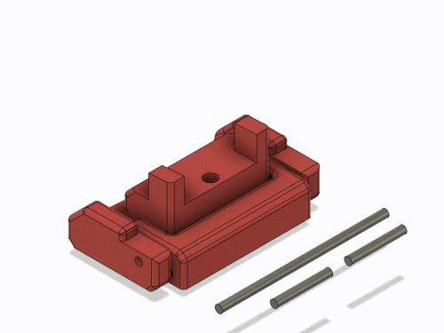

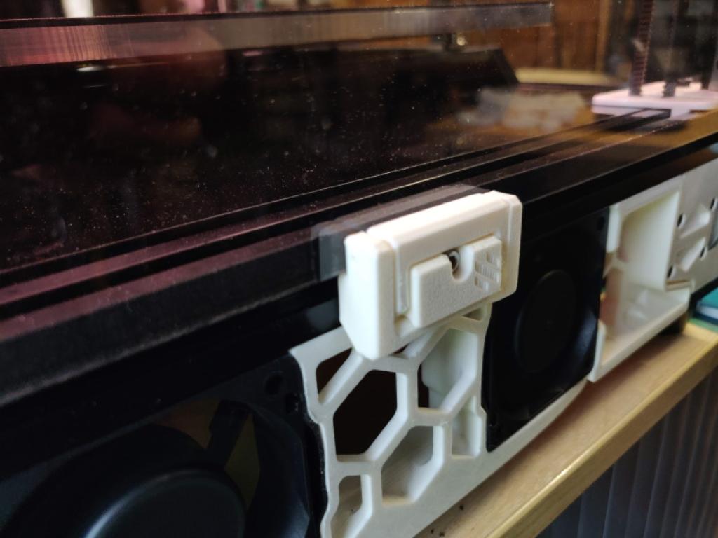

Printable quick release latch for panels on 2020 extrusion
This is originally inspired by a youtube video - https://www.youtube.com/watch?v=6p7M18oPn3k
Another user is creating cad and variants - https://github.com/v6cl/My-Voron2.4-Customs/tree/main/Panel_Locker
So why did you do it?
- I wanted a variant with filament hinges
- I found it didn't put quite enough pressure on the panel and my attempts to moodify the cad failed

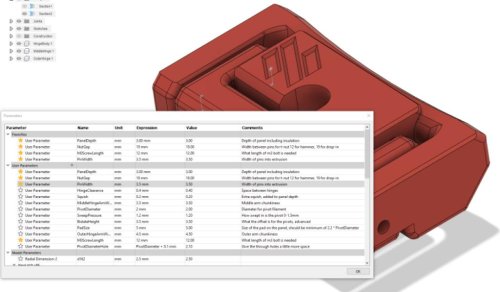

- Decided the best way to understand it was to design it
- Wanted adjustable
