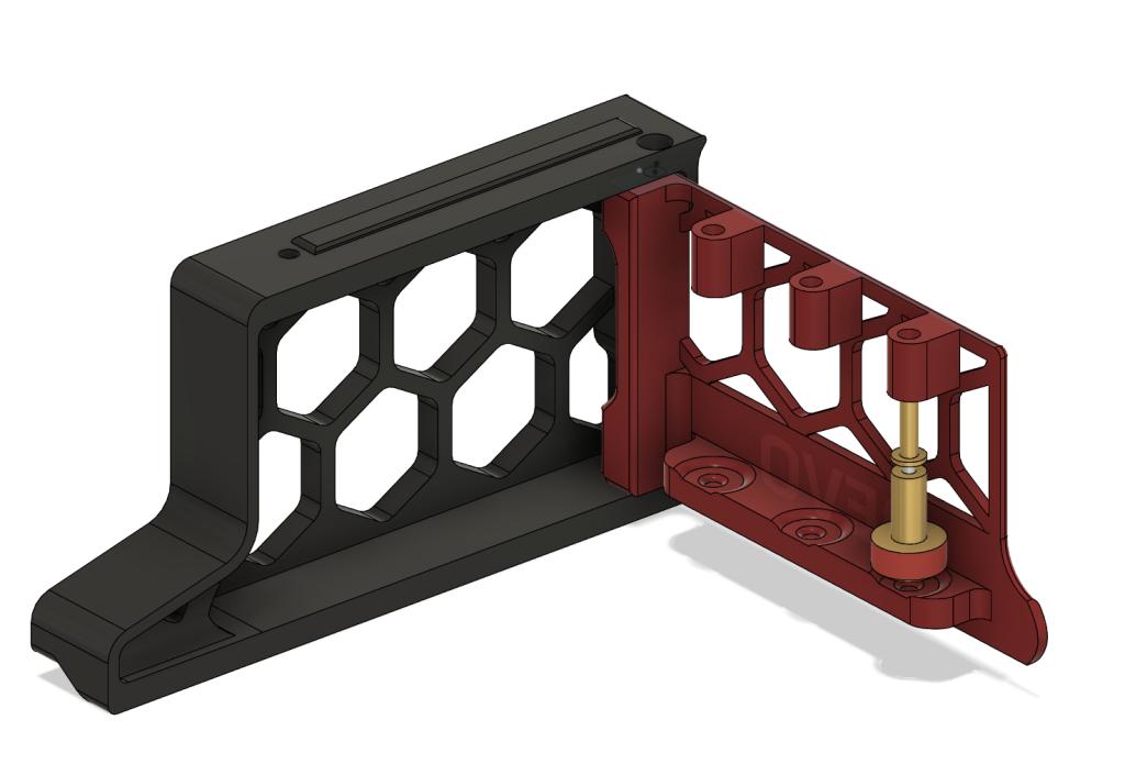

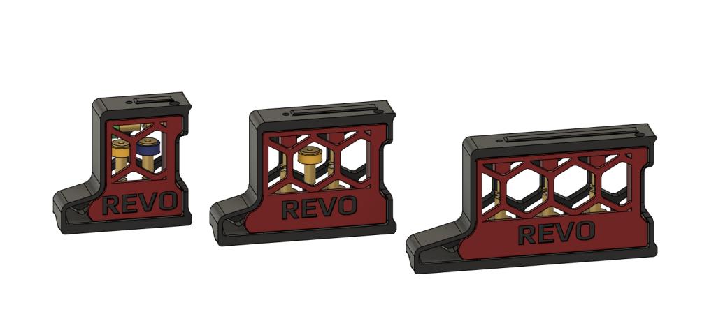

This is a modified skirt that lets you house the 3 current revo voron nozzles whilst they are not in use. Currently only designed for the 350, 300 is possible, 250 is small but I think I found a way to squeeze them all in
Designed for the Voron 2.4 R1 and R2
Hardware Required: 2 M3x8 or M3x10 SHCS.
They thread into the plastic and should be somewhat tight to keep the door closed, A design with a magnet may be in the works.
The Nozzles can either be left free floating, Or you can thread them into the top blocks if you do not want them rattling about.
