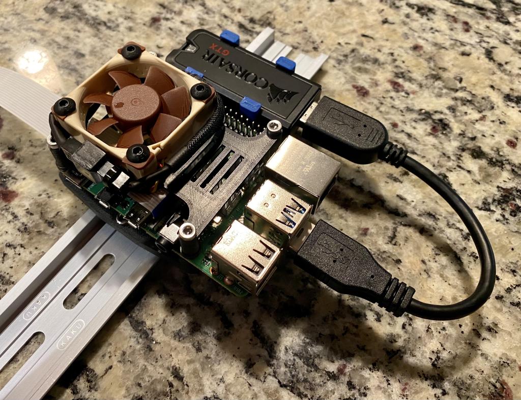

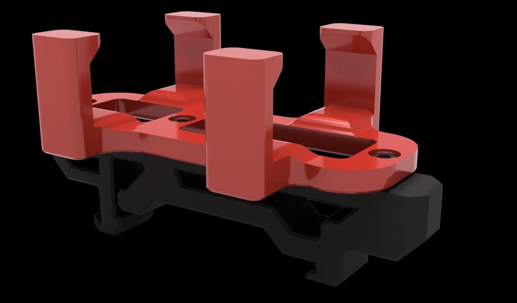

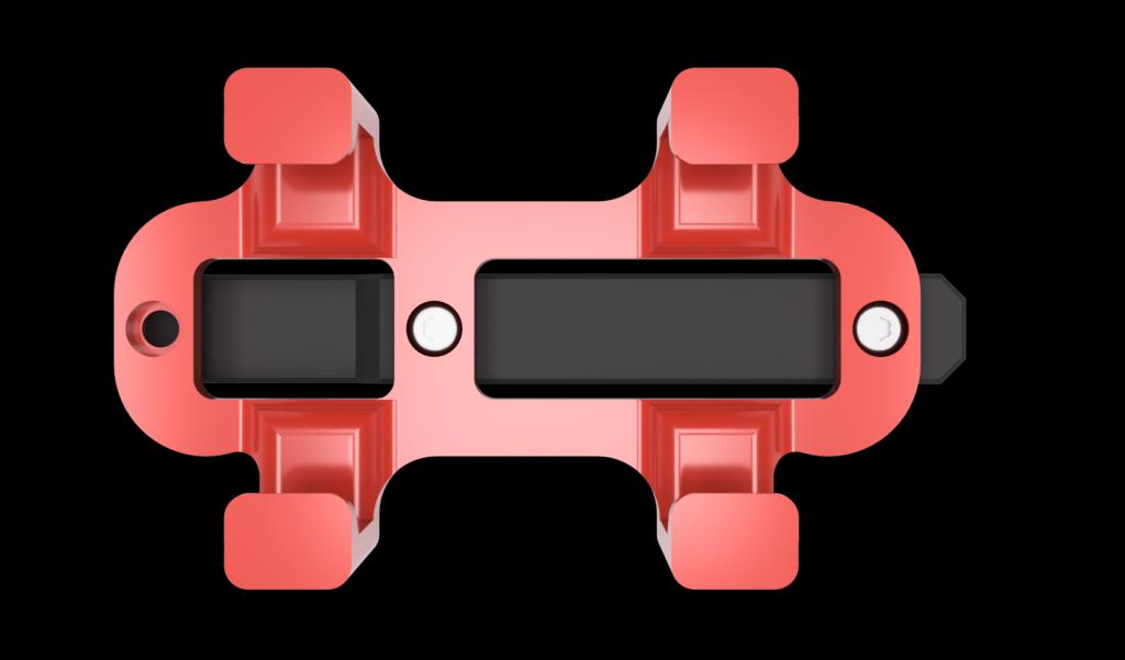

Corsair Flash Voyager GTX Din Mount
Din carrier for a Corsair Flash Voyager GTX. To be able to plug in the USB drive you can purchase a small USB extension cable located in the BOM below.
The model included can be mounted to the original 2.4 din clip or the newer Trident din clip.
Printing
  • Default voron settings
  • No supports needed
BOM
Size Qty
M2x10 2
Trident PCB Din Clip 1
Corsair Flash Voyager GTX 1
.5ft USB extension (Optional) 1
