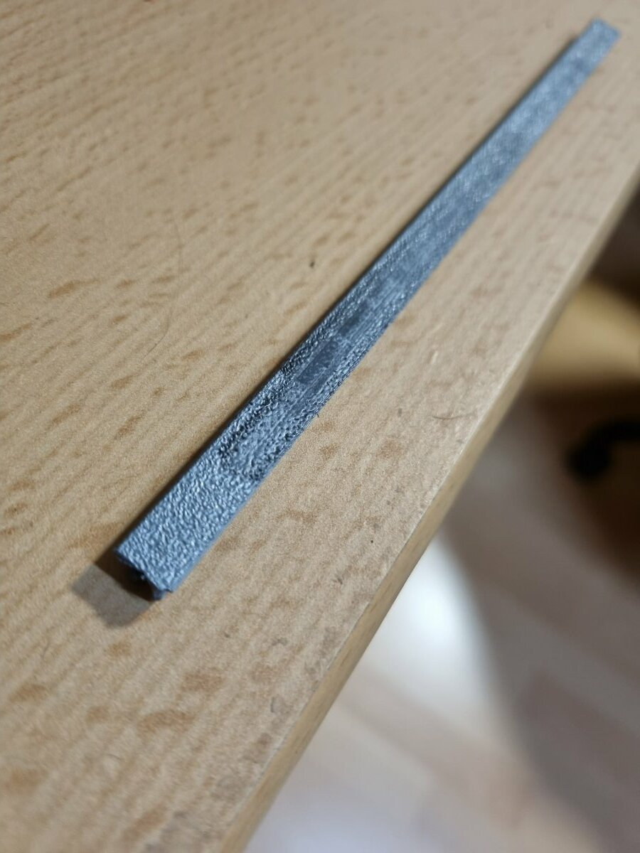

- the pulleys of the Z-Idler rubbed slightly on the holder for the LED profiles
- The deflection rollers of the A/B drives have so little clearance that they have rubbed against the cable covers of the profiles.

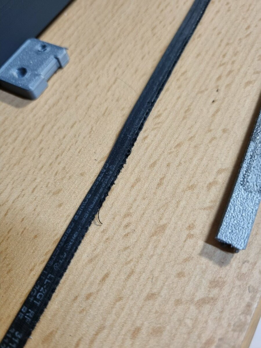

- Since I didn't use any screw lock, a pulley on the A/B motor slipped a bit, which caused the belt to suffer.

My guess is that mainly this would have effect on your prints...  the other things are bad, for sure, but i dont think it necessary made quality issues, yet.. sure it would cause damage over a while!

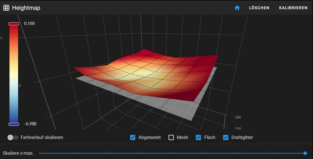

After my mesh looked like this, I started looking for the cause
At first I suspected the aluminum plate from Formbot in connection with the magnetic foil.
So I invested again and got myself an aluminum bed with integrated magnets, a great part but unfortunately the mesh hasn't improved much.

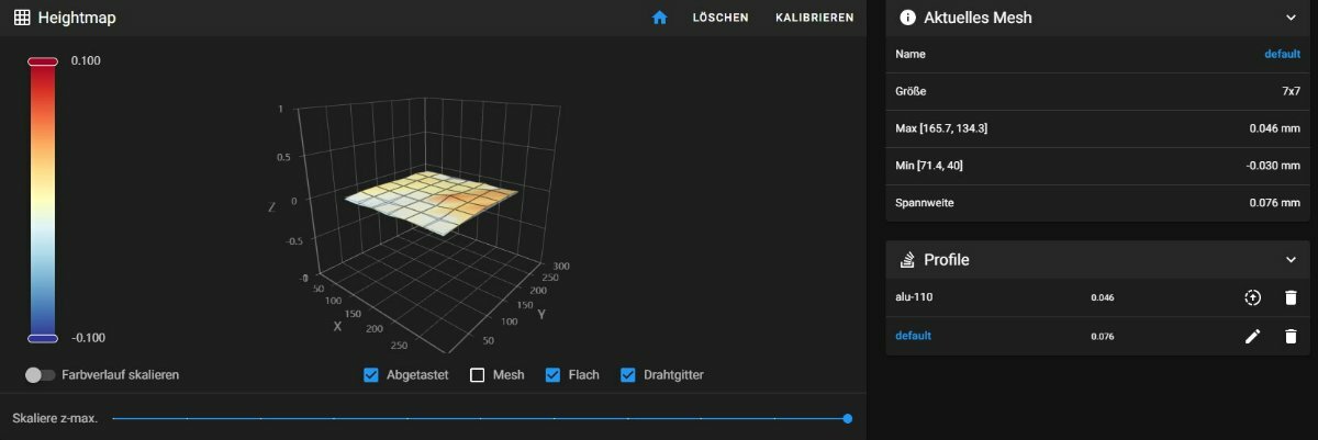

Finally, I put a straight edge on the X-Rail and noticed that it had a small drift upwards in the middle. So I loosened all the screws apart from the two outer ones, tightened the machine a little and re-meshed it:
I think that's the way to work🤗
