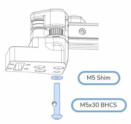

Guess you technically could, but I imagine it is really about part conservation. Why require yet another shim/washer thing in the design when you've already got 1mm M5 shims in the mix. I'm guessing the same is true for the bolt - for whatever reason they only need 28mm or 29mm but rather than require a one-off then just shim it. Now I suppose the real question is why design a hole that requires only a 28/29mm long bolt rather than one that requires a "standard" size, but I suppose the shim route was the lesser of two design evils......
