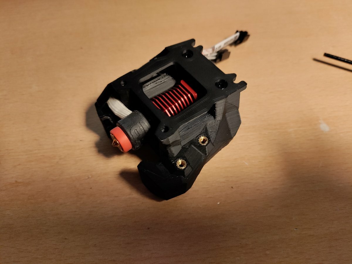

A question

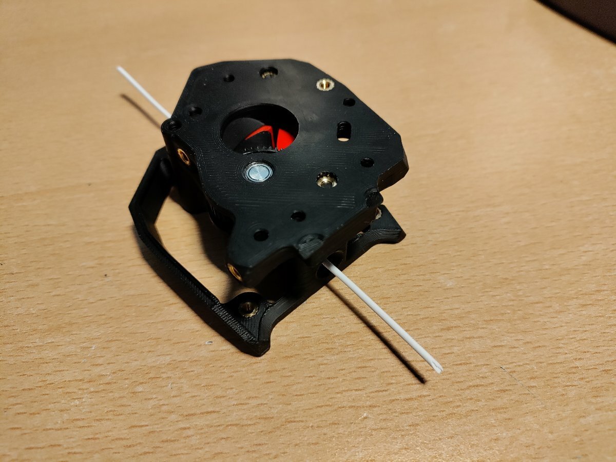

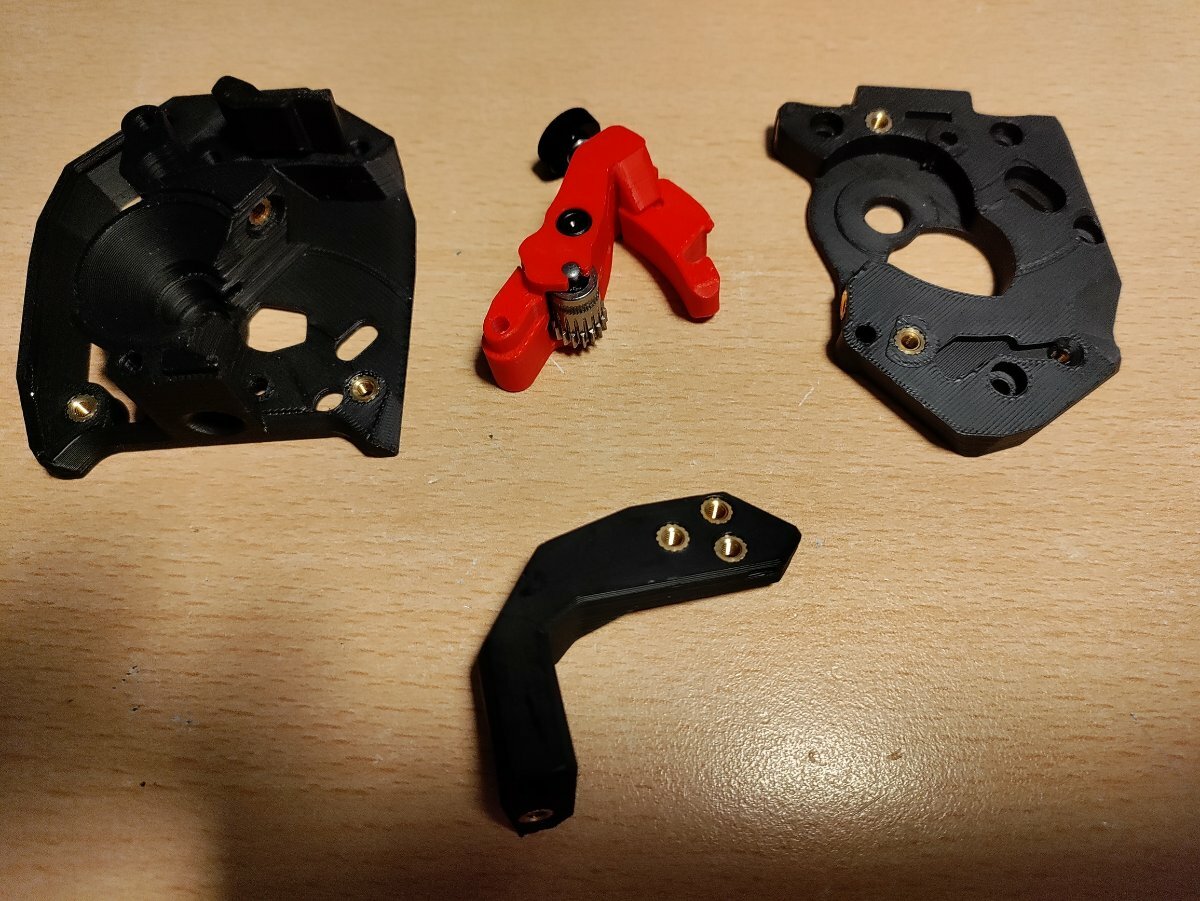

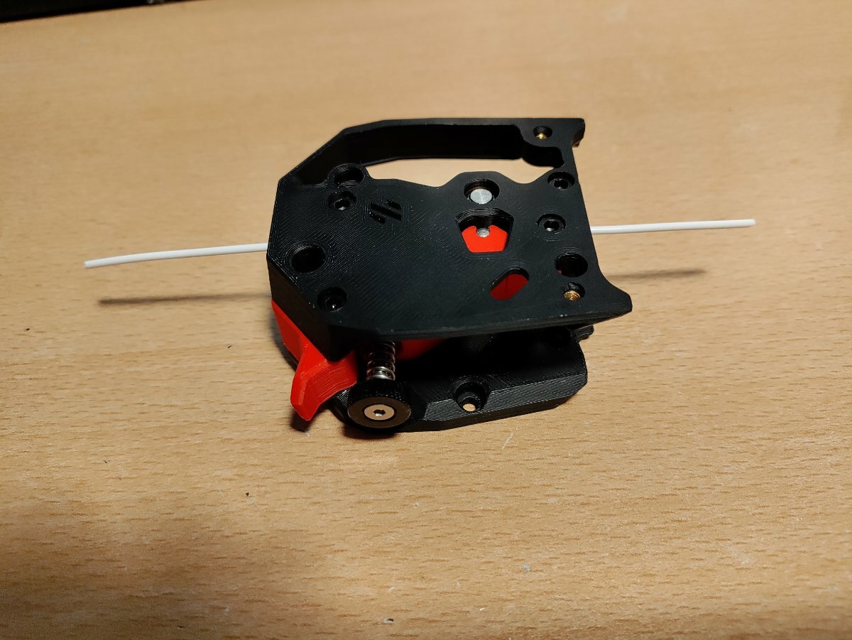

While assembling the main body of the stealthburner you are supposed to line up the toothed section of the drive gear with the filament path.
There is however a little lateral play in the drive (about 1 mm) is this normal ?

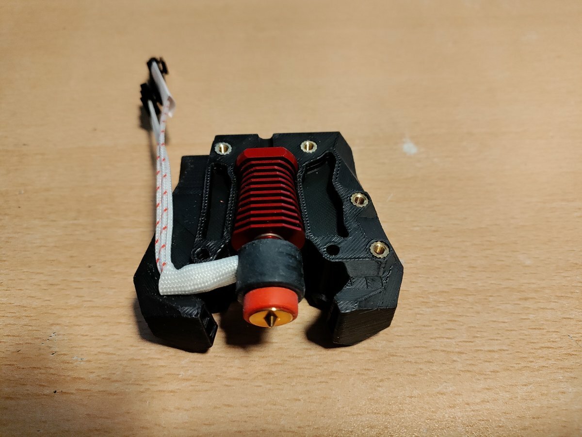

Tiny problem: I bought the stealthburner pcb but I don't have the right cable_cover_for_pcb part. I could have it printed but the price plus shipping is just too much for just one part. Don't know if I can start printing without this part?

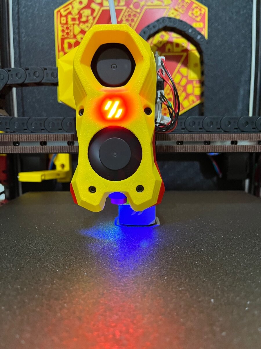

As long as the cables are secure and won't catch on anything, I see no reason why you could not print without a cover over the wires. I ran my test prints as seen below without a problem.
