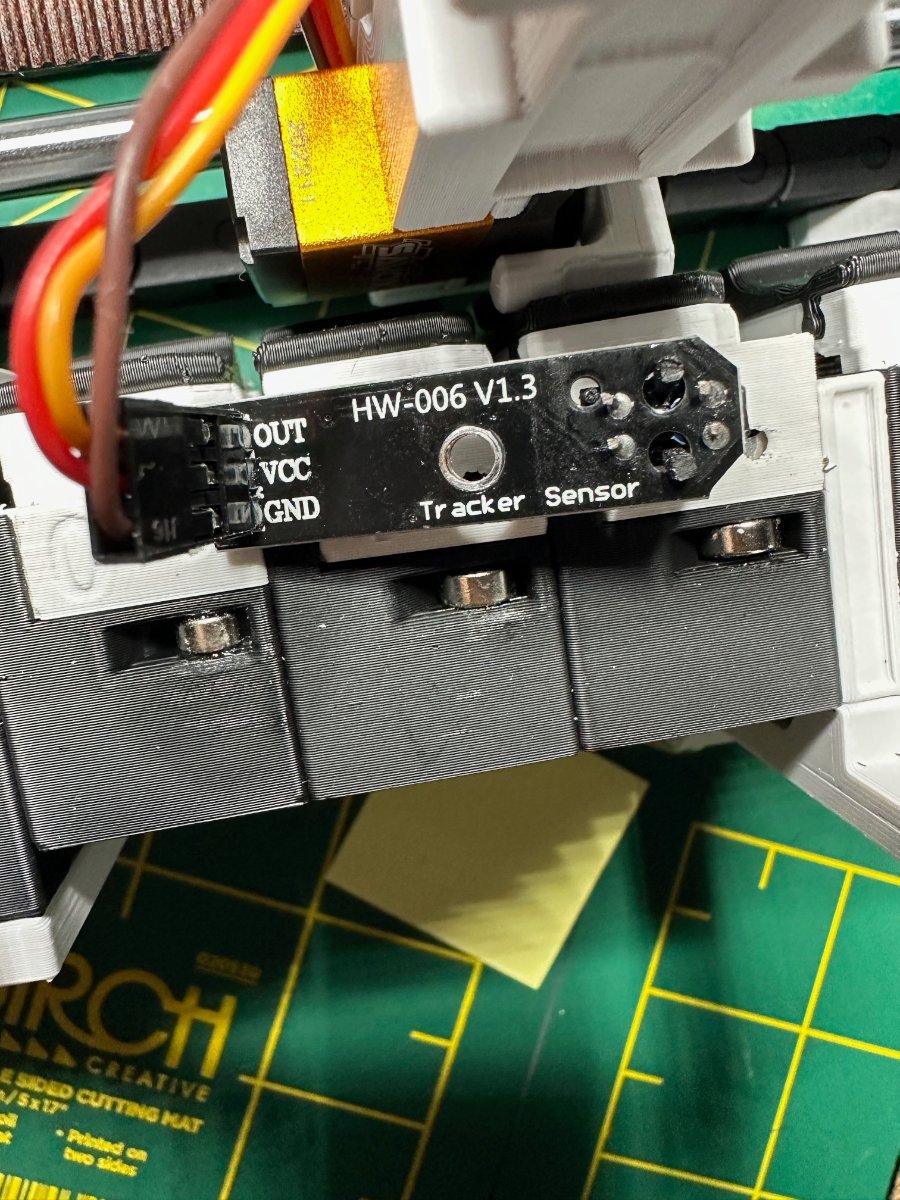

Got the new board and all checks up to the encoder check performed without issue. However, the encoder is "dead". Did some testing and it seems I have a dead TRCT5000 sensor. AS I bought this kit almost a year ago, I do not think I have much chance with Funsor on getting a replacement. Not good for them as the kit now has had both a faulty board (new board from Lektor in Spain working as intended) and seemingly a faulty TRCT500 sensor board.

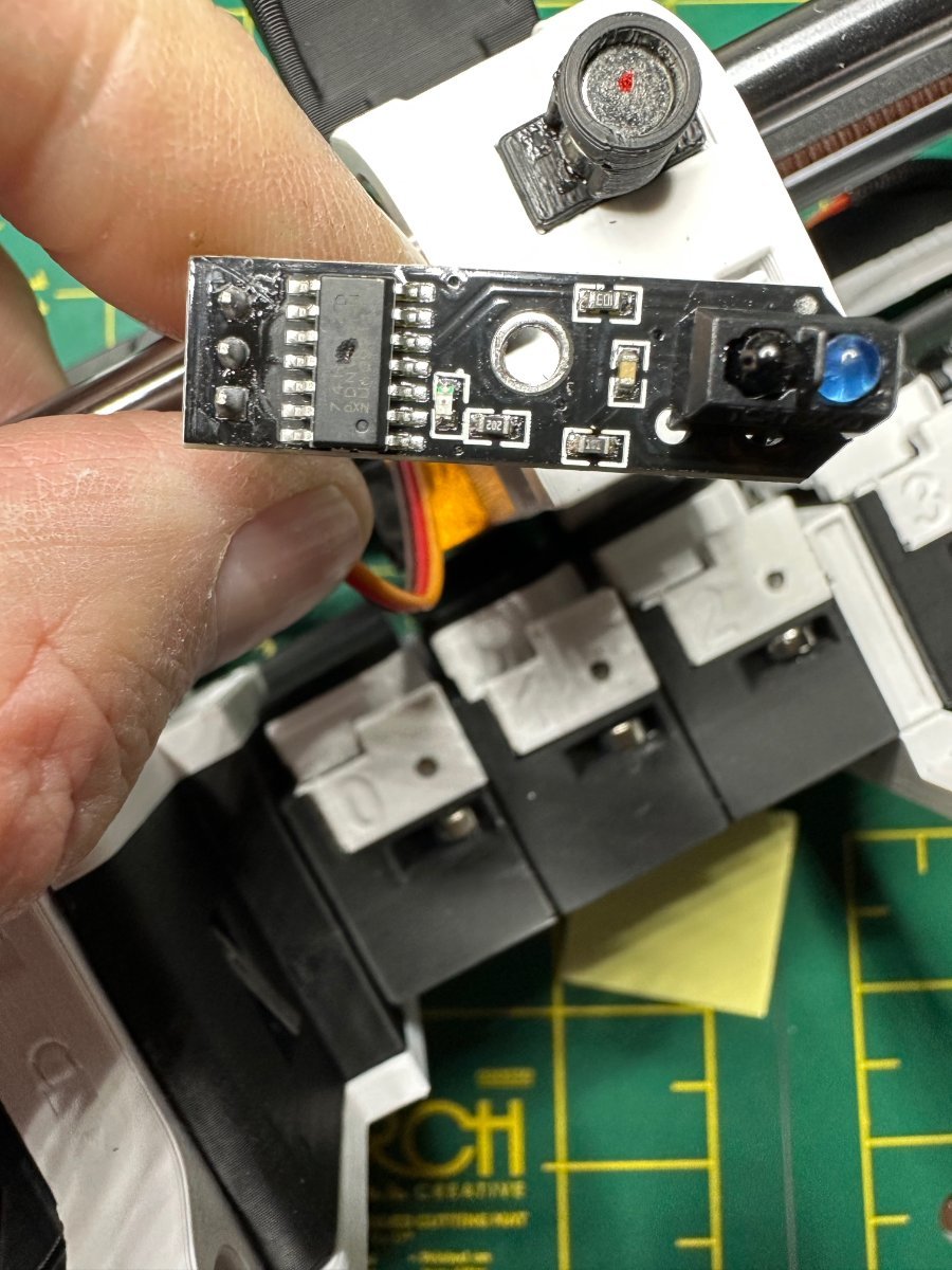

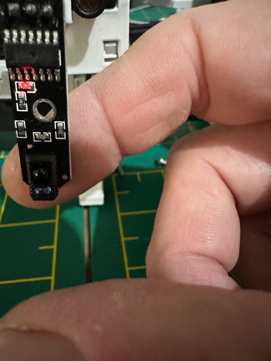

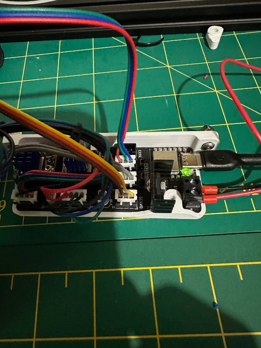

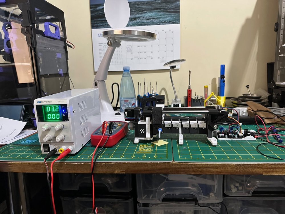

7 hours ago, Wick said:

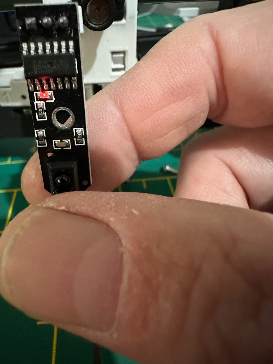

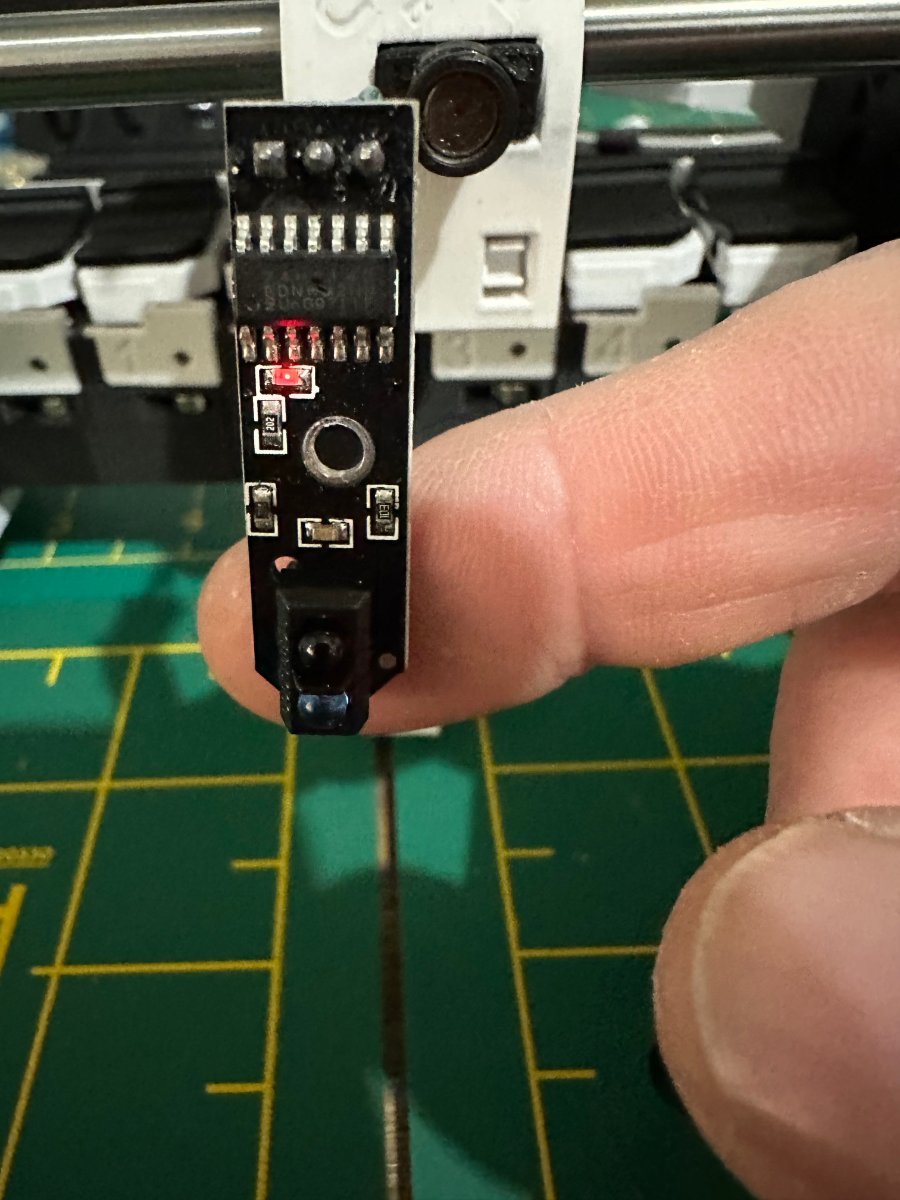

could you pls. take a pic of this?... and have you testet it on the bench?
Sure - here it is.
IMG_4059.thumb.jpeg.89509fcaa1674db2dc218ded43ce7f86.jpeg           IMG_4060.thumb.jpeg.8b61947b70a61e9b9fb53491621c6749.jpeg
Have tested it on the bench.
Checked all connections, re crimped another cable. There is power to the board as you can see,    IMG_4063.thumb.jpeg.453ad5819c6311f3d1bb60ad74744019.jpeg         IMG_4064.thumb.jpeg.760ef400bf8a983dc088fd3871069aec.jpeg
but the IR sensor does not trigger.
IMG_4065.thumb.jpeg.c9255cb6f1a08eb8f71ff5c9023d6360.jpeg      IMG_4066.thumb.jpeg.edd6241765c900e14158445c77efda73.jpeg
27 minutes ago, Wick said:
what I read is should send 1 on dark and 0 on bright surfaces, did you test with black and white?
Not with black and white, only with finger and in the encoder module through:
ERCF_DISPLAY_ENCODER_POS
Value stays at 0, no matter if sensor is triggerred or not.
Will try the black and white when I get home tonight.
Thought it may have been Voltage as the sensor is rated at 5V and it is only getting 3.2V through the Easy Brd. Haven't tested that theory yet.
Also the IR LED does not light up indicating a board failure.  Getting a new TRCT5000 board this evening, I hope - will let you know, either way.

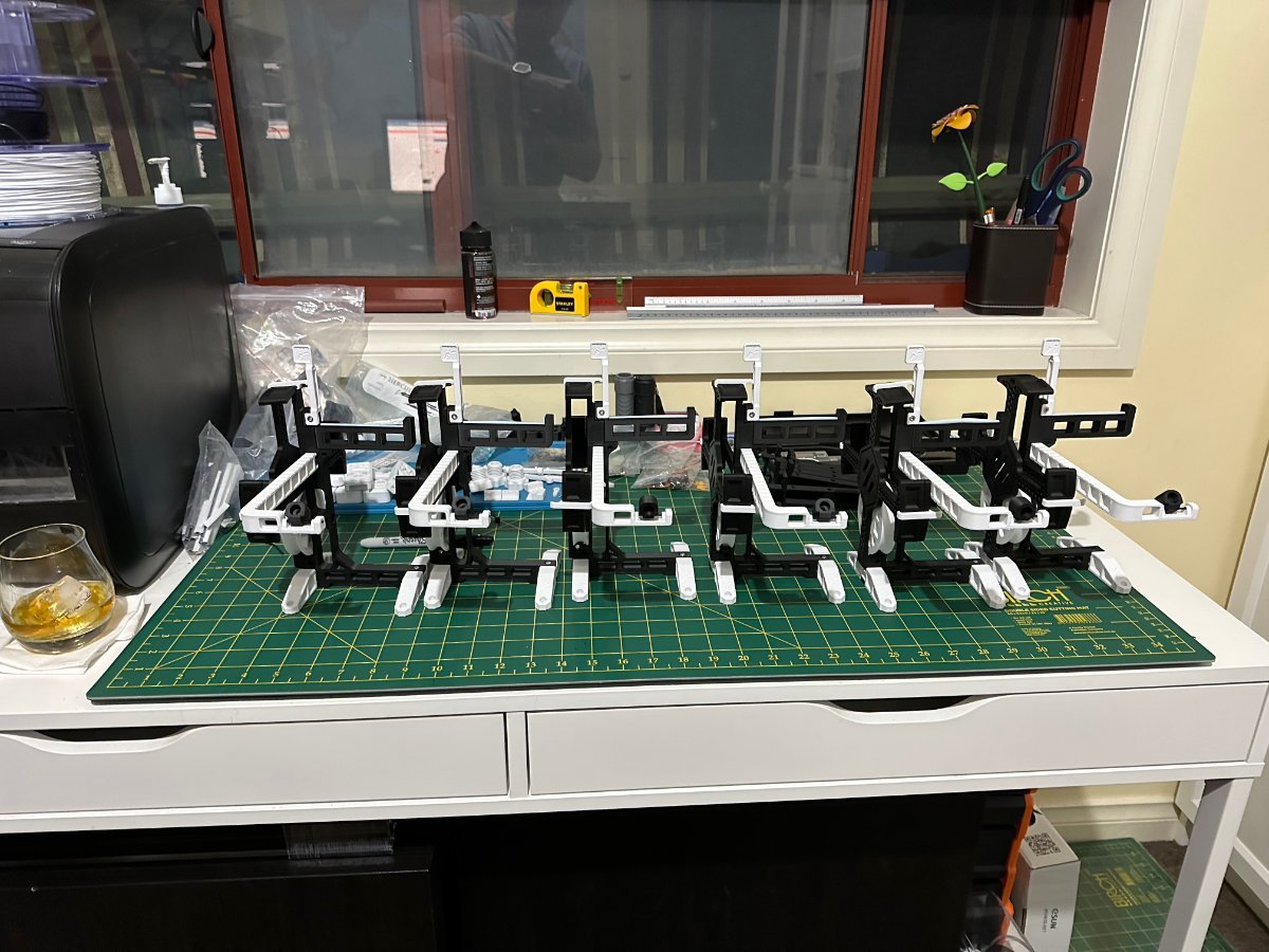

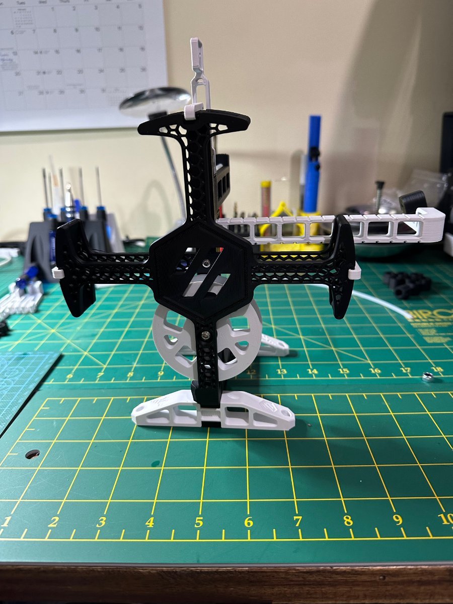

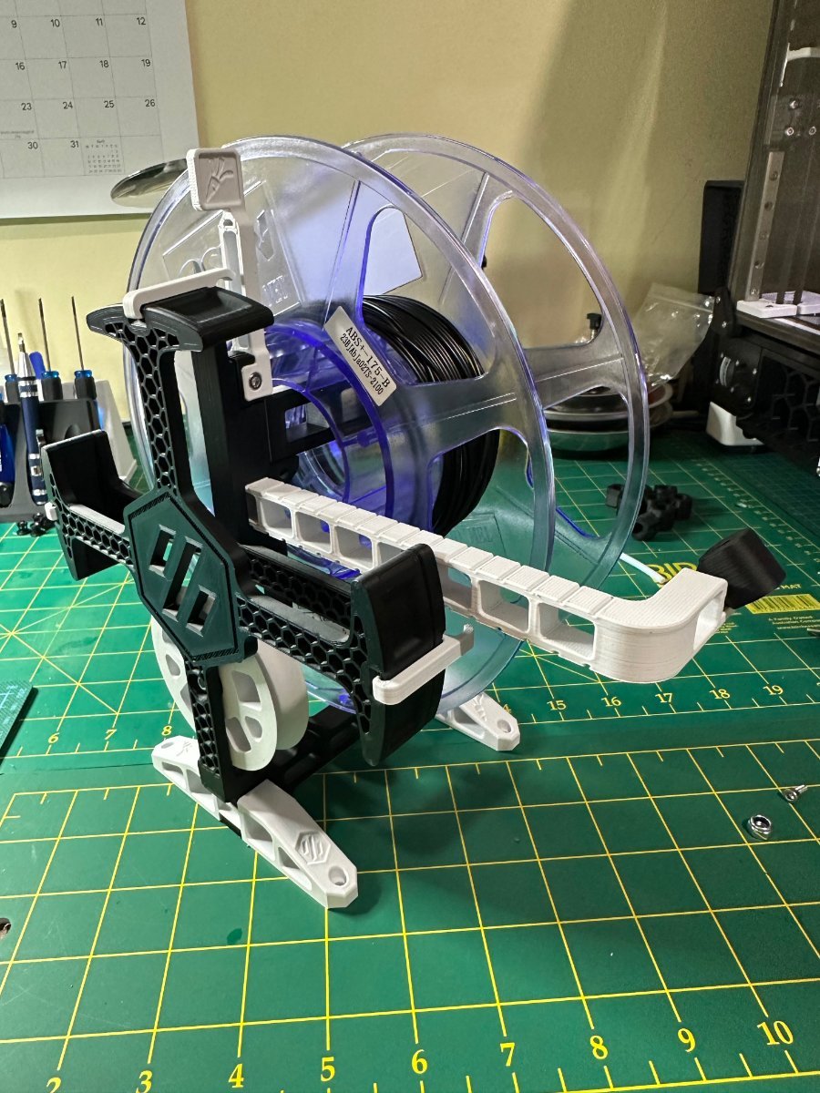

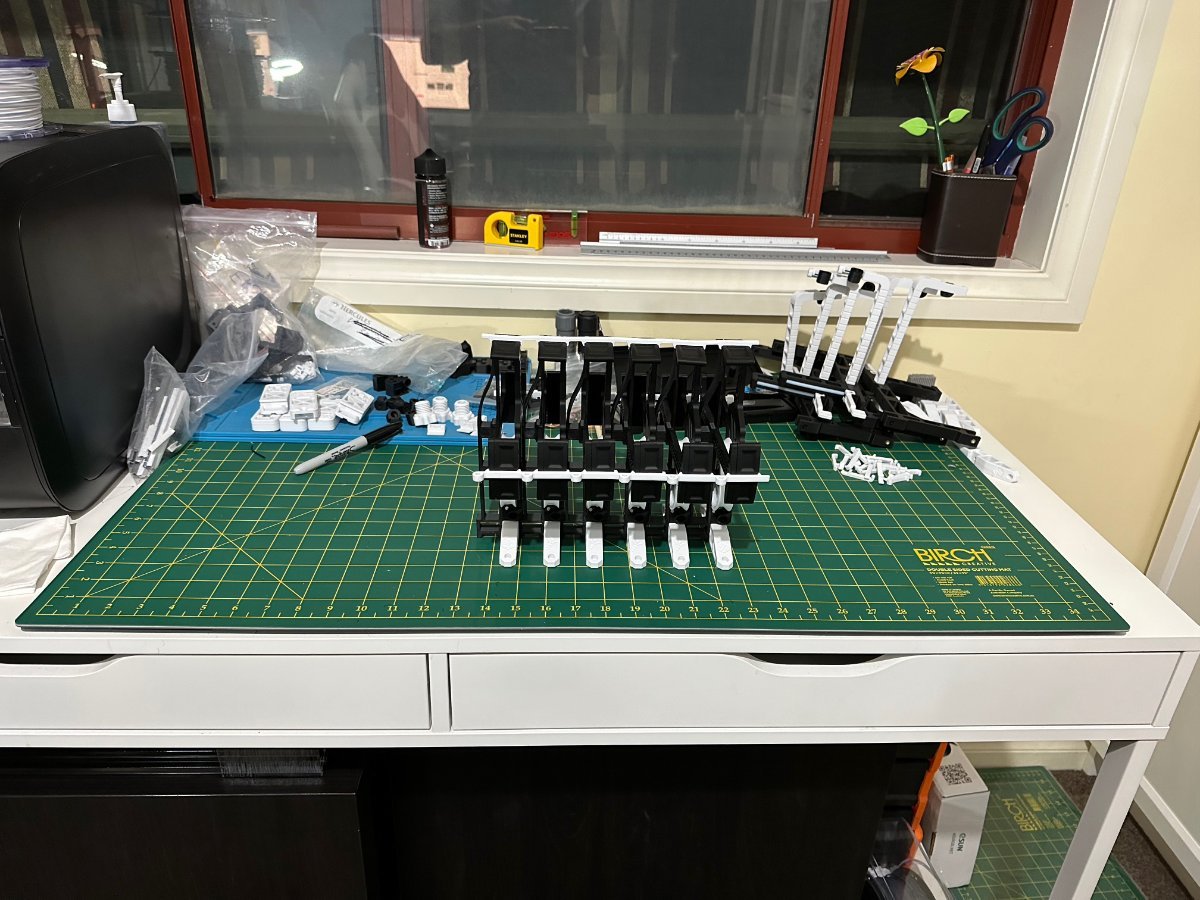

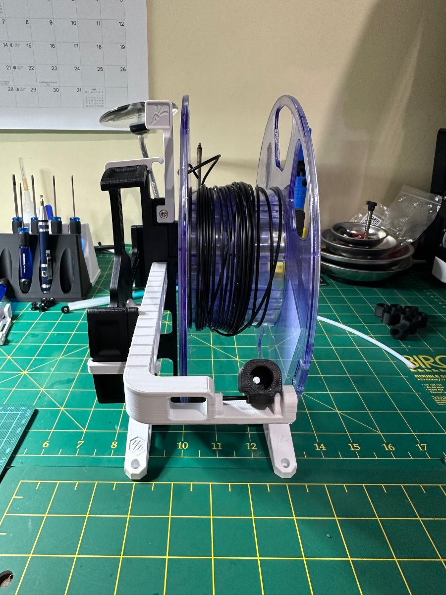

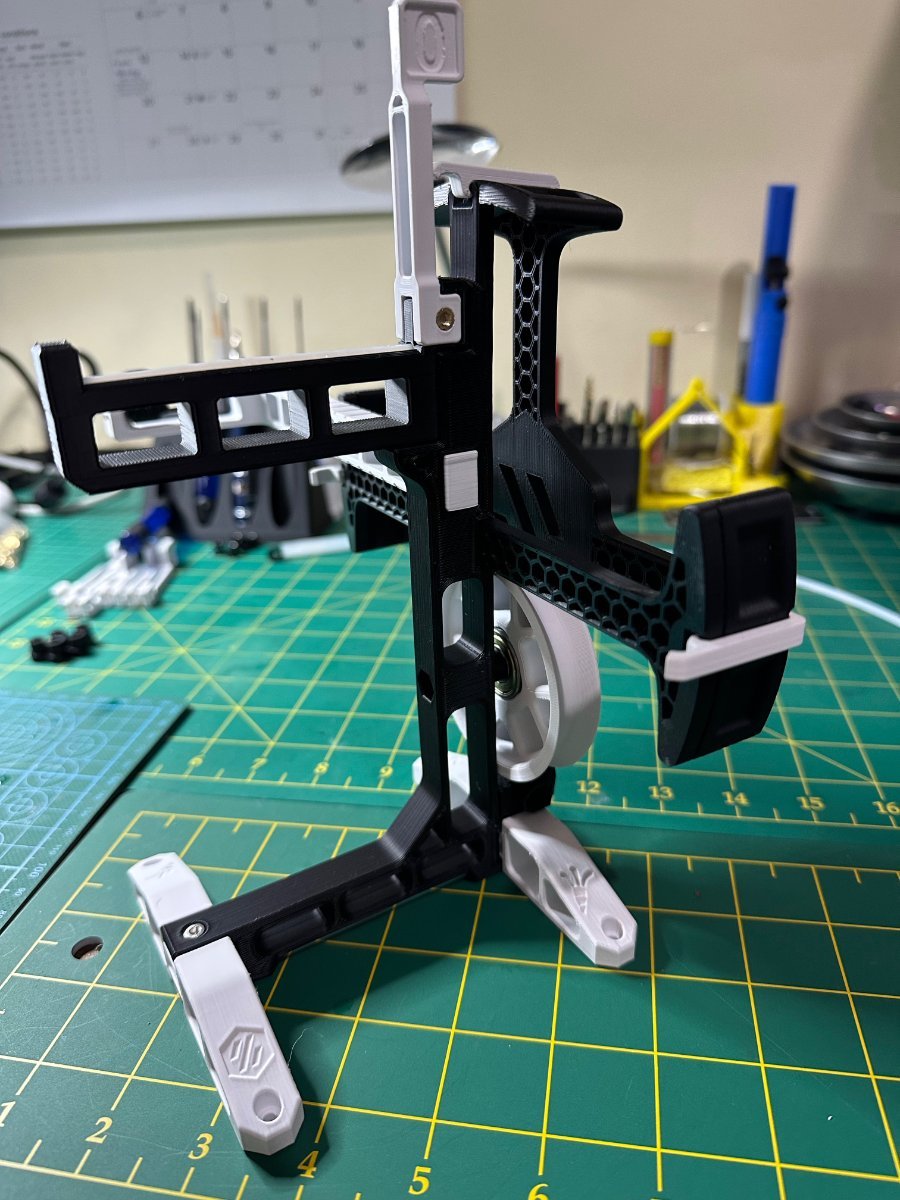

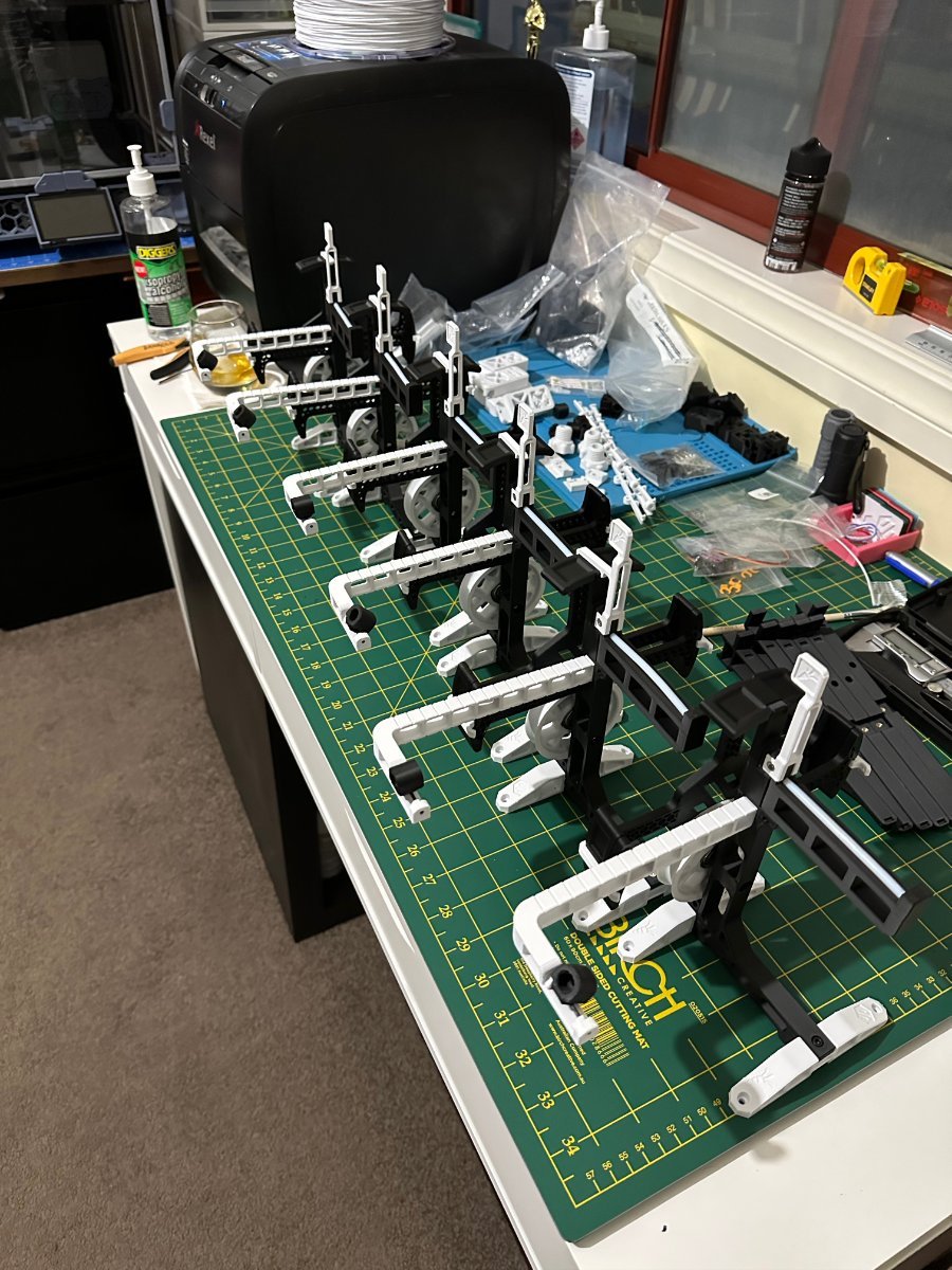

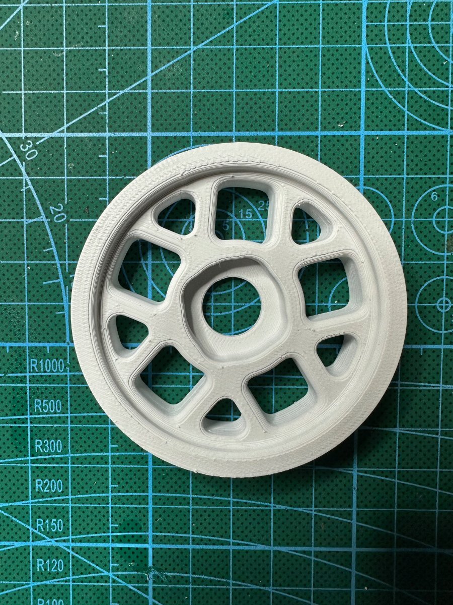

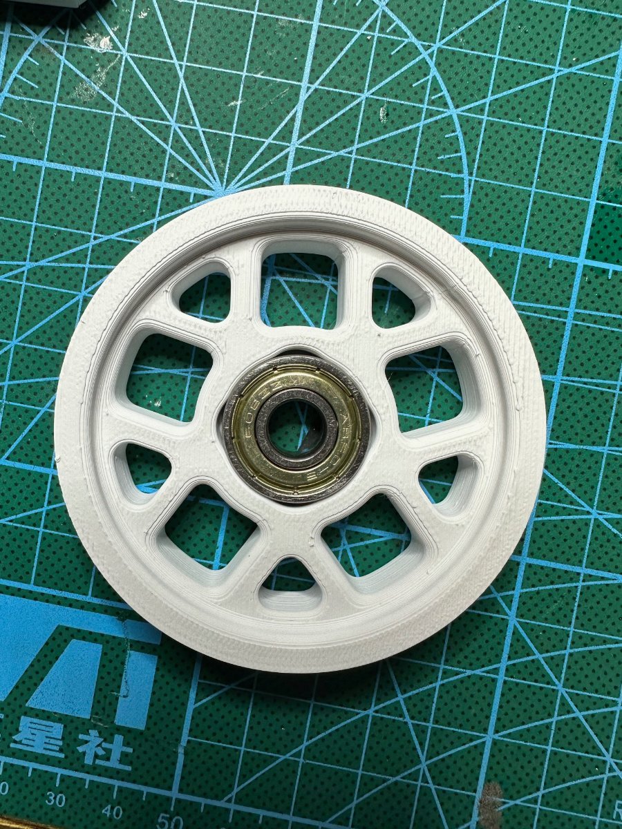

In the interim, I put together the buffer array. (6 spool)
Gone from This:
IMG_4069.thumb.jpeg.84828417e3ccb05e0a33ec33987a76dd.jpeg       IMG_4070.thumb.jpeg.7bc14f71bfe337342ac3a8659cecf32e.jpeg
to this:
A major improvement and saving in space.
Now I have lots of spare parts from the original.
Hopefully the sensor will arrive in tomorrows mail.
