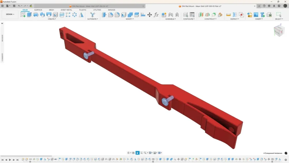

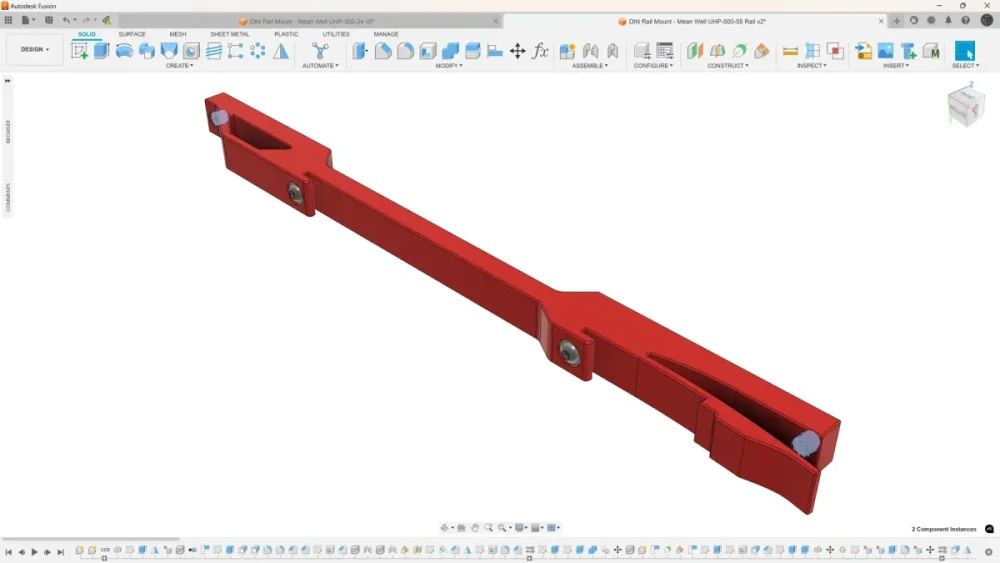

Install two M3x10mm Button Head Cap Screws with the M3 Washers ( marked in blue ) into the bottom of the Mounts acting as Reinforcements for the Hooks - The PSUs turned out to be surprisingly heavy and I didn't want to risk the weight of them pulling down on the Hooks causing the latter to become loose.
Install two Voron Style M3x4mm Heat Set Inserts ( marked in blue ).
The one behind the Securing Latch is a bit hard to get into - Use a longer M3 to help pull it in.

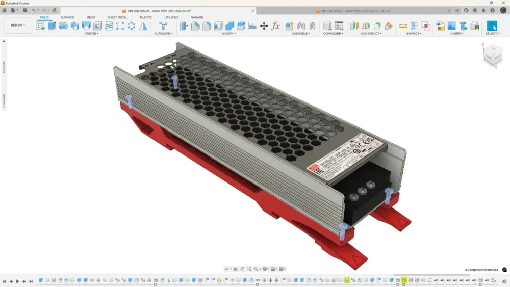

Attach the Mean Well UHP-350-XX Power Supply to the Mounts using the remaining M3x10mm Button Head Cap Screws.

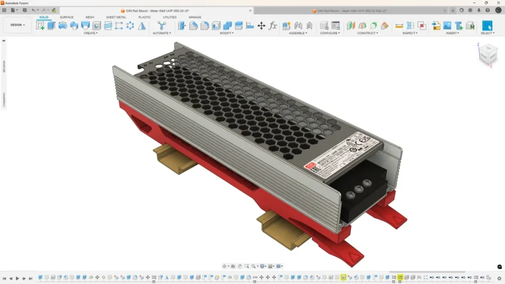

Attach the Assembly to the DIN Rails with a sliding motion while pressing down at the end with the Securing Latches.
To remove the Assembly, pull the Latches slightly up followed by sliding it back out.
Word of Caution:
This Design requires the distance between the DIN-Rails to be of proper length!
Too far apart and the rear Hook will prevent the Locking Mechanism from properly seating onto the front Rail.
Too close together and the rear Hook might not catch.
As such perhaps consider using the Mounts themselves with setting up the required distance between the DIN-Rails.
