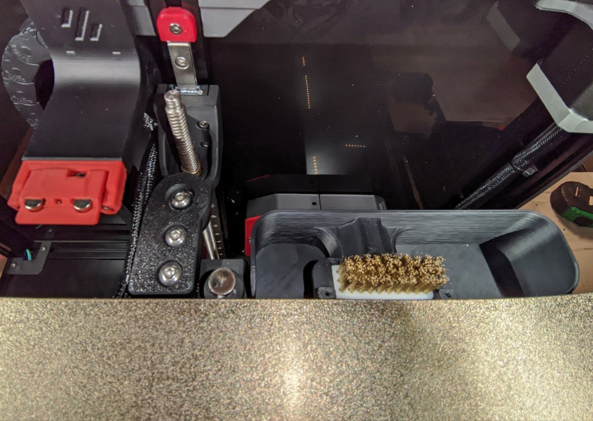

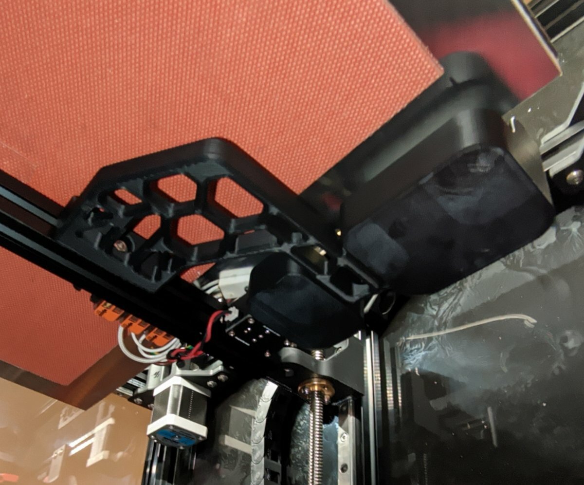

I've created a Trident mounting bracket for Decontaminator... As it's designed to be mounted on the right side of the extrusion the Purge bucket needs to be mirrored so the small bucket shows to the Z-axis end stop.
Pls. add 2 small supports for the 2 guides on the extrusion side.
It needs 1 pc. M5 x 10 + Extrusion Nut and 2 pc. M3 Heat-Inserts
Have fun, Wick!
