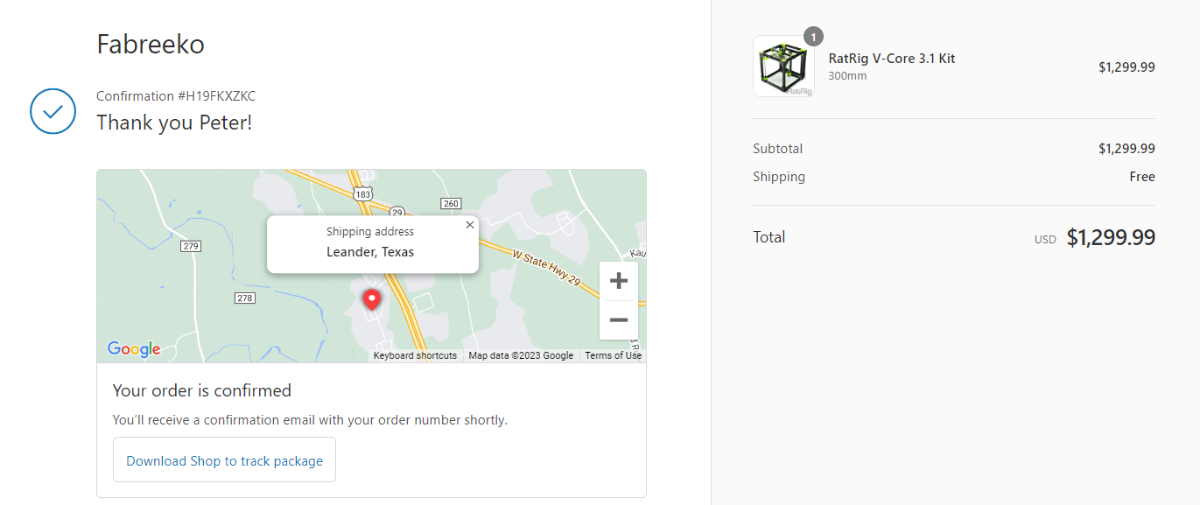

  1. For some unexplained reason... I felt an overwhelming desire to build a Black & White printer. Step 1 complete... Here we go...

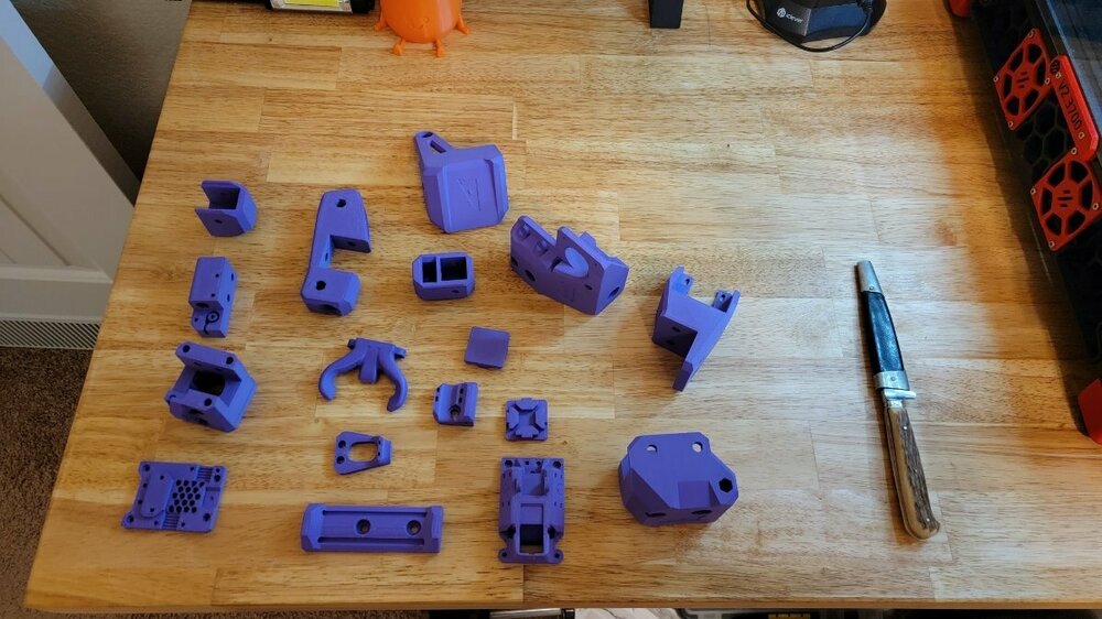

  3. Welp... Venturing into uncharted waters again. This time something new and something different. I started printing parts right after I ordered the kit from @Fabreeko_Hector. The kit comes with printed parts but, I want to build this printer with parts that I printed. I don't know... do you think that's cheating? Some of you already know what it is but for now I'll let you guess, it won't be too hard to figure out. First bunch of parts. Filament is Polymaker Polylite ASA Purple, Noz=240c - Bed=110c, Speed was 40 mm/s 1st layer, 150 mm/s - 3000 accel for everything except the outer perimeter and top which is 60 mm/s. Chamber was ~43c. I would say the results are good but not great, definitely acceptable. Still need to print a couple more purple parts and a few black parts and hopefully... I'll have them ready for this weekend.
