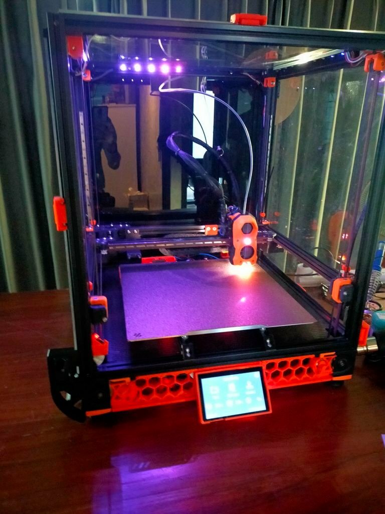

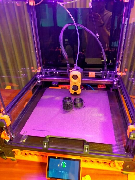

My 1st Voron 2.4 R2 350 self source
Pradit
13 hours ago, Pradit said:
I think I had more tools than the actual Voron's parts.
you can never have too many tools . Remember the saying - He who dies with the most toys tools wins...🤣
On 1/9/2023 at 3:48 PM, Pradit said:

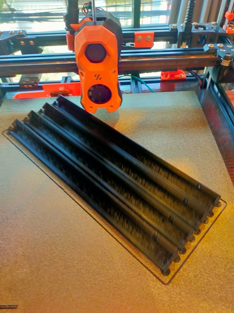

These skirt took 6 hrs+. They came out good for me. I wonder what is
average printing time for anyone?

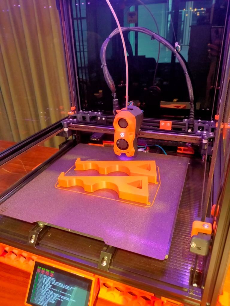

Would say it is if you are not in a speed race. To me quality is more important than speed. This 300x300 plate took 6hours - standard Voron Settings at 100mm/s.
Ok now i know how general speed and time use for print.
Thanks.

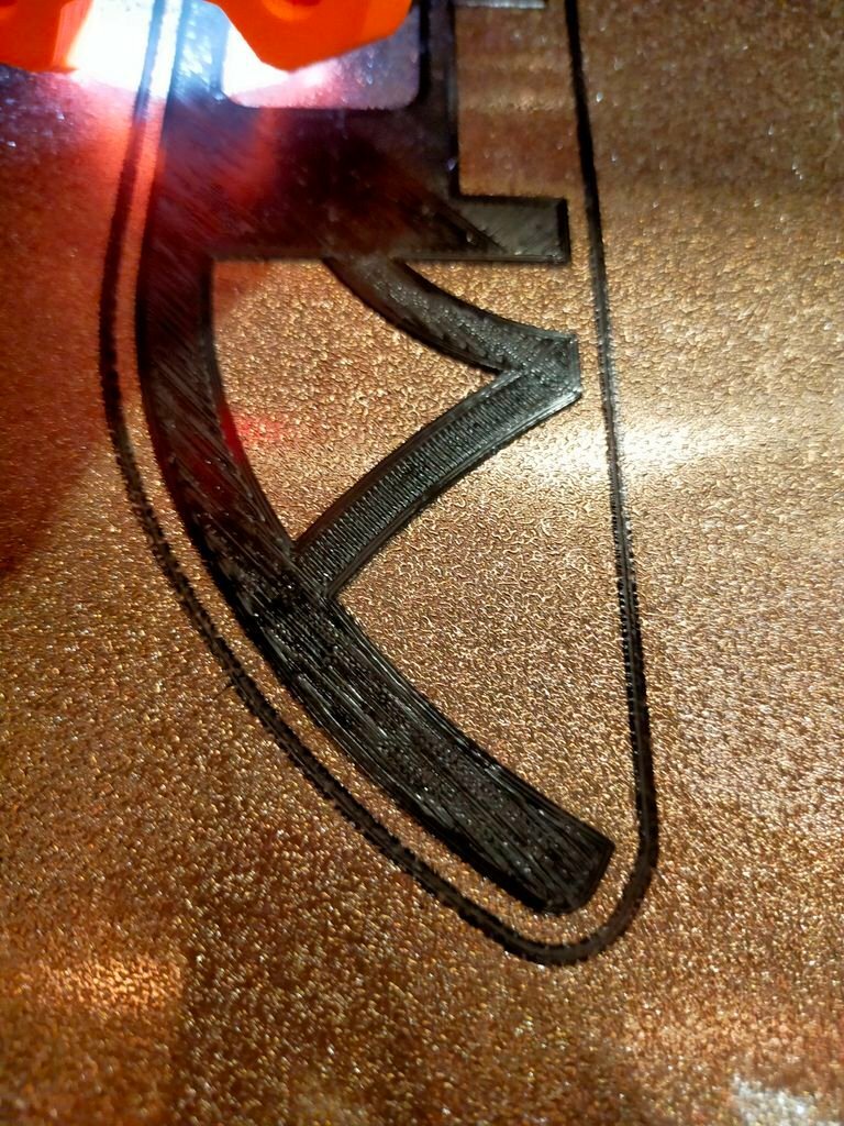

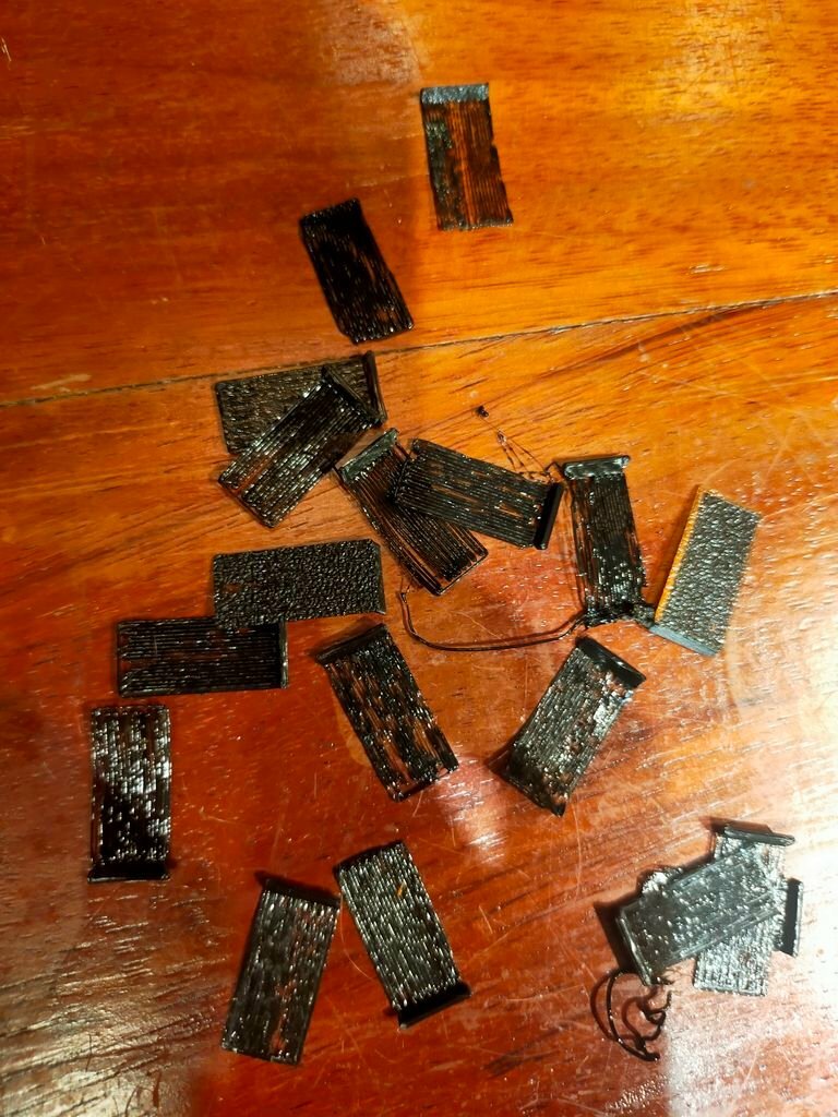

Despite a bad quality new PLA I got.
I had opportunity to learn from all the mistake and people helping me.
I leaned that I need to heat soak the bed for almost an hour before run QGL.
Each brand PLA temp different and have different behavior. Yet I doubt with the same
brand differ spool or color act different too?

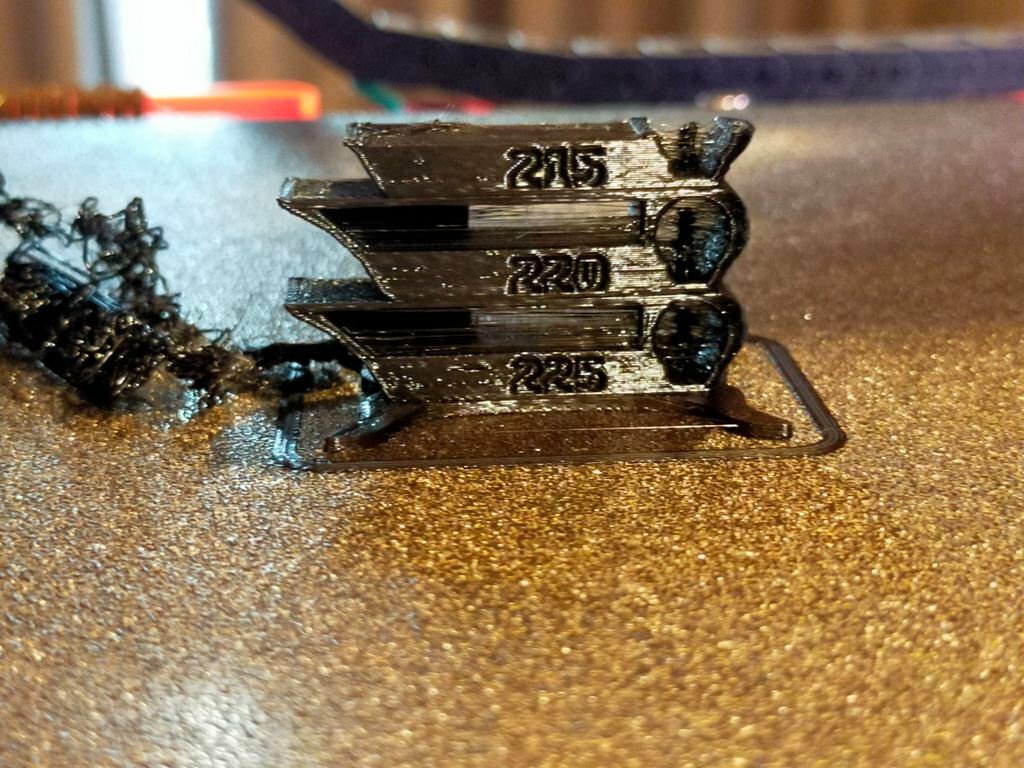

Now with this PLA (Black) I had many print failed unlike previous Orange PLA +
Same brand but order from different shop.

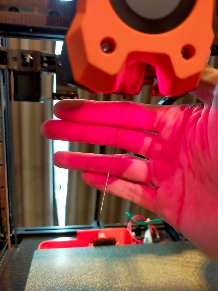

This PLA create a lot of ooze or strings.
I had to increased bed temp to 70c to be able to stick the 1st layer.
These all 55-60c bed temp and all non-stick.
I could never success the temp tower. But I currently use 190c-210c.
Without proper heat soak or QGL while heating or some screw loose or belt not tighten.
It lead to this problem klicky not click.

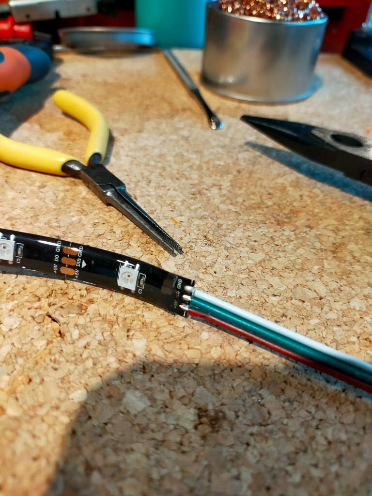

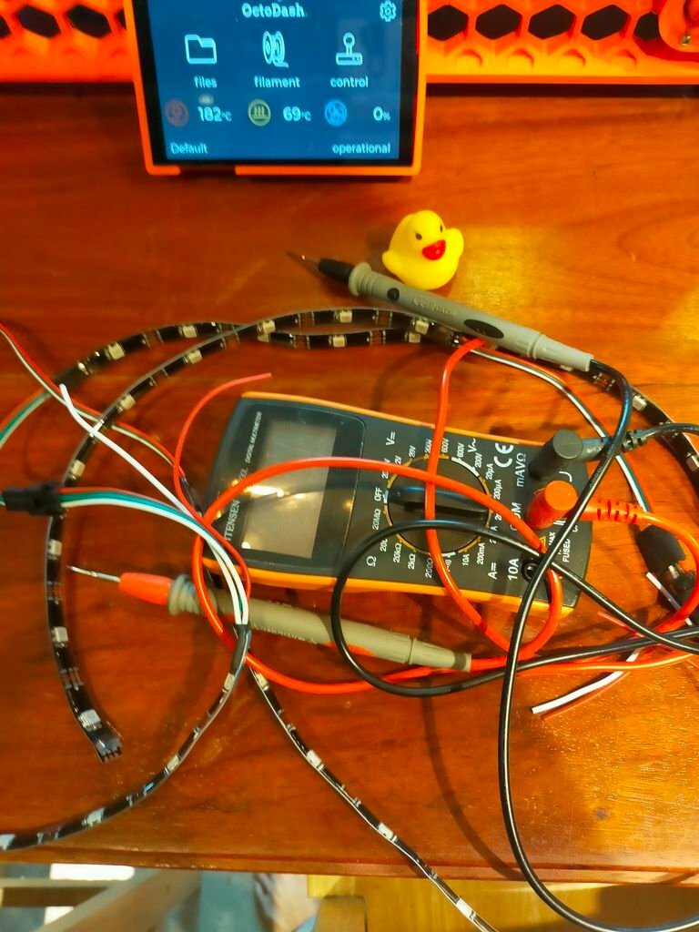

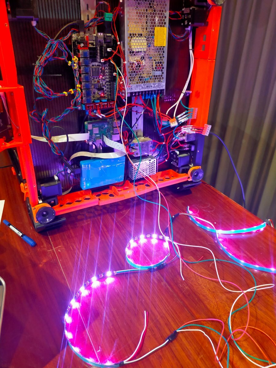

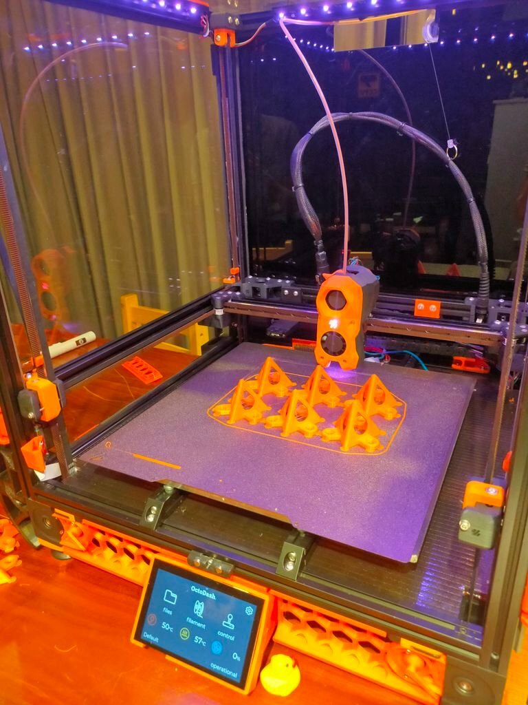

LED... It makes you print faster!!!
LED mount.
Continuity check.
I'm getting a little bit better in soldering. 😄
It is quite confusing about RGB, WGRB, GRB, GRBW, LGBT....
How would we know what we are???
Finally with a good guide here: https://www.teamfdm.com/forums/topic/1014-a-good-tutorial-for-installing-chamber-lights/
Let there be light!!!

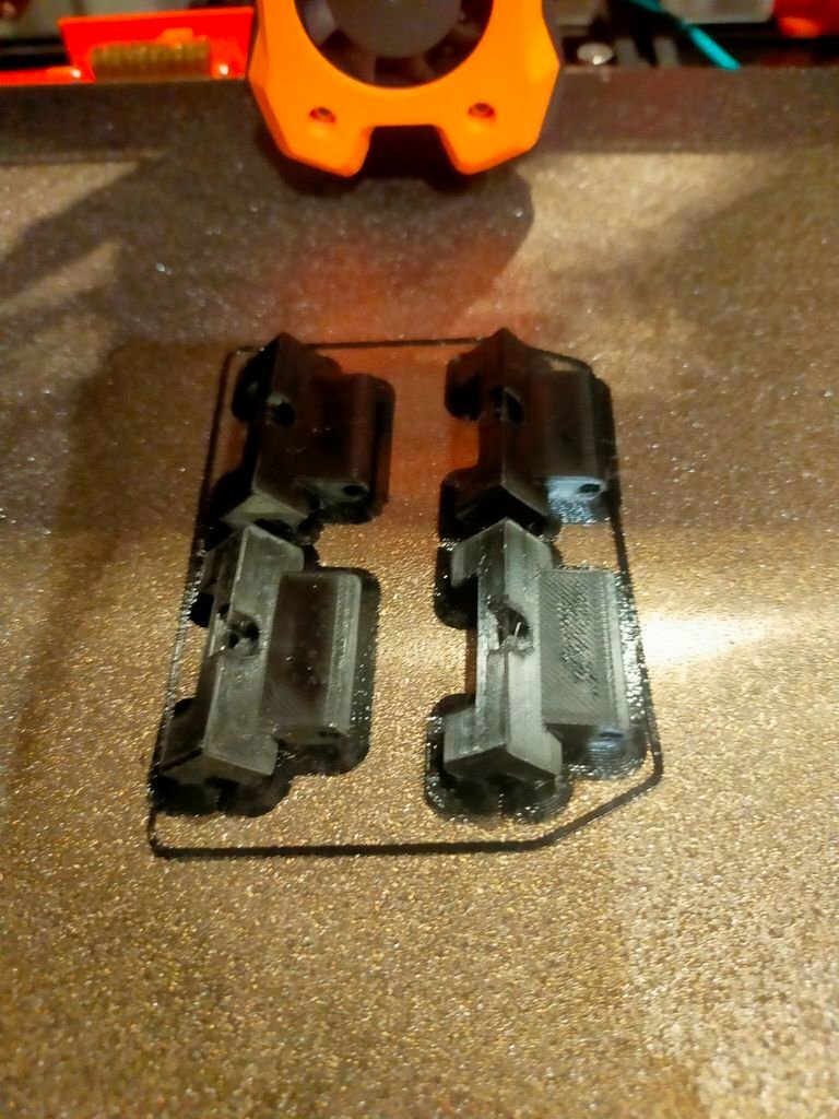

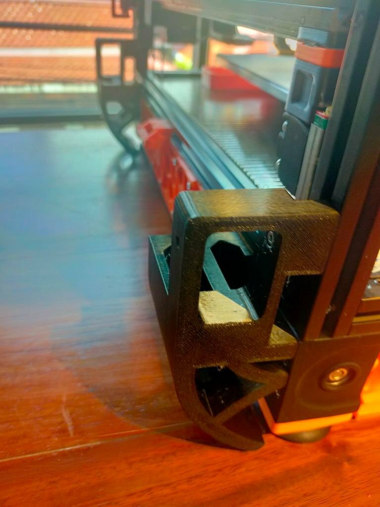

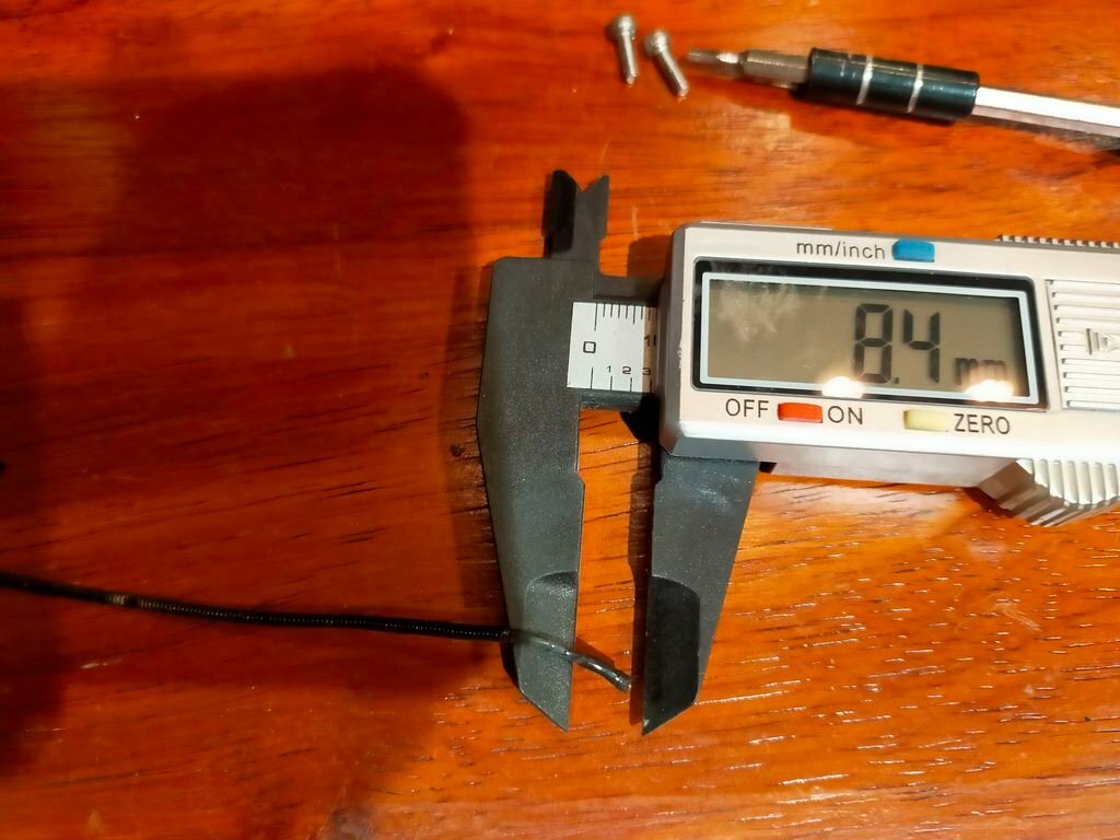

More removable latch. I realize I need 5.5mm not the 6mm one.
Yet another canbus cable mount. I was in a journey finding holly grail.

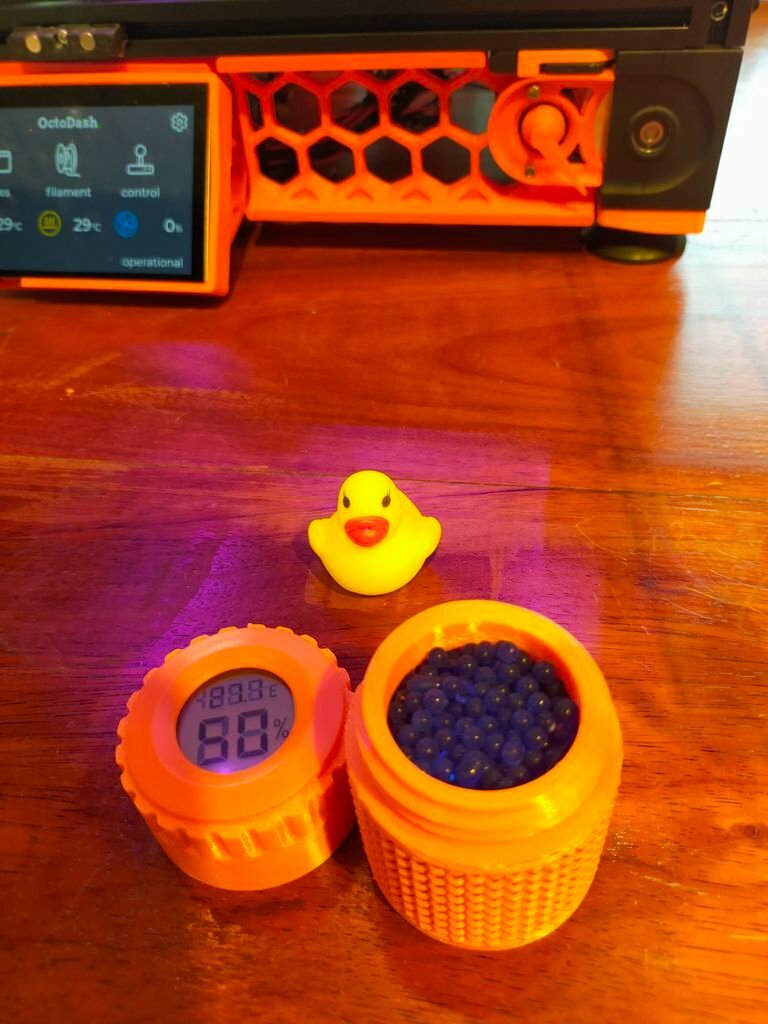

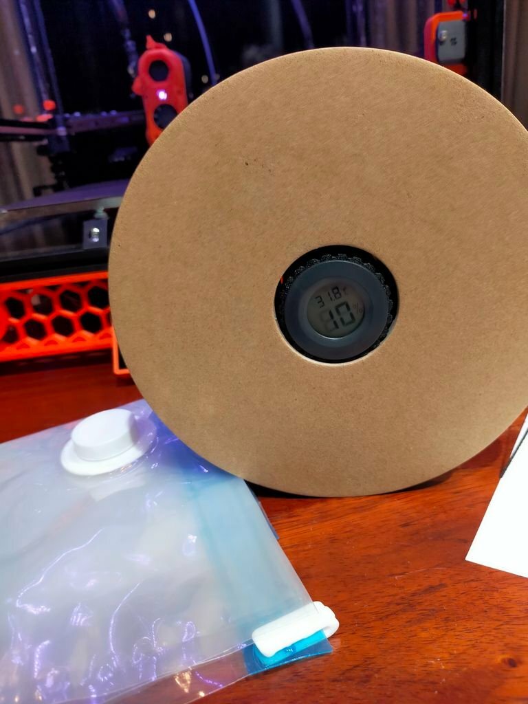

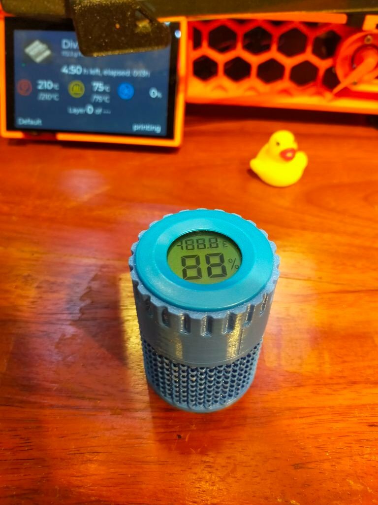

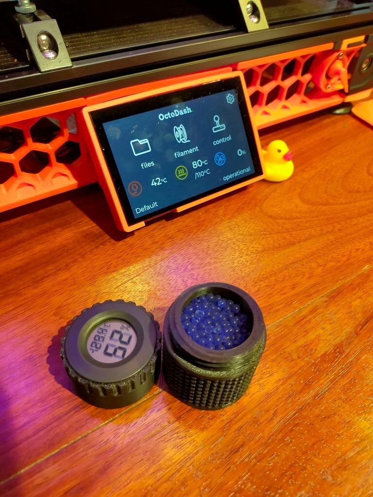

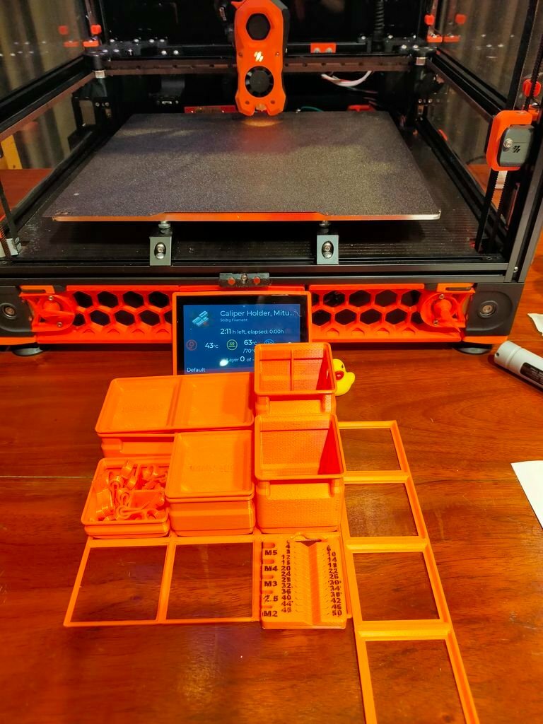

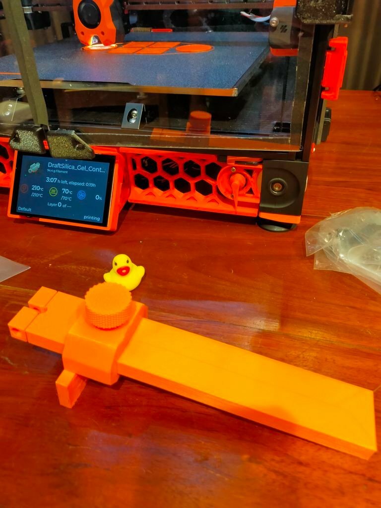

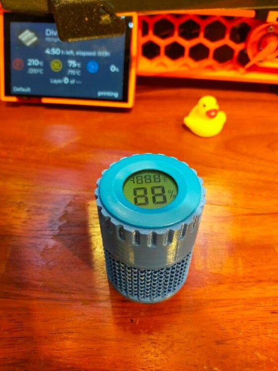

Silica gel container.

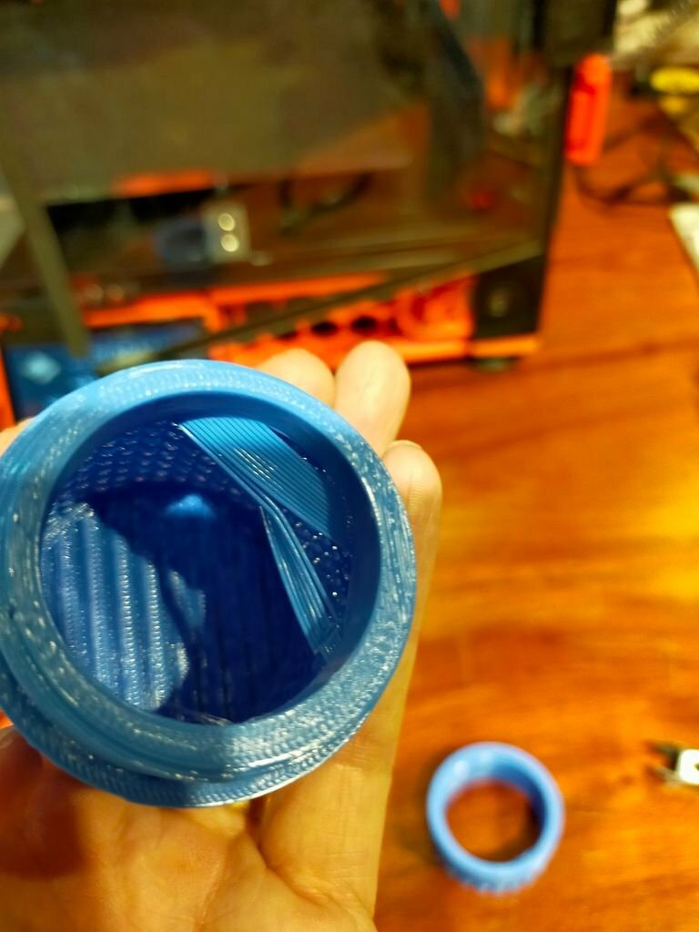

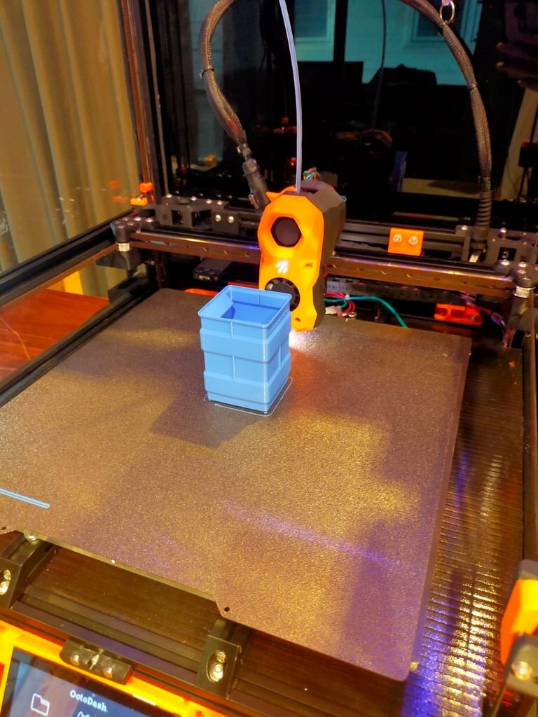

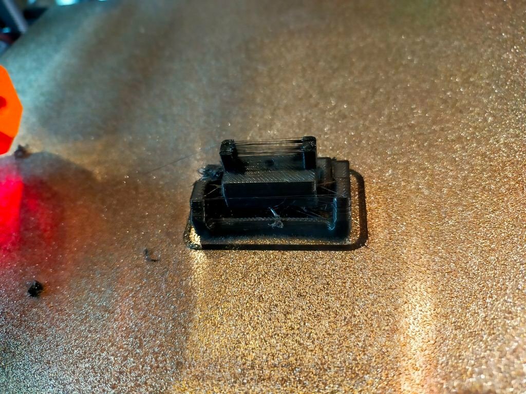

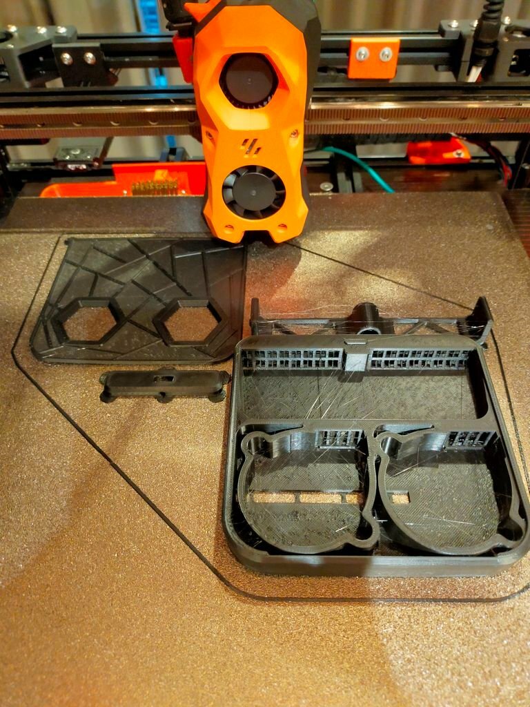

This 2 hours+ print.
This 1.20 hr print.

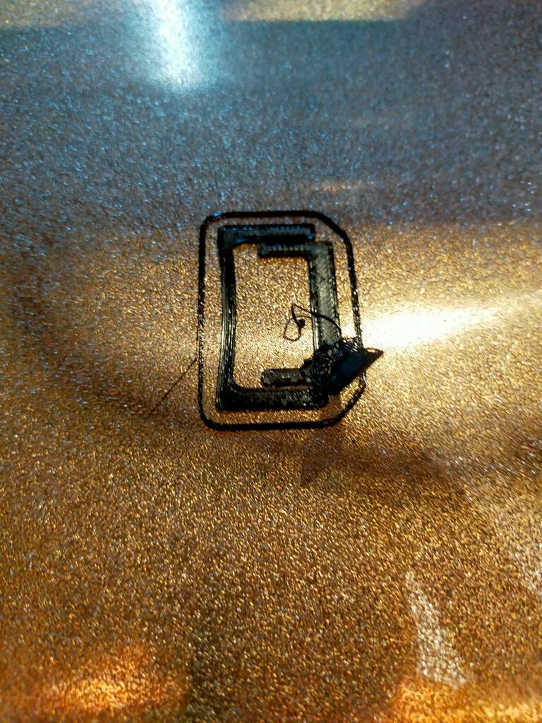

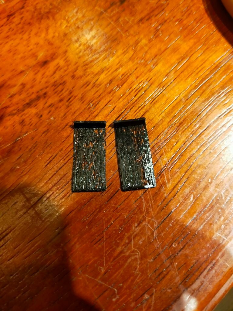

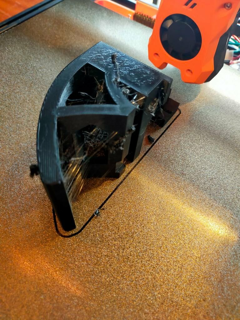

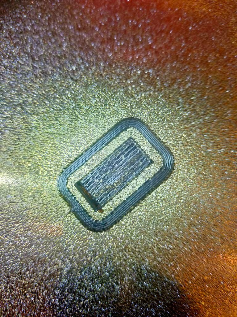

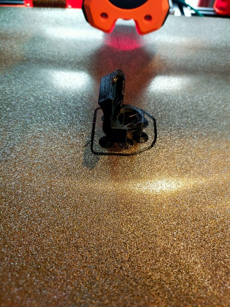

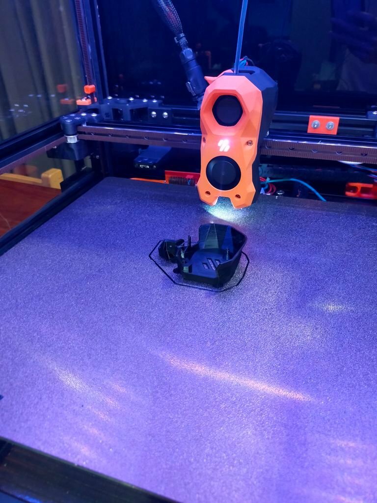

What could cause this? I'm using arc_welder plugin too.

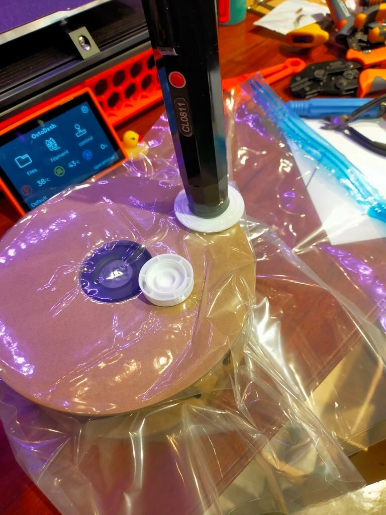

I found the manual pump that came with the bag much faster.

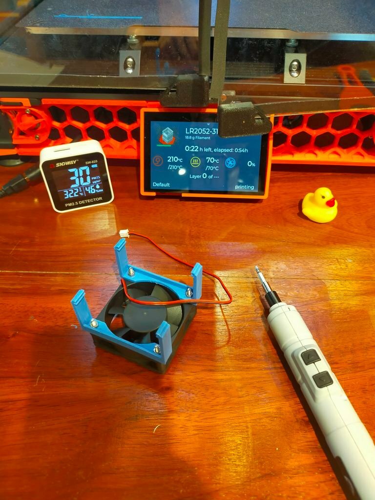

I noticed my RPI temp go over 56 to 60c.
It's time to put fan on it. But I have no heat sink at this time.
Decided to print this mod for my RPI3B+.
But it was too wide ment to be fore RPI4 I guess.
I just Ziptie it at the end. Now 45-48c.

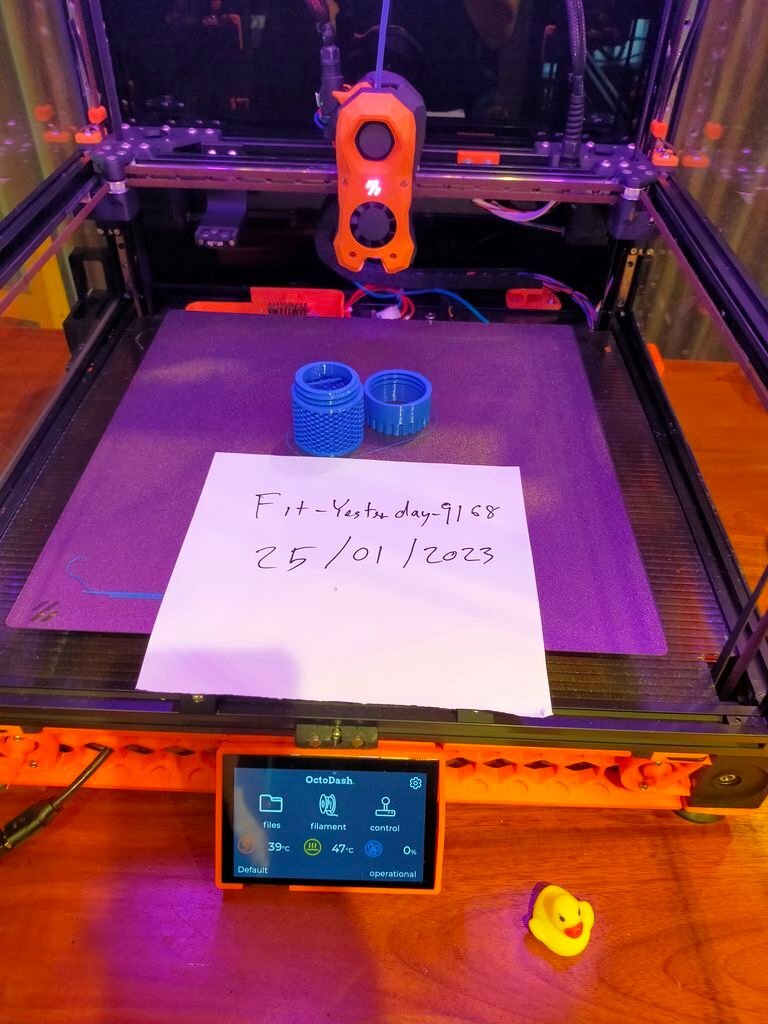

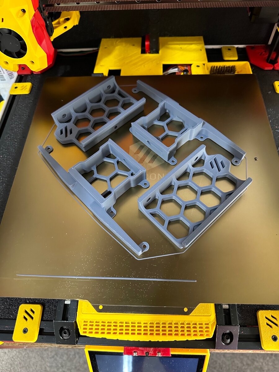

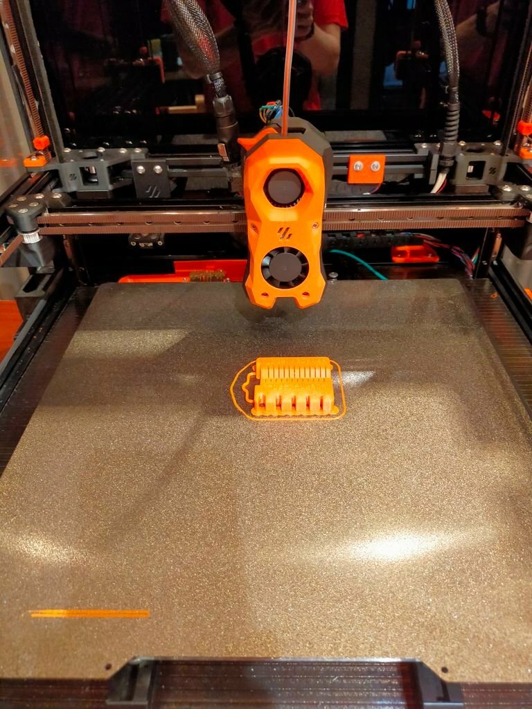

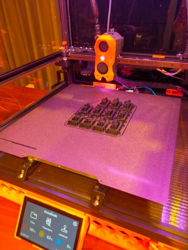

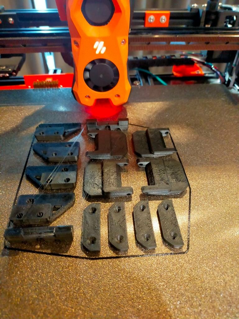

Im still find the sweet spot for my slicer quality with speed. Just try the vast mode for this bin.

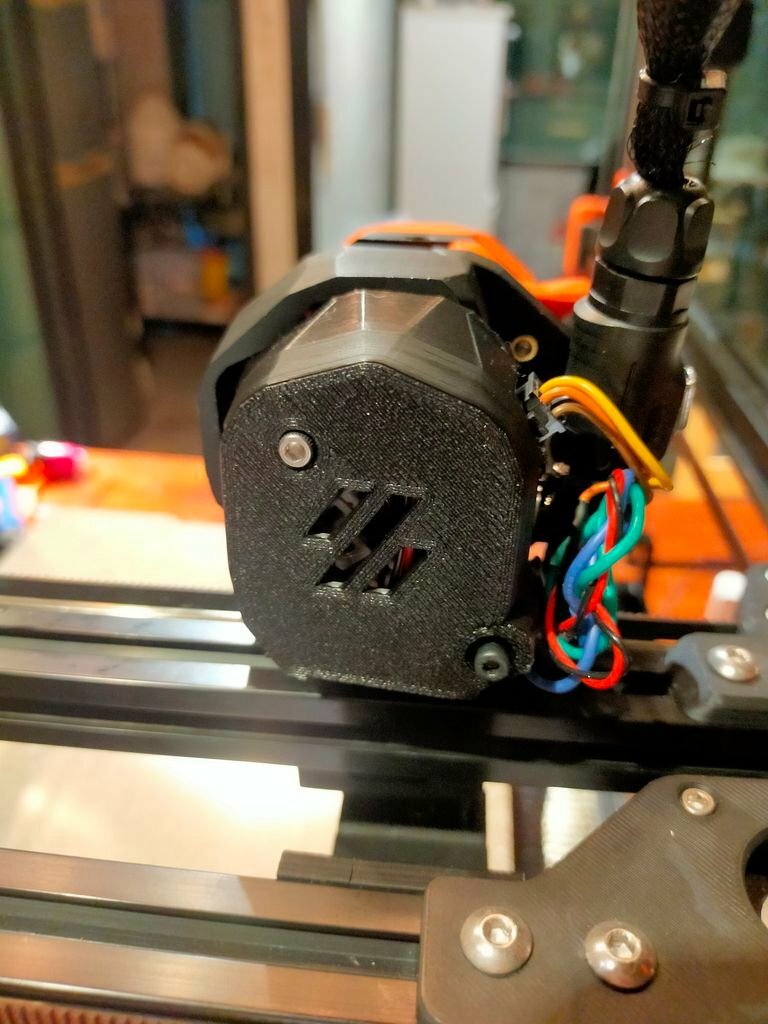

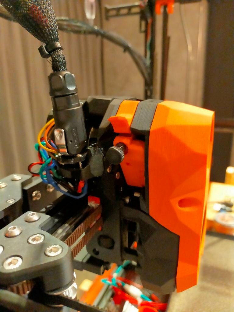

Yet another EBB mount my holly grail. The 1st one the hole not right for CW2.
The 2nd one just not fit my MP12 aviation connector I had to hot glue it.
This one I can screw it and see how it go.
With the cover there are something to be warn.
Since I'm using sensorless homing.
This could have effect on the Y when hit the back and hit the umbilical.
And again when home Z it could hit the bed... 😞
The screw on this cover when tighten it effect the front screw.
It could loosen the hatch that unable to snap properly with the filament.
https://github.com/jimmyvegas29/Voron-Mods/tree/main/EBB36-Cover_Umbilical-QD-Bracket

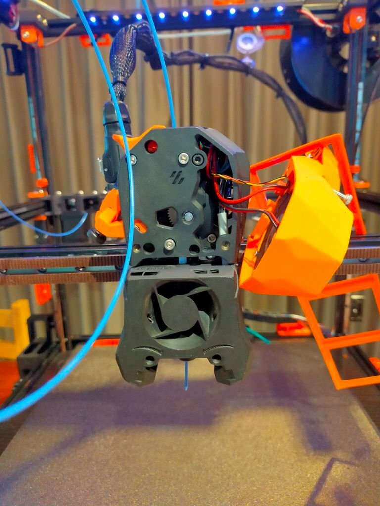

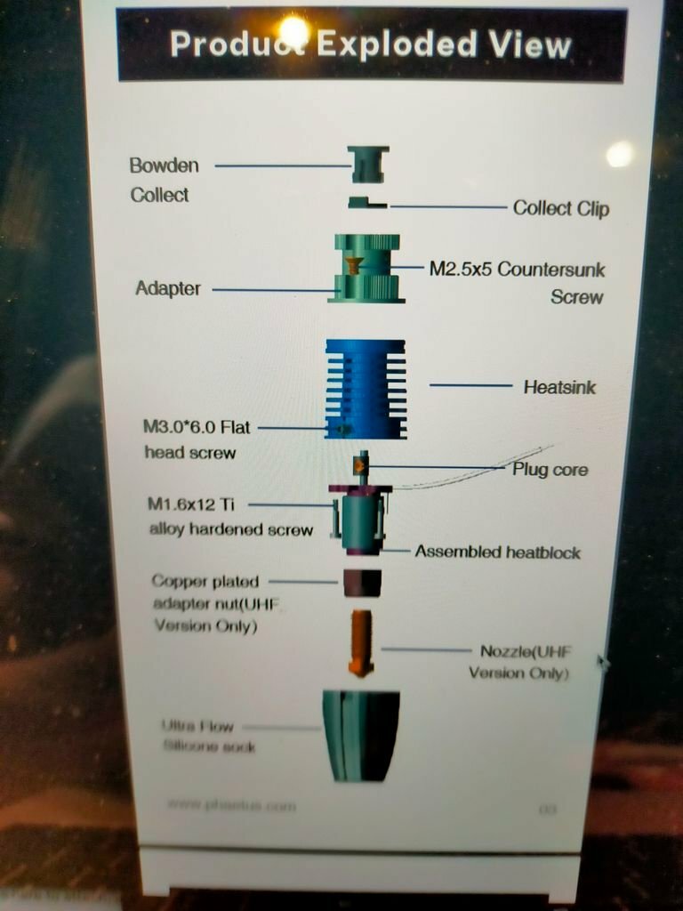

OK Back to the lesson learn from the bad PLA and my noob knowledge in 3d printing.

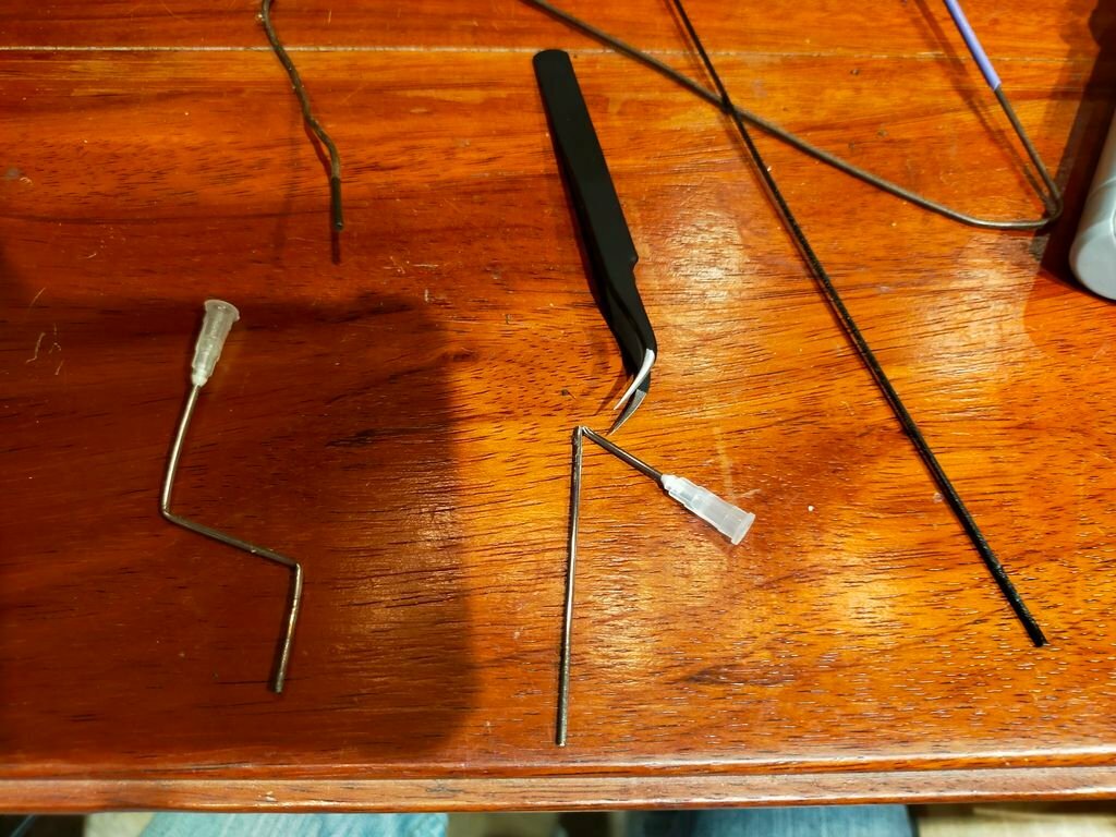

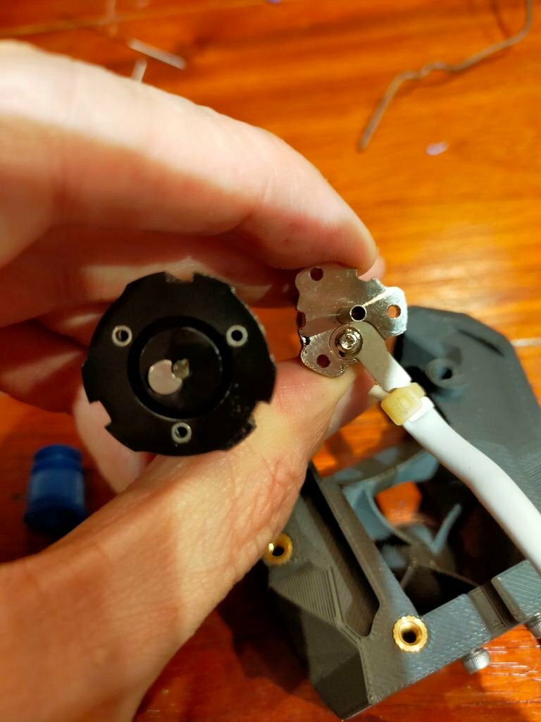

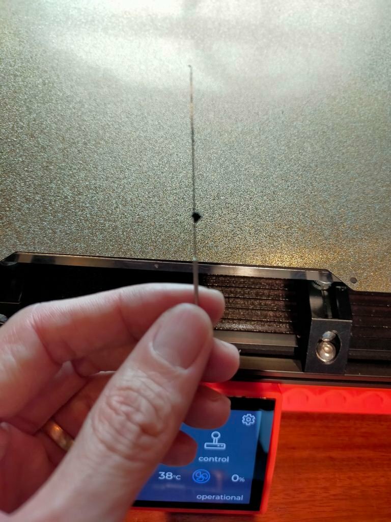

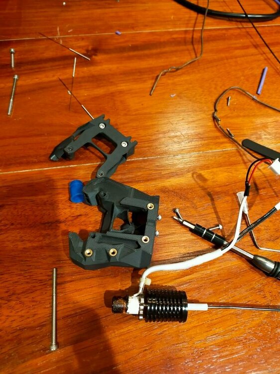

# Clogging

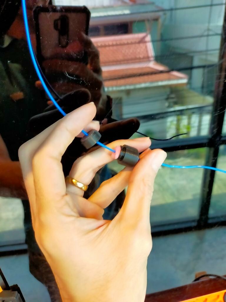

This was the 1st clog for my printer since build. It's just DEFCON 3.
I poke till it out of my Rapido.
Still some stuck at the top I had to pull it out.
I didn't learn then.
It lead me to the DEFCON 1.
The mother of all clog!!! MTF!!!
I did everything to get it out like before but It still stuck.
I pull it too hard the the filament broke.
I did everything with needle, bike cable, cloth hanger rod.

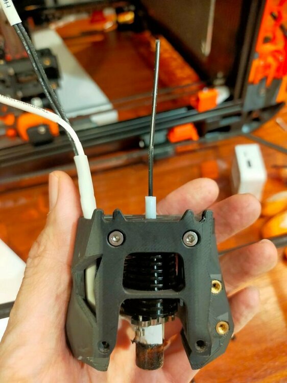

Till I decided to take apart everything.
These are all my brute force...
It stuck in between the heat tube and heat break area.
I guess coz I retract too much when print end.
As I asked in other thread it only happen when print end.
But this time I wanna change spool with new color.
Then I thought I resolve this issue.
Put everything back and NO!! still clog.
It was too late at midnight so I signoff.
Next morning I took apart again and now I just blow torch inside and use
Bike cable and got it out.
NO still can't put the filament through it. It seem the cable was too small.
So another blow torch and use cloth hanger rod. Yeah MTF out.!!!
