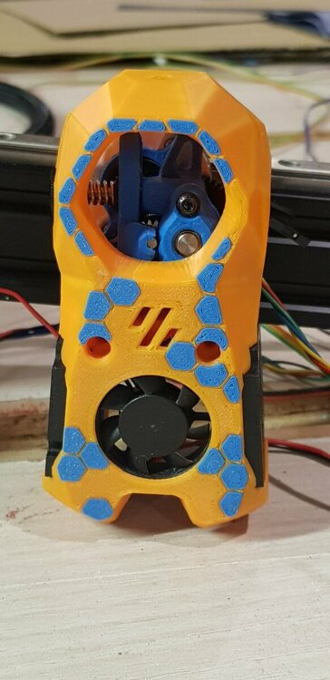

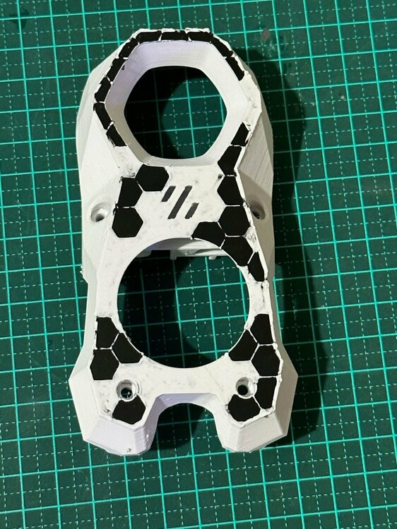

I had already been working on it when I saw your post. This should work for any of the Mini Stealth shrouds. You just need to merge and use the 'negative body' feature in Prusa Slicer.
I tried the 0.4mm thick version but you can see that the orange doesn't squeeze into the small gaps very well. I will print another one where the second accent layer is inset so there is more clearance for the nozzle. Plus I need to work on my first layer squish, I didn't notice it until I saw the pic on the computer though..

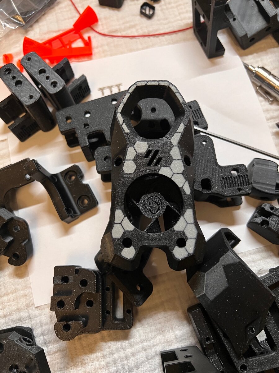

Only thing it gets dirty. Printing black skirts at the moment - let's see how it turns out. Busy printing the stealthburner hex pattern

So I get it... print the hexagons, then print the main body over it. But what about this like adaptive meshing? The first one will print great... then I guess I would have to somehow disable the adaptive meshing and just use the default bed mesh without probing for the main body. Is that how you did it?
Did a few trials - what I ended up doing is moving the print slightly off centre in the slicer as you still have to home the printer. I commented out Z-Tilt/QGL and bed mesh calibration for the second print and then started the print.

@mvdveer Cool, I will try editing the g-code as described. That will allow me to insert a pause in the g-code where I can them swap filaments instead of doing two prints on top of one another. I'll test it on my V-Minion with PLA and see how it goes. Once I like the results I'll heat up the chamber on the 2.4 and go full ASA.
Exactly the same here, its just two seperate prints and since you want to be able to run a G28 without touching the hex print, you move it slightly off center indeed.
I didnt want to glother your post, but I guess its too late for that anyhow...

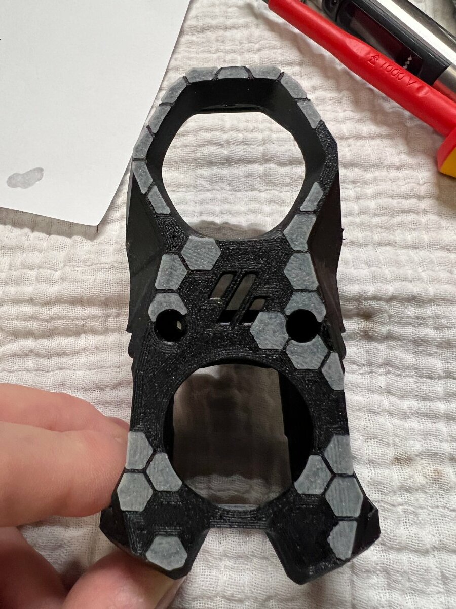

Did the "The Rush mini" also, but need to make it with 2 layers at least also, one layer isnt enough.
The pattern on top needs to be slightly smaller/slimmer also, I think...
Printed the black on white though some black ran into the white. Will have to figure out how to correct this. Plate was cleaned with alcohol as usual. Maybe time for some soap and hot water.
Or have a longer purge between color swaps
