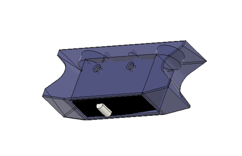

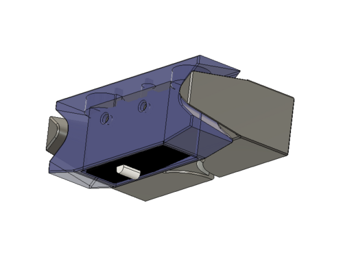

Around that temperature I found that the magnetic probe and the regular Micro-Switch probe aren't reliable anymore.
So, I switched to a SSG-5P Micro-Switch, which is heat-resistant up to 120°C.

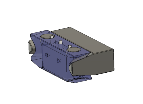

The magnetic probe is a bit wider than the regular probe. Therefore, you have to reprint the X-Carriage. As of now, I redesigned the X-Carriage for CW1 - not CW2.
Original probe made by Annex: https://github.com/Annex-Engineering/Quickdraw_Probe
