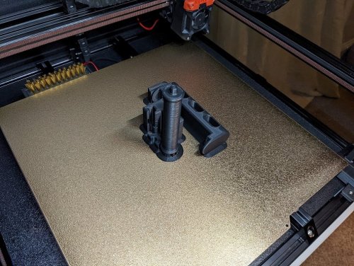

I really like this spool holder and had to make a Voron 2.4 adapter for it. I didn't want it to interfere with the glass panels, so it's been designed to avoid touching them at all.
BOM:
- Roller Holder Mount x1
- Roller Holder x1
- Roller x1
- Skateboard Bearing x2 (can be substituted with plastic bearings provided as stl files)
- 3x12mm SHCS x1
- 3mm T-nut
This has been a welcome addition to my printer.
- Supports: Yes
- Resolution: 0.2mm
- Infill: 40-50%
- Wall Thickness: 1.6mm
Here is a link to the original version of this spool holder:
https://www.thingiverse.com/thing:3020026
Update: 5/4/2022
Depending on where you mount the spool holder and how you are routing your filament, you may need an extended bowden tube guide. After some questions around this, I have included the STL file for the an extended version of the stock Voron 2.4 bowden tube guide incase you run into this issue.
