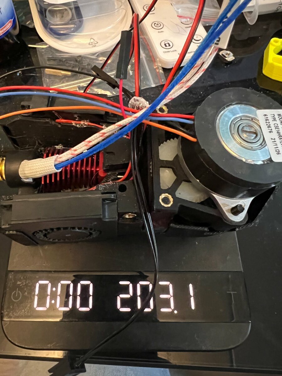

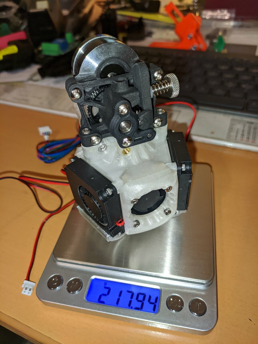

10 hours ago, Wick said:
@Buurman, with the sherpa mini installed? sherpa alone shows 124g here
Yes. But sherpa alone is 114 here. using aluminium bolts, mostly.
Now I have cut the wires from the motor, its 210 grams, still need some bolts and the mount to the cable duct on there...
photo is without the cable cover, that adds 7 grams.
