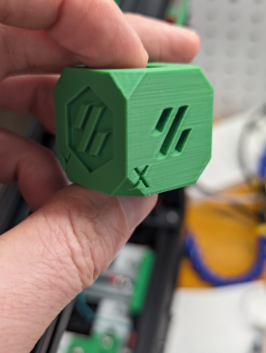

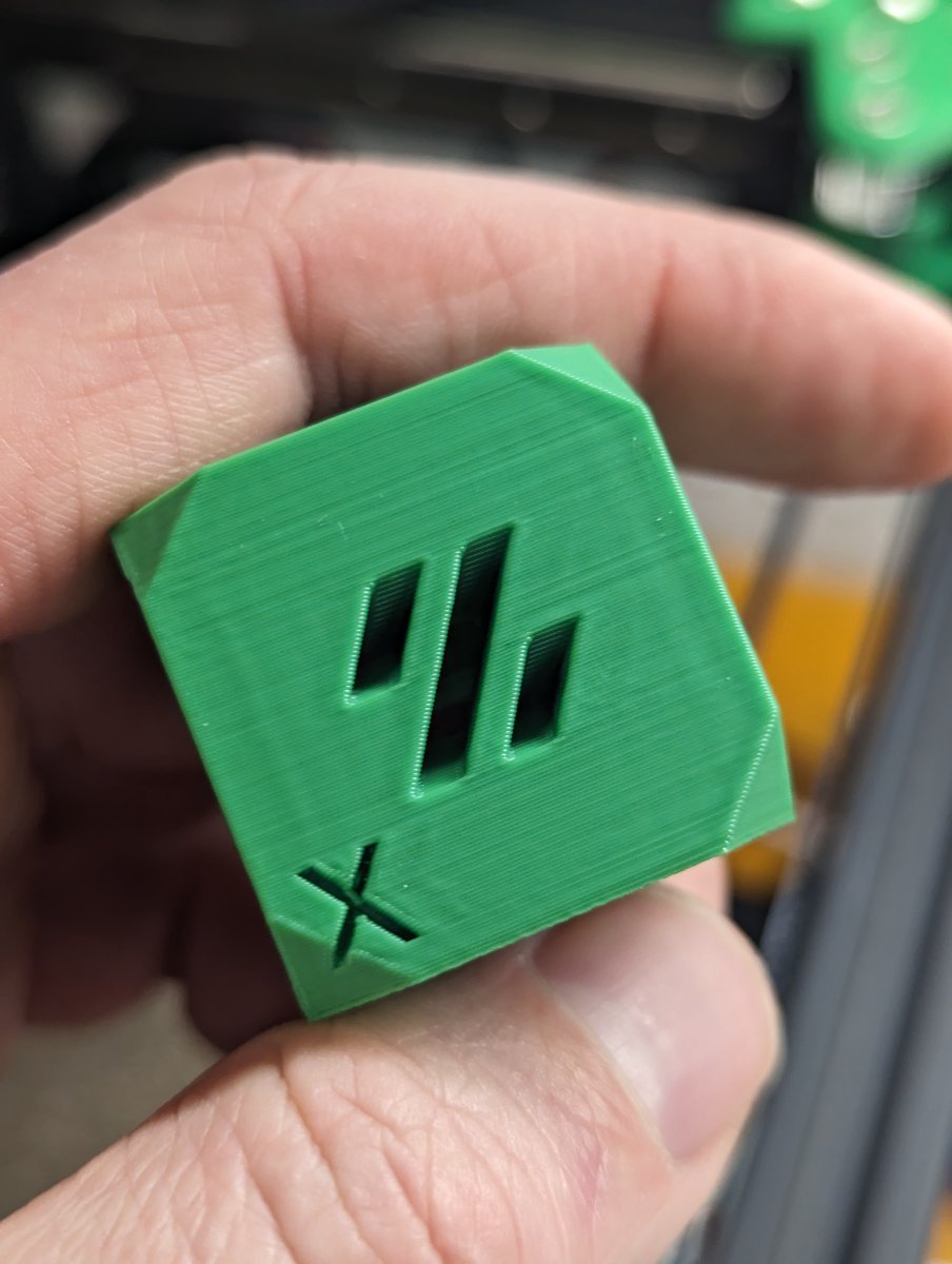

More tuning progress today! Following the Andrew Ellis guide
First layer squish, bed level, pressure advance, extruder 100mm calibration.
Still needs input shaper (will be swapping to beacon rev H), extrusion multiplier and filament that has been dried property and recently.
I'm blown away how good this is already printing and the holes have way less sag than in my other printers.
Dimensions are bang on too!

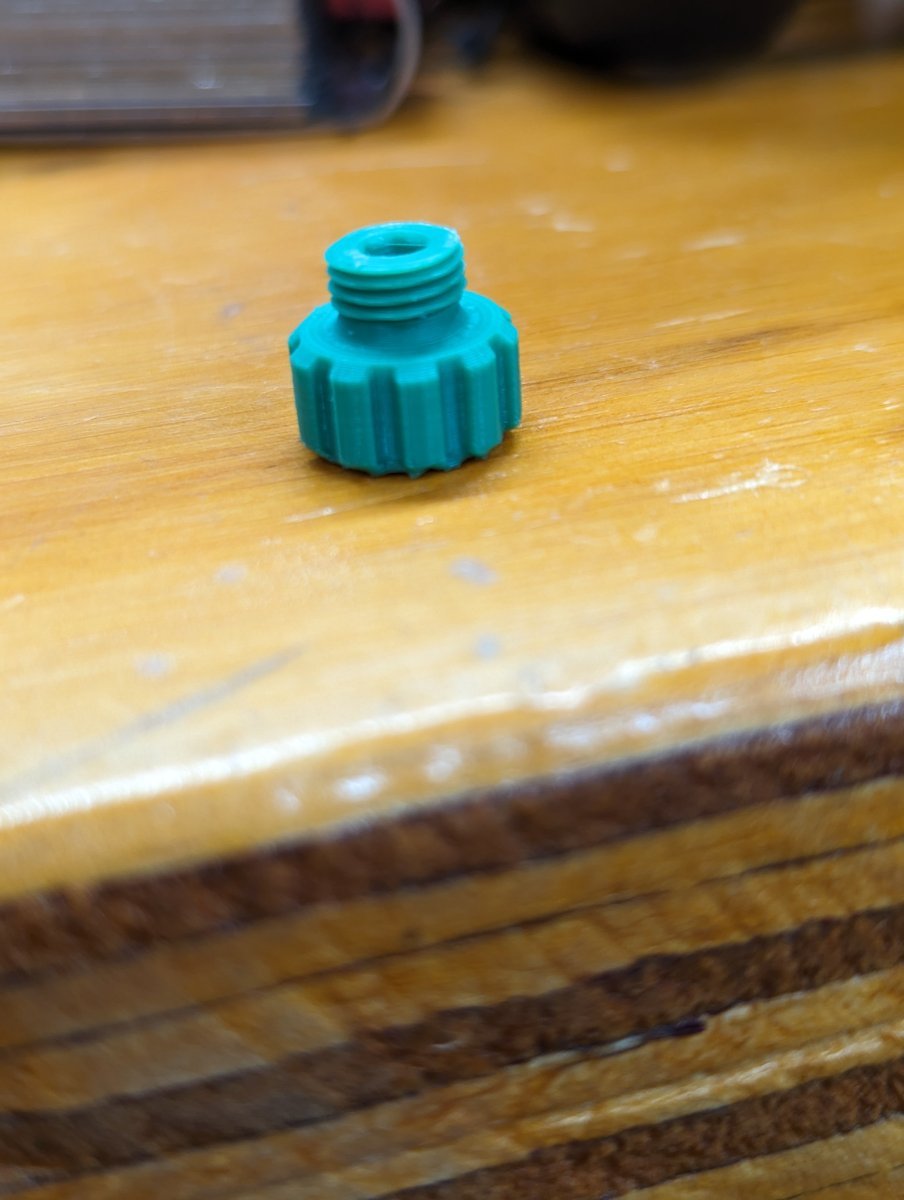

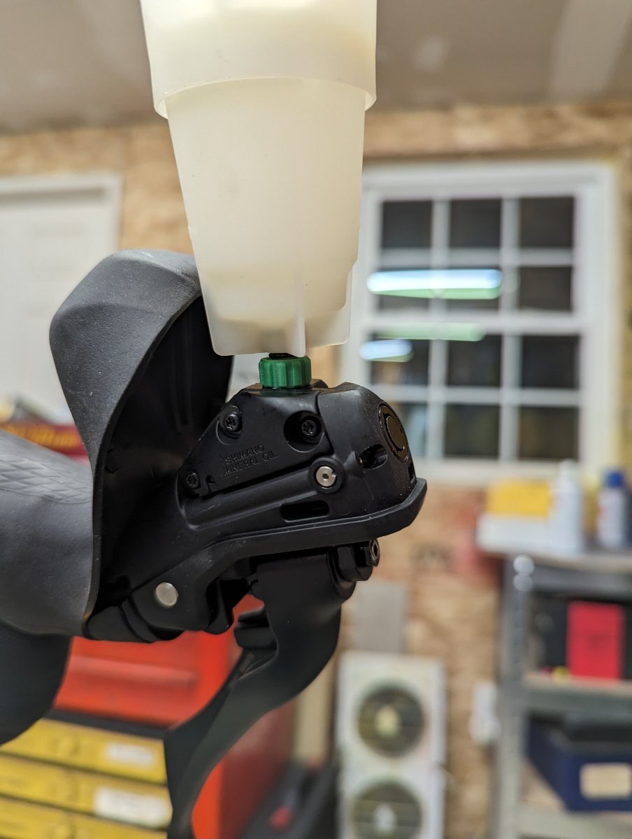

Ok so not a tuning post but a win for 3d printing today!
So here's the story. I bought a new gravel bike today.
I wanted to see if I could modify the left hand shifter to work with a dropper seat post....so I was pulling the internal covers off and needed to pull the lever all the way to the bar. I pulled the pads out and the lever went all the way.
Now these are Shimano hydraulic brakes and I'm used to working on SRAM. I didn't realize the pistons pop out really easy!!!! Sram's you need and air compressor to remove them.
Im planning on a big ride tomorrow and I pull out my bleed kit and what do you know I needed a thread adapter for the new brakes. My friend came over with his kit but he didn't have the right adapter either.
3d printing to the rescue. A quick Google search and someone had already modeled the M7x0.5 adapter. I printed it out at 0.1 layer height and the sucker threaded in beautifully! I can't say my other printers would have done that good of a job and setting up the lathe to single point that thread would have taken way more than 10 minutes.

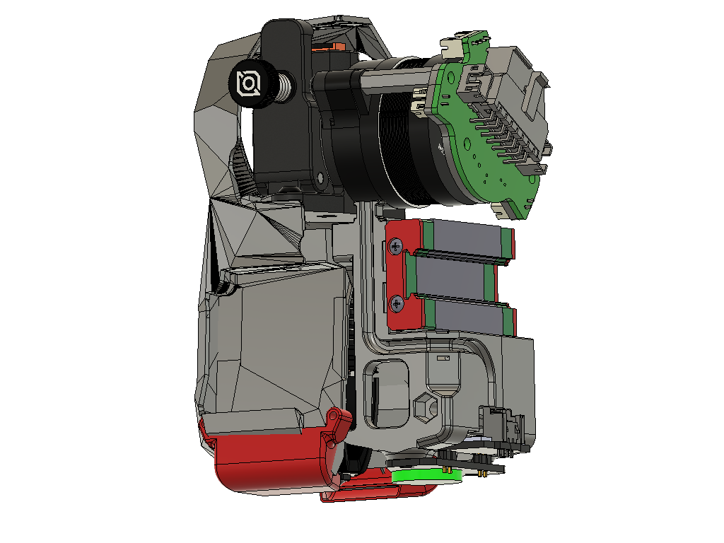

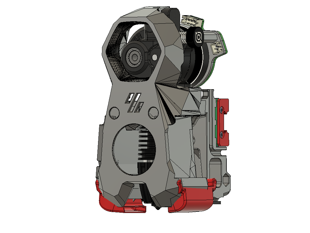

It's been a slow few weeks in the shop. I had updated the beacon sensors to Rev H with the Accelerometer. Which required reworking the tool head mount.image.thumb.png.a1802f3091e05a9db7bbb27d41657277.png
I was messing around with fusion the other day and got a very clean solid model conversion of mini stealth burner. I wanted to play with some bolt on fan ducts. We will see if I take it any further. But I did learn some good tricks for converting Mesh files to a workable model. I will have to make a video some time to down load all that from my head.
