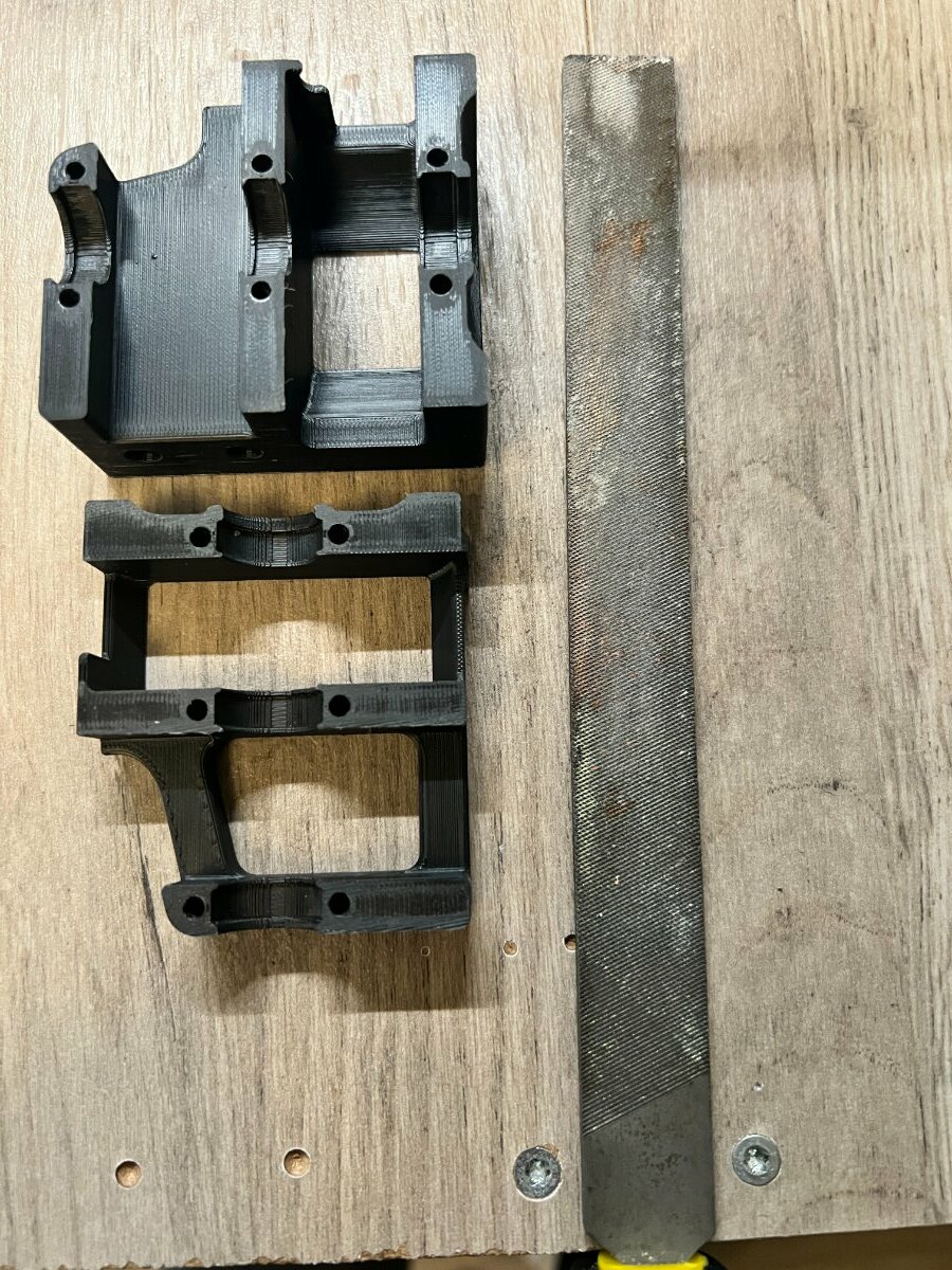

On 12/7/2022 at 2:38 PM, Buurman said:
Before putting these to parts together, I advise, run them SOFTLY over a file few times, 3/4 times, I like to lay down the file and run the part over in in the length, so you feel its flat.
This way your parts will go together much flatter, printing will always leave some higher points at the holes, etc, maybe I should be checked for obsessive behavior, is there a doctor in the house? 😛 @mvdveer
Warning : I'm most likely reinventing the wheel...
A trick I recently "discovered" after watching a wood working video : scrapping. Didn't know it existed ! Have a hand scrapper for cast iron, didn't know wood workers were scrapping ! Of course the wood scrapper is very different.
Not having one by hand, took a ruler (very straight and sharp edges), and used it with a negative cutting angle, the way we take butter with a knife, on top of a butter brick. With ABS, it's magic ! It will remove the ridges only, and there's very little chance it will remove much material after it reaches the main surface.
Works better and much quicker than files or glass + sand paper, and leaves a better surface finish. More over, some files are not flat, on purpose, in order to compensate for the metalworker movements, that tend to round the edges (many files are slightly convex).
First tested with the Z-drives, now doing it everytime a flat surface is needed, even if it's for cosmetics only.
